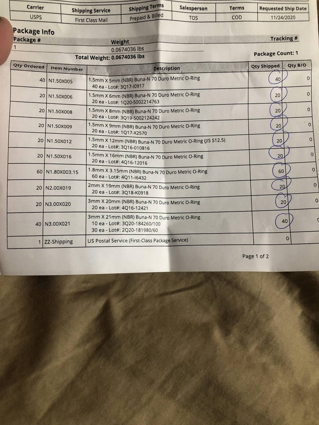

Say rash_powder, where did you order from? How did you get the correct sizes? On the EXP-PP750, not all the o-ring sizes are listed. I would order from Shaoxing, which is easy by ordering from the diagram illustration numbers...but the 42USD cost of Fedex'ing 50 grams worth of o-rings is just a bit much.
Best regards, Mark
 Bambuino-
below is the shipping list from the O-ring store. After considering the minimum quantity for the different part numbers, I think I ended up with enough for twenty rebuilds. That’s for normal people, for me that’s about 10 after all the screw ups. I think it was right about $40 after shipping. Some of the sizes were not available so I got the next closest based on some help from this forum. There’s a thread somewhere.
hope this helps!
