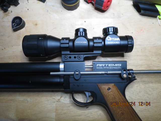

The price was affordable for an Optima 4x32 AO with illumination, 53$ I think (big river). With the included mounts, eye relief was the issue as we know. I wanted a compact scope. Ordered up a 3" BKL single piece mount, swapped that in yesterday. Eye relief is much improved. As well, could get rid of that shroud band dovetail, which I have come to distrust a bit.
So, is this scope as good as it seems to be? Seems sharp, and holds zero, what am I missing? Pretty much everything I point it at is dead in as much time as it takes to pull the trigger. What gives?
This PP750 is pretty accurate, WHEN IT WANTS TO BE. And that is the suspected rub, knowing that I have a decent scope, and previously a good red dot. I get random, 2 inch @ 25yd, POI shifts out of the gun.
I am thinking I am pranging the shroud somehow in spite of being extra careful. I do know that removing and replacing the same suppressor definitely causes loss of zero with this gun.
Anyone else suffering similar "random" POI shifts with the PP750?
Mark

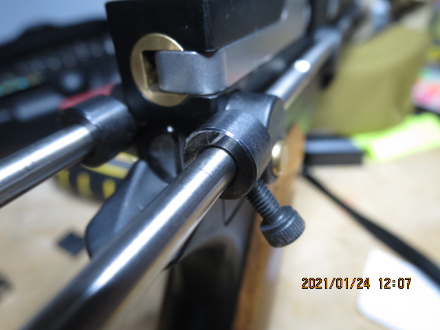

Included photo of poor man's wire stock locks-- M6 shaft collars from hardware store (Hillman's, ~3$/ea).

Having mounted the single-piece BKL rings other day, this is the first morning that I have not had my dreaded POI shift. First round hit the spoon at 25 yds. So, yeah, thinking the two-piece rings and the shroud band dovetail could have been the issue. Shall see over the next few days.
