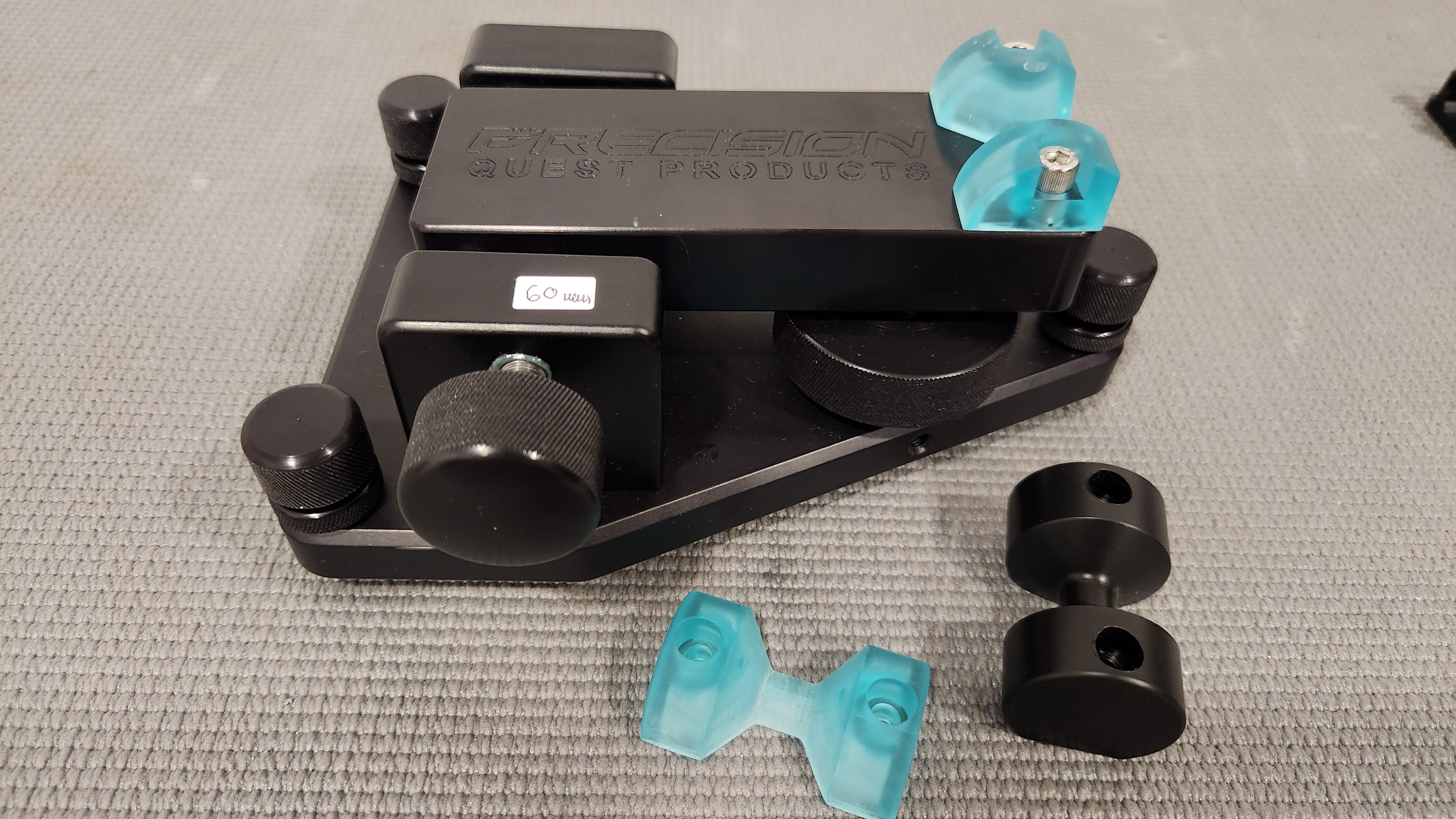

Anybody have a PQP rear rest? I'm looking for the minimum and maximum height from bench to the bottom of dog bone. Also the width of the bottom of the dog bone. Version 2.0
I appreciate the info. I have one on the way, going to use it with a Sinclar bipod. Hope it works out.Measures 3.5" min table to bottom of dog bone rest, 0.5" travel for 4" max in the all the way up position. Of course you also have the three screws to adjust leveling which could also be used to increase the height above the bench.
By the way, I have been shooting with mine for the last couple of month and love it. Easy to cover the entire N50 target and move between bulls.
