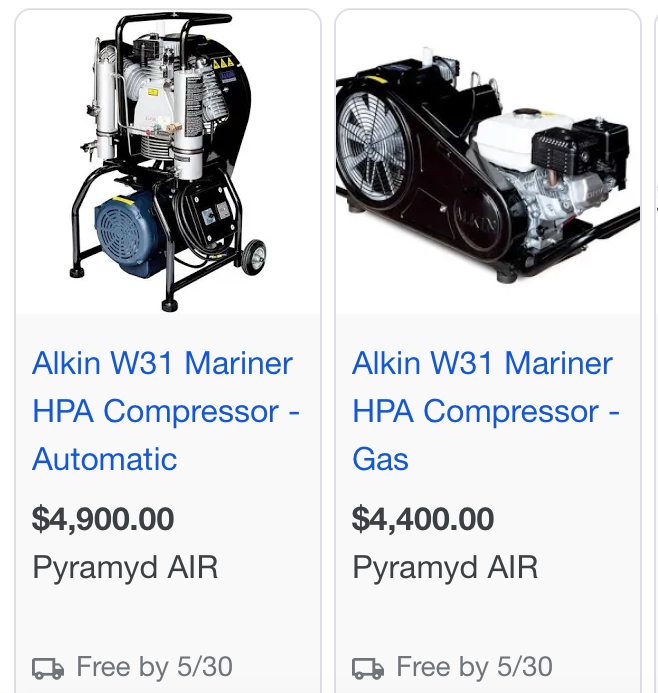

Is there anything out there like the original Shoebox? Mine has been trouble free other than a couple routine rebuilds over the course of something like 15 years. Where it is electric powered it only needs a tiny/quiet compressor and an occasional dab of white lithium grease on the pistons. I am worried that mine will die at some point as parts are drying up. the Altaros while nice is air powered and requires a lot more first stage air IE a large compressor. I read about nothing but failures from what’s available today. Is anything worth buying?
Here ya go.

As Scott said, no, there is nothing like it. I sometimes wish that somebody would replicate it out of China - then at least the costs would be low enough that it could compete against all the junk out there, and it would still be more robust as it was well designed from a load standpoint (along with everything else).
The dive compressors like the Alkin are great, but they are so over designed for what most of us need. They are made to run almost continuously from a duty standpoint for the dive industry, so ~200 hours in a month does occur with no issues - most of us would use them well under an hour a month for our typical air needs.
