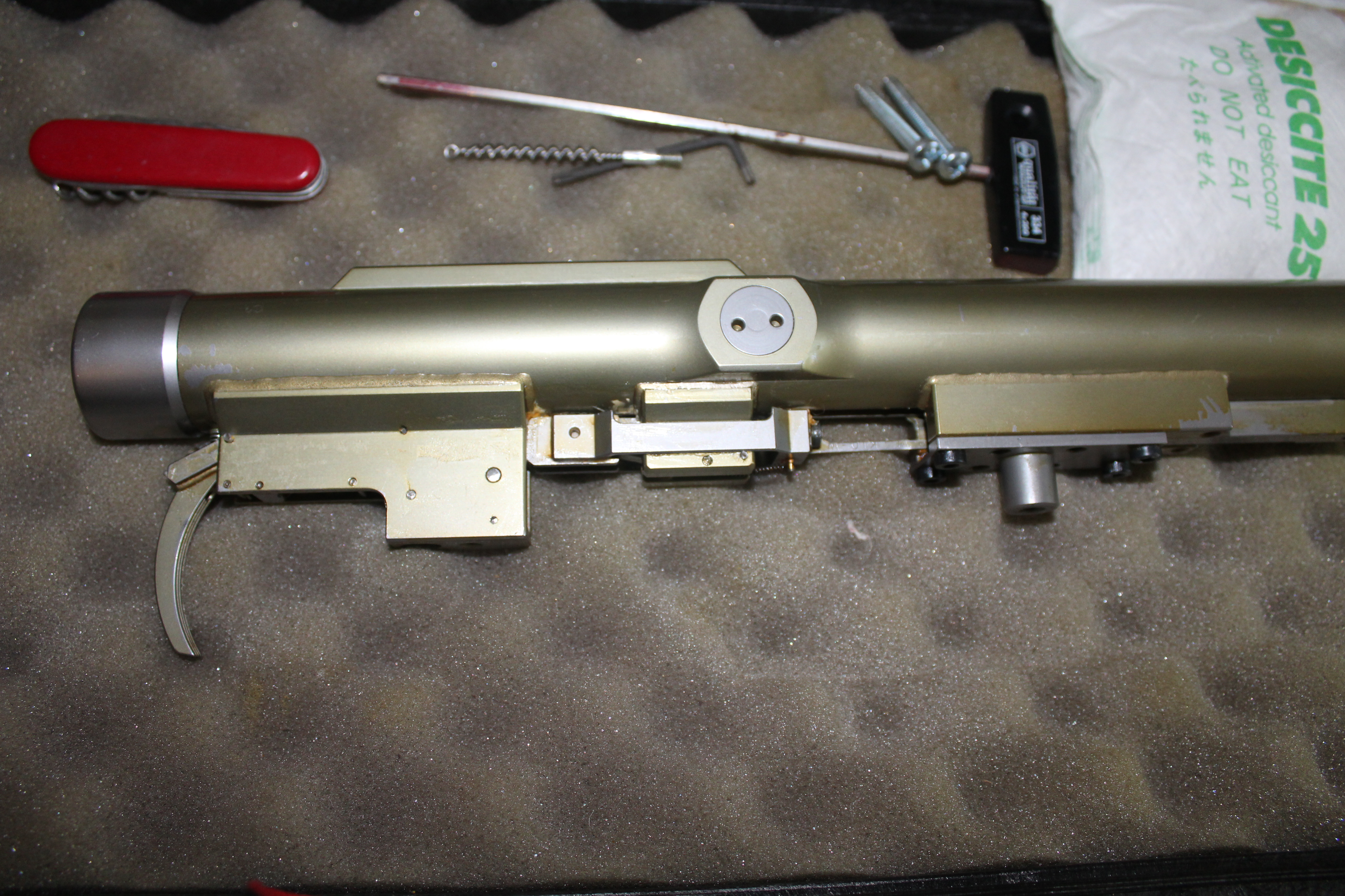

Hi. I own an air rifle that was built by someone that was in the US from Germany. He was unable to take it back to Germany. I'm not finding anything on the components to tell me who made any of it. I'm sure he didn't make all the parts himself though I think he made some. It seems to be a 22 cal. It fires 22 cal pellets. I don't know how well yet. Can anyone identify anything on this gun?

Well that's just absolutely TOO cool! Looks to be the work of an individual master machinist, certainly not any sort of commercial model that I've ever seen.

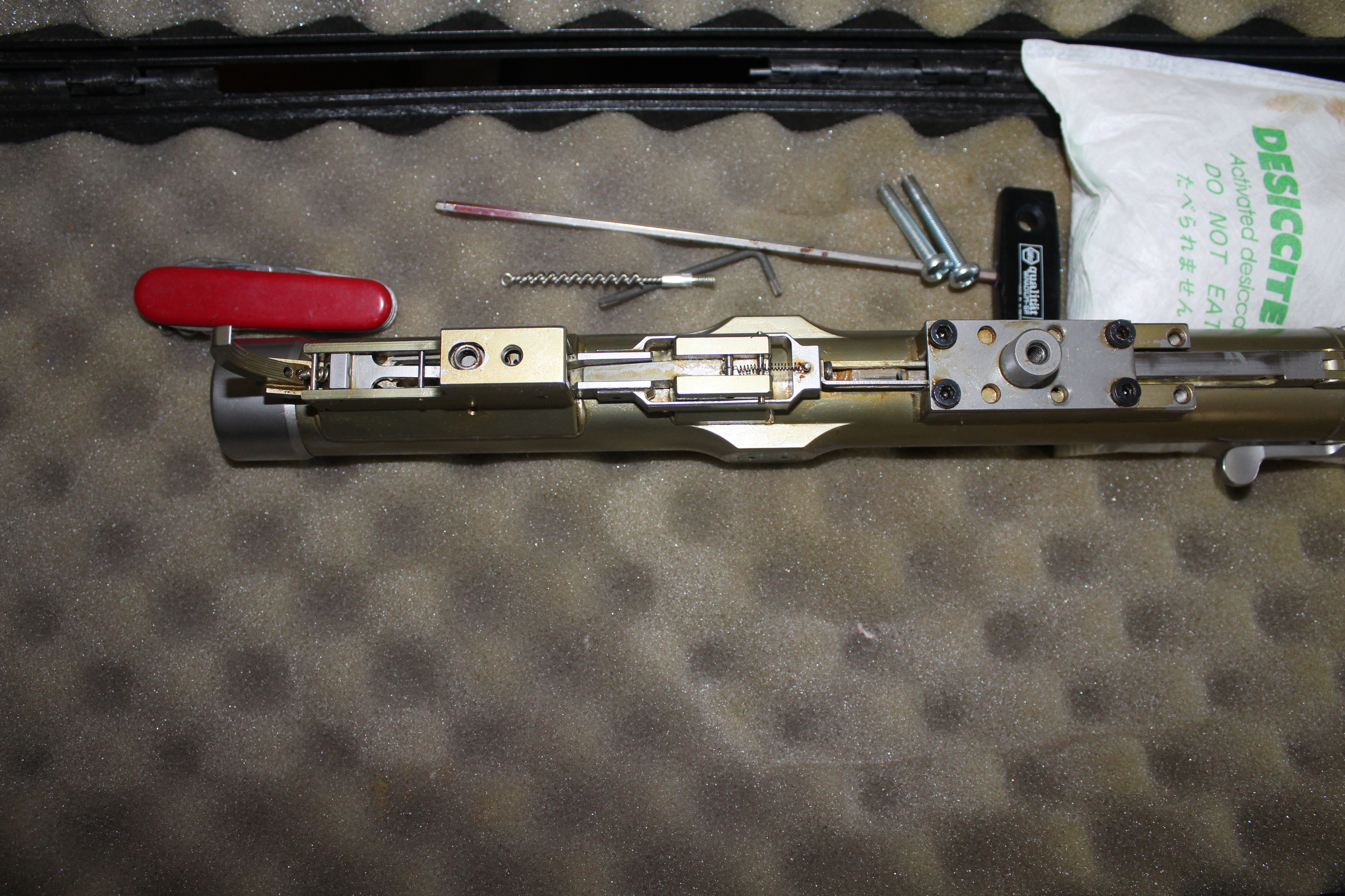

That's known as a "tap loading" system (perfected by Lincoln Jefferies and BSA around 1900, and used on many top-of-the-line European springer rifles for 80+ years). I think you're probably right about the Giss recoilless double pistons, and the bits in front of the trigger block may be a trigger-block safety system. The pale gold finish look like some sort of phosphating, or powder coating.
Put this in production and I'll buy one in a New York minute, LOL...It's like all my fave old rifles merged into one! Could you please post some more overall photos of it In the stock?

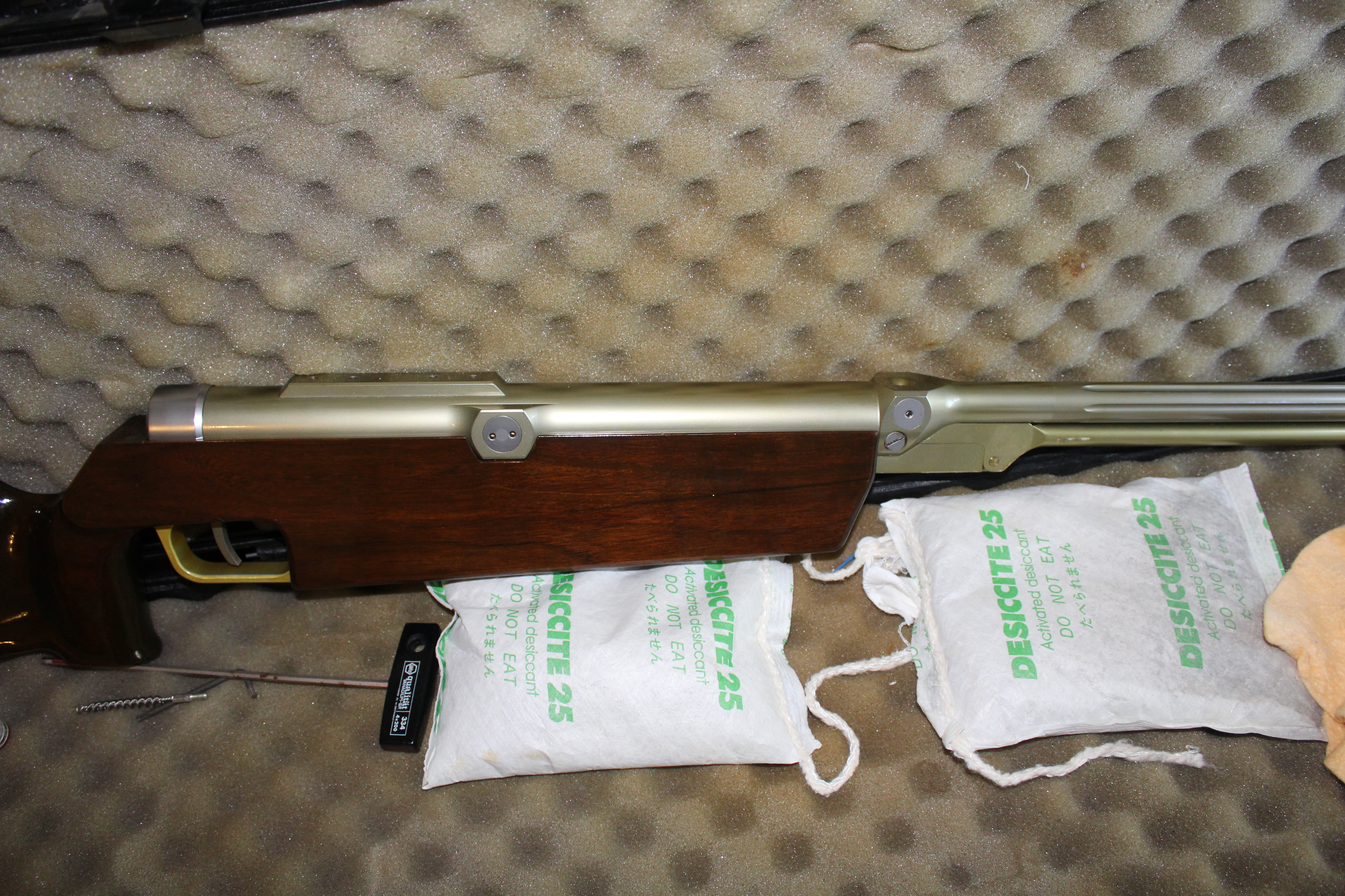

What a piece of perfection. Attention to detail is off the charts. Certainly looks totally custom by a master. Probably satin nickel plating I would imagine.

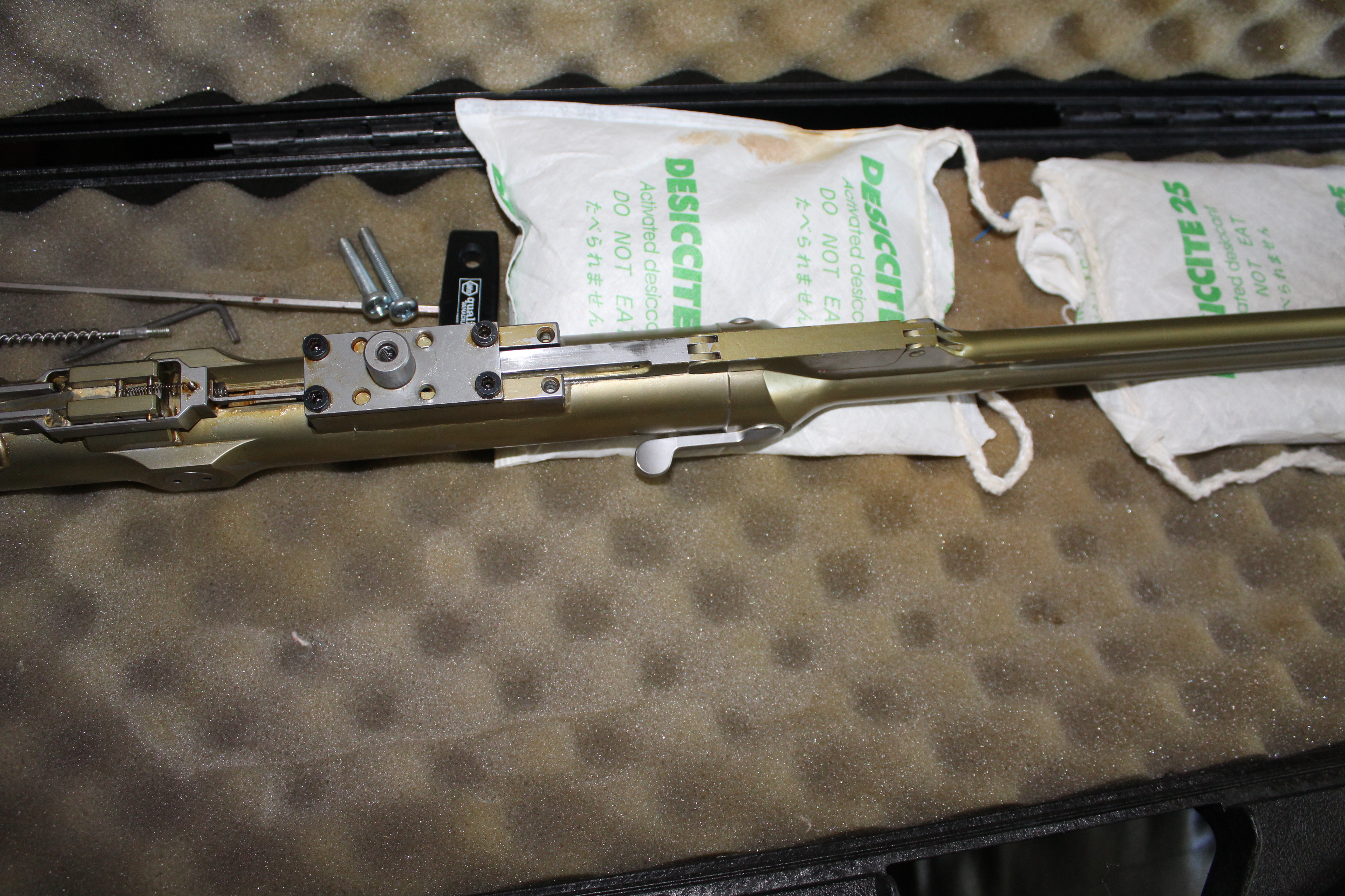

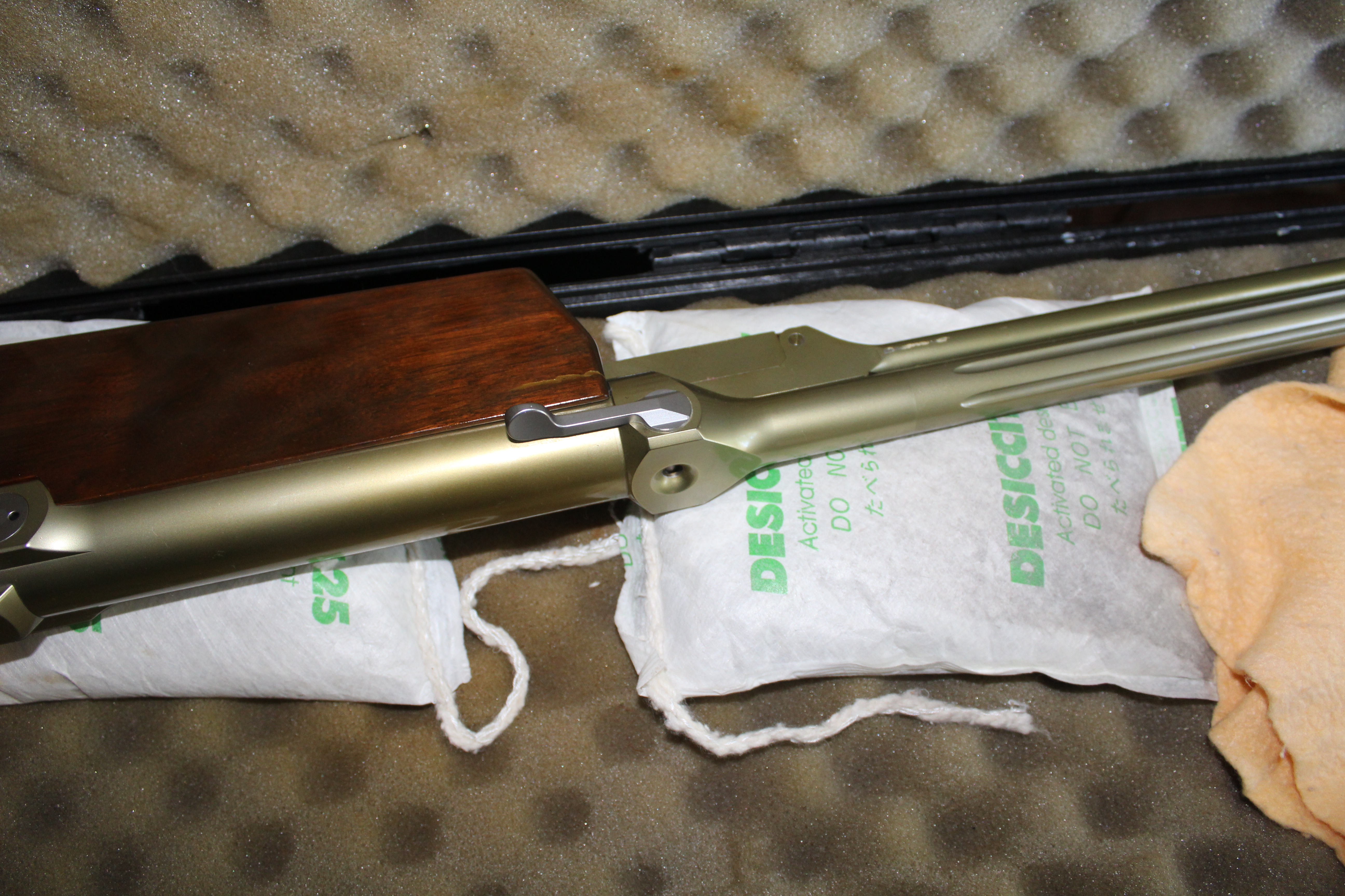

A lot of machining in that rifle. Is it made of stainless? It looks like a professional homemade semi target rifle. Does the flat machining surfaces mate with the stock? Is the stock bedded? The cocking lever assembly looks robust.
This is one of those cases where I'm afraid to do anything to it to find out. It could be stainless. However, he has the descent bags in there. The gun fits into the stock like a glove on a hand. It didn't come with the two stainless screws seen in the picture. I went to a local hardware store and bought them.
The cocking is not easy. It has a strong spring and I was sure to add a light gun grease to the shiny parts to minimize a problem.

Very interesting rifle! It almost looks like it could be a dual piston system like the Diana Giss guns, as there's a mechanism on each side of the compression tube. Have you tried shooting it? If that's a one-off handmade gun, the guy is a highly skilled craftsman. Is the compression tube steel?

Yes, it looks like an Airsporter tap loader.
But the comparison is like an old Opel Record to a Mercedes-Maybach

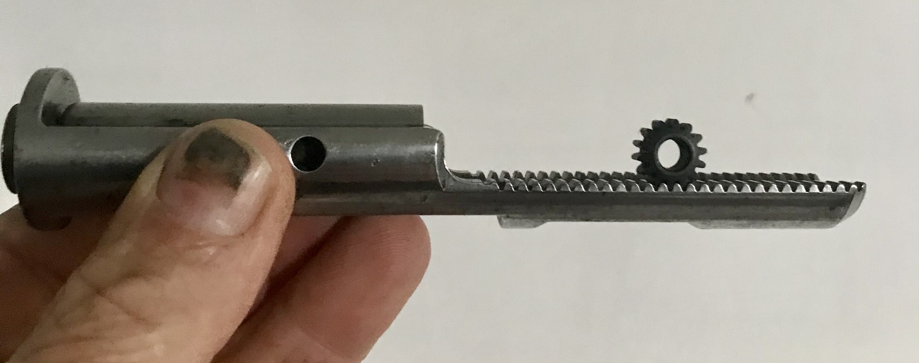

It’s a really interesting airgun. It must be a giss design. The pellet only being driven by the front piston. If you look at the position of the central gear of the giss pistons is the front section of the compression tube longer or is that my imagination?
I’m guessing it makes more power than the Diana match rifles which might be why he couldn’t take it back to Germany?
You would presume the point of copying the giss system and not just purchasing a Diana is to produce more power?
I wonder if he made his own pistons, gearing ect or used Diana parts in there. If he made the lot that is pretty amazing.
