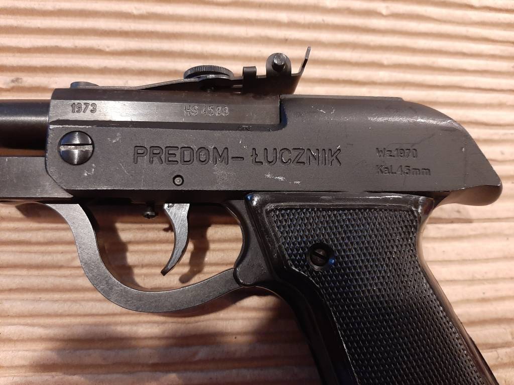

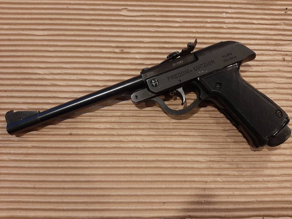

I recently purchased a Predom Lucznik 70 from AoA. It's in great shape externally and AoA is great to deal with. I've been following Stevoo's recent comments on improving the performance of the Walther LP 53 and couldn't resist the "lesser" copy when one became available.

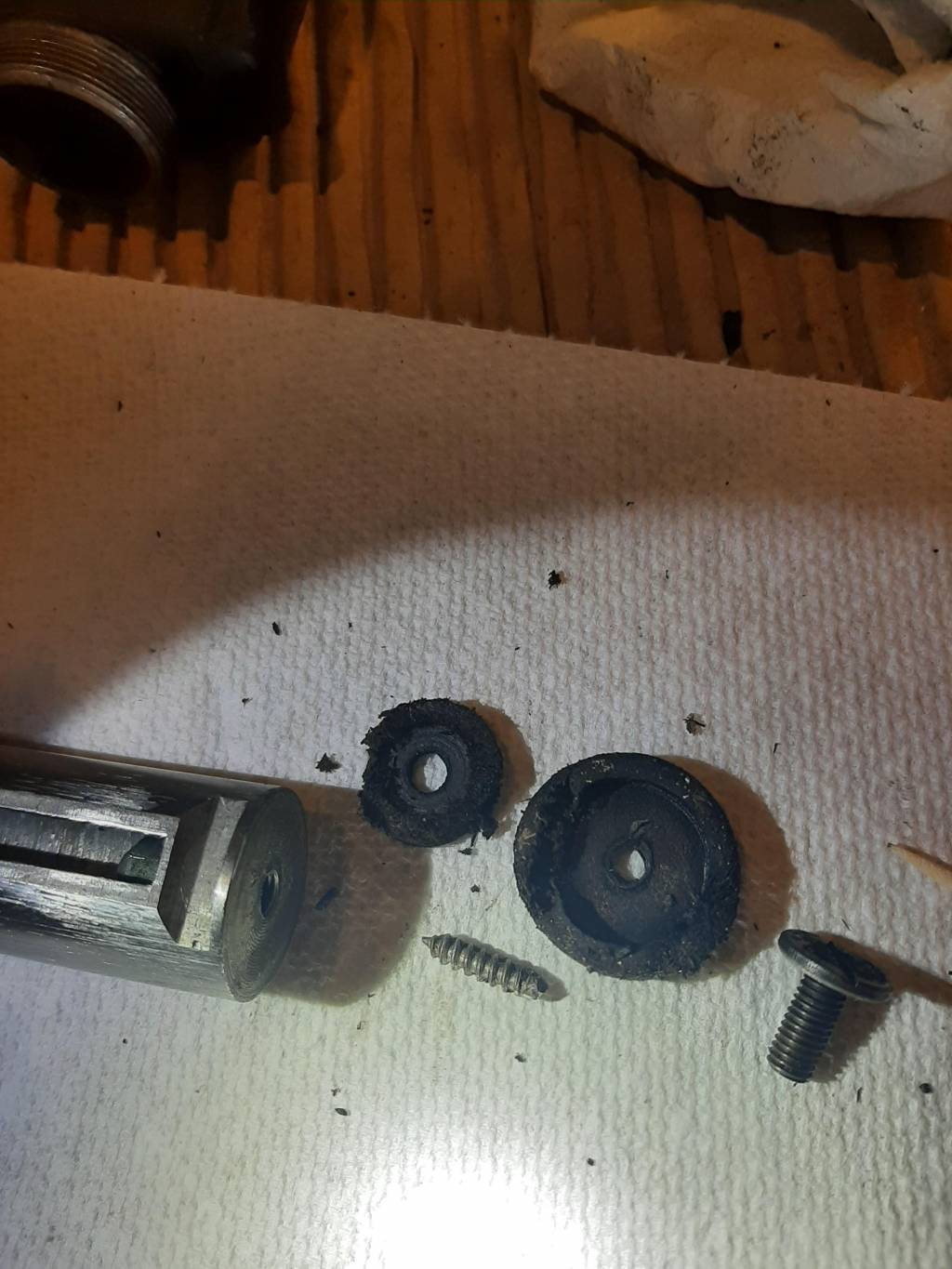

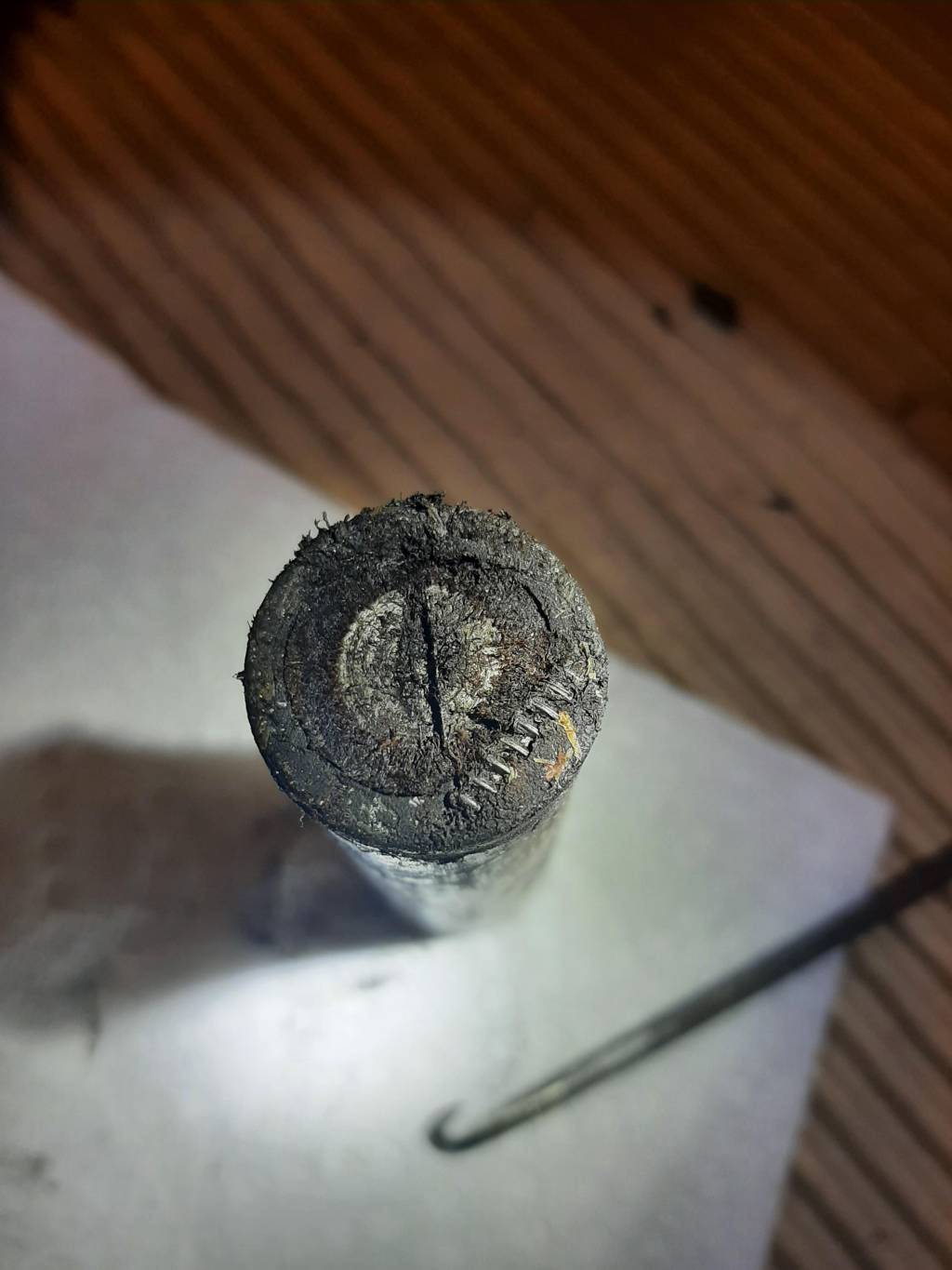

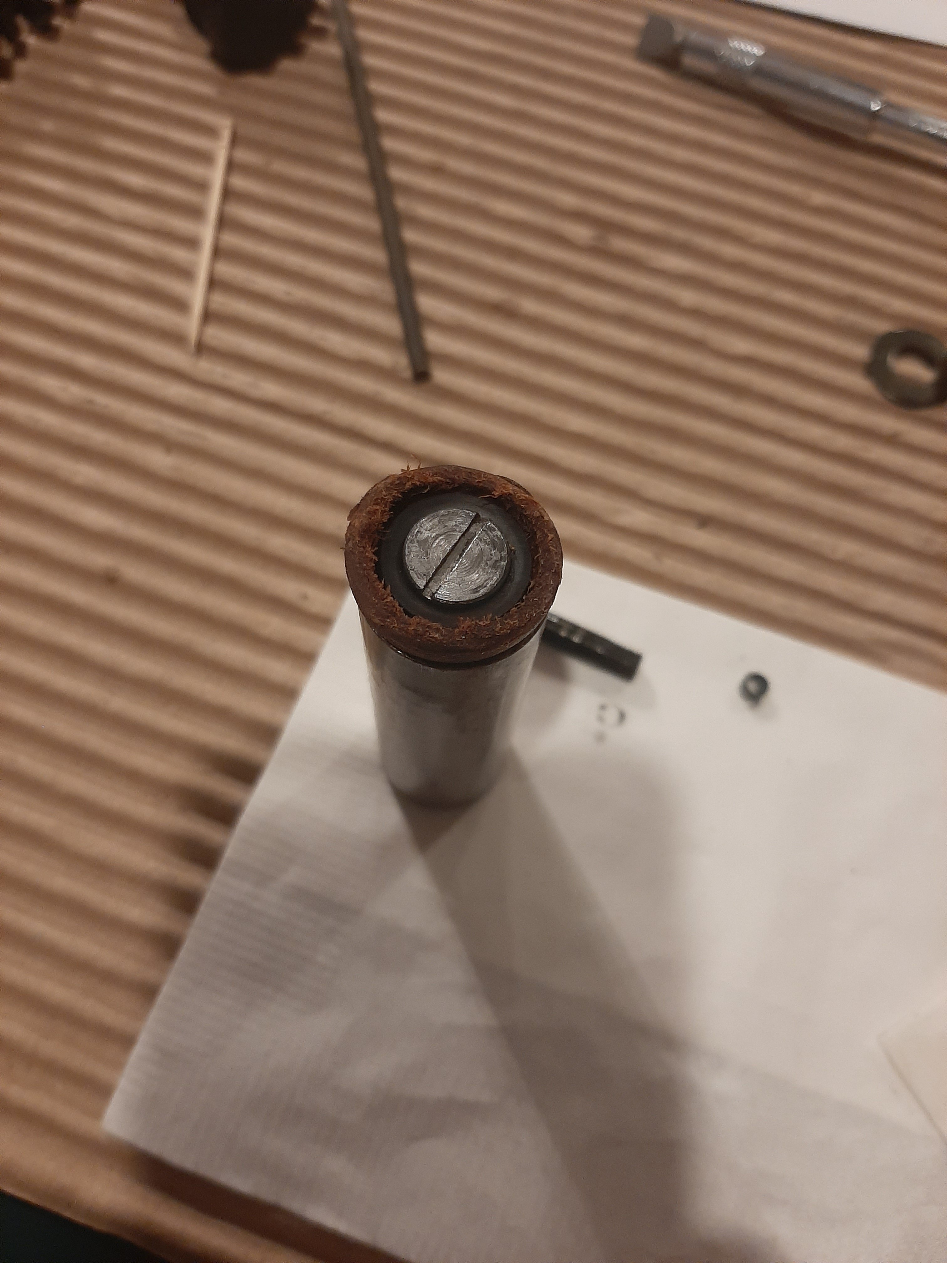

There is very little wear and no rust to speak of and it shot ok - I guess, as this is my first springer. Upon disassembly, I found a partial wood screw imbedded in the leather piston along with a slight score in the cylinder. Aside from the screw and glitter of the aluminum cylinder, the leather is in good enough shape to reuse, but there's no way to remove all of the shmutz from it. The only consolation of that discovery is that I found two other forums/blogs (one of them Polish) that described the same thing!

The stud smashed into the end of the piston was typical with these. A big surplus of second hand guns was sold into this country at an incredibly cheap price about 20 years ago. I rebuilt a good number, all with studs or bits of nails down inside the piston. Rumour had it that it was a job lot sold off cheap by the Polish military, once used as a training arm that they eventually got rid of. Perhaps soldiers running out of pellets and shooting any projectile they could get their hands on, but if too small had fallen back through the TP. I even found one barrel filled up with mud that must have been shooting mud pellets. You will need to inspect the bottom of the piston chamber to see what damage the stud may have done to the TP area.
Steveoo, the piston chamber doesn't have too much damage, but you can see where the screw hit the bottom a couple of time before settling into the leather.

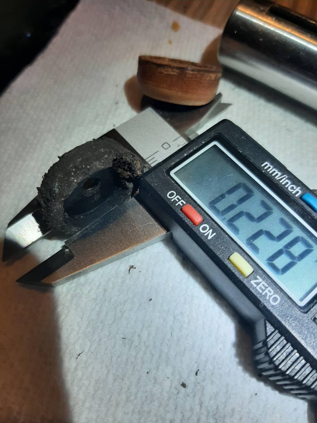

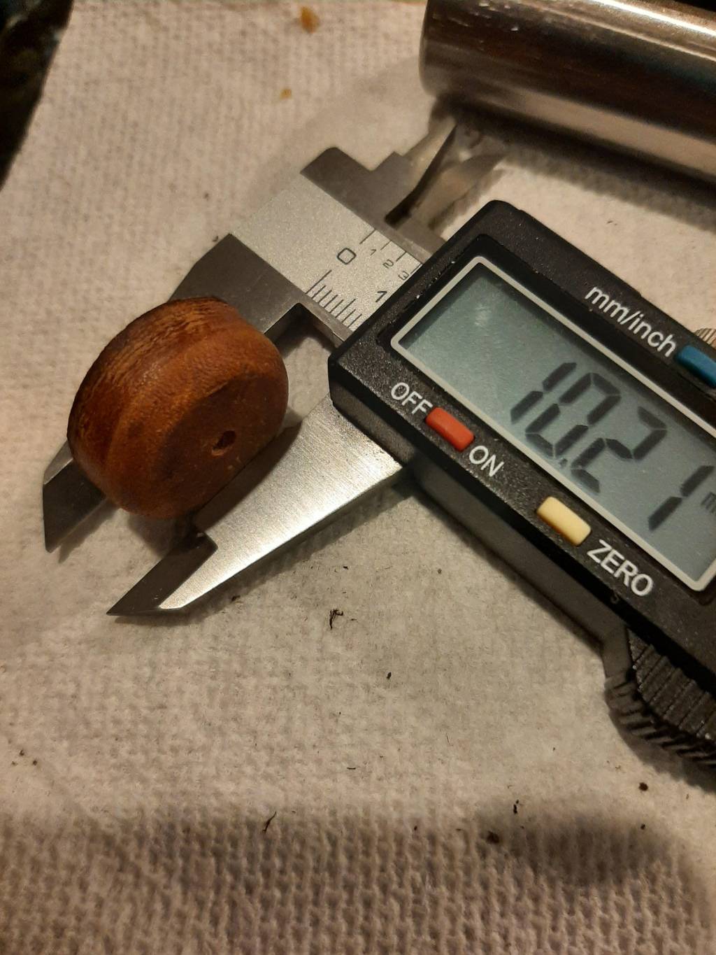

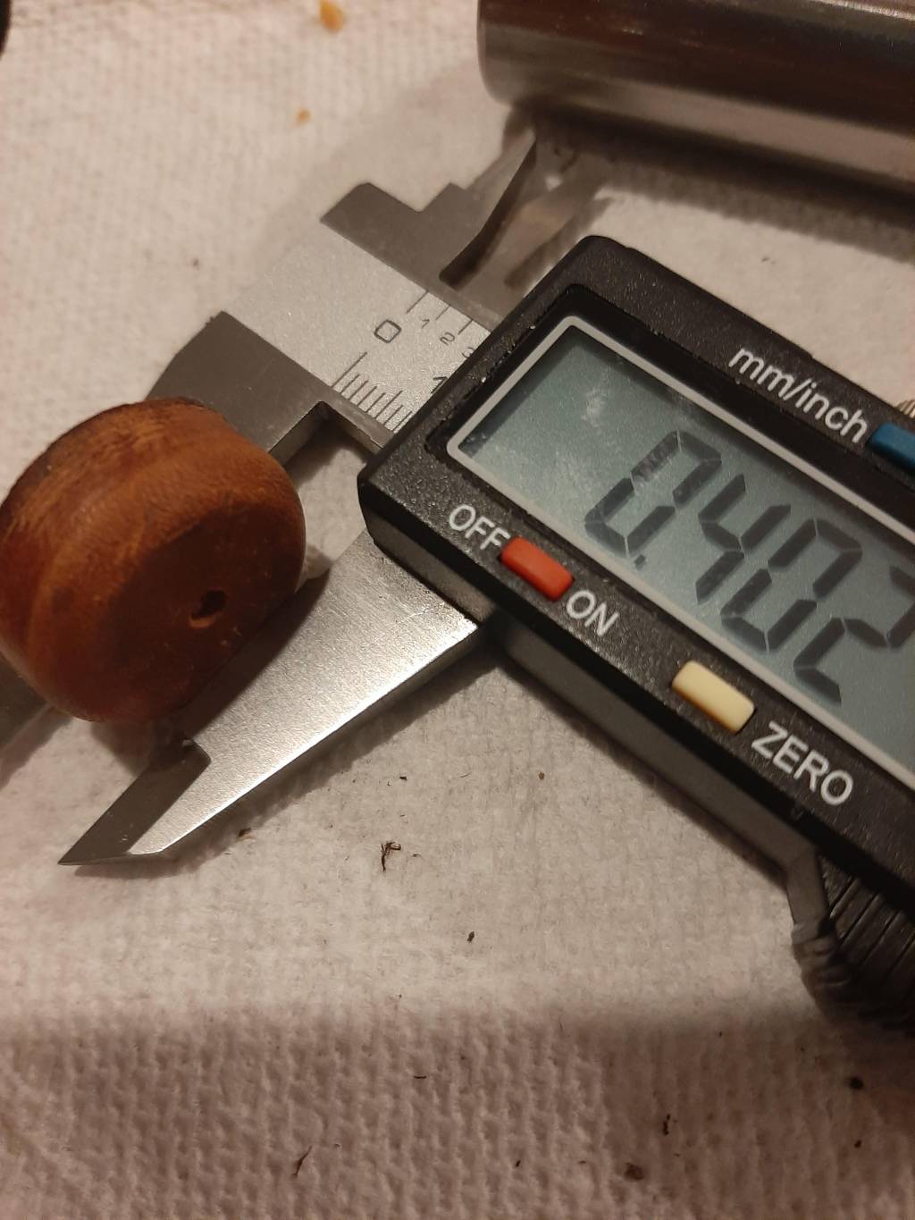

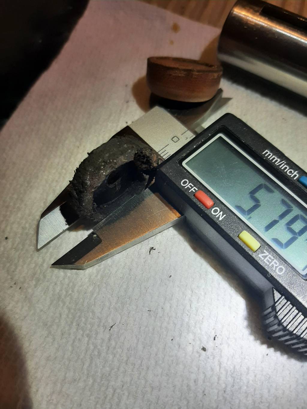

Some repair parts arrived this weekend. Here's the old piston & a replacement from JG.
The OD measurements are essentially identical. My first challenge is to trim the piston to near the original height, then find an appropriate flat washer.

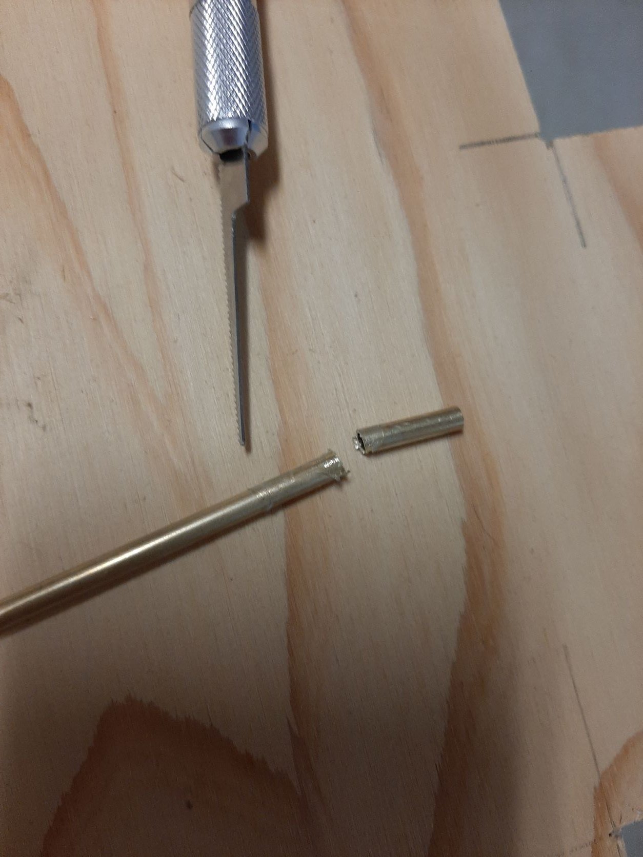

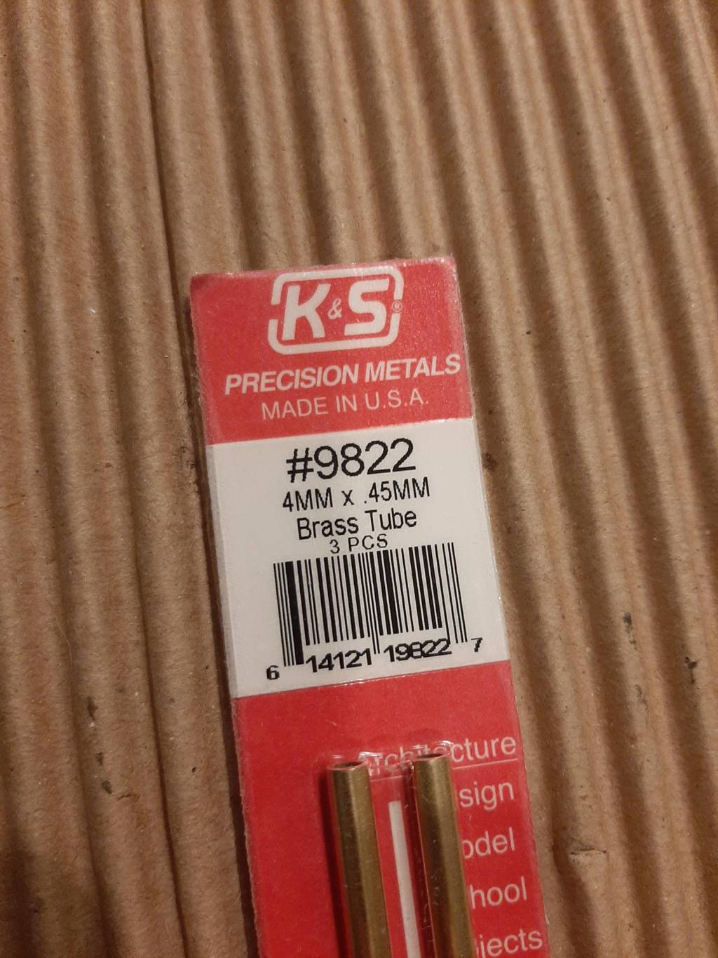

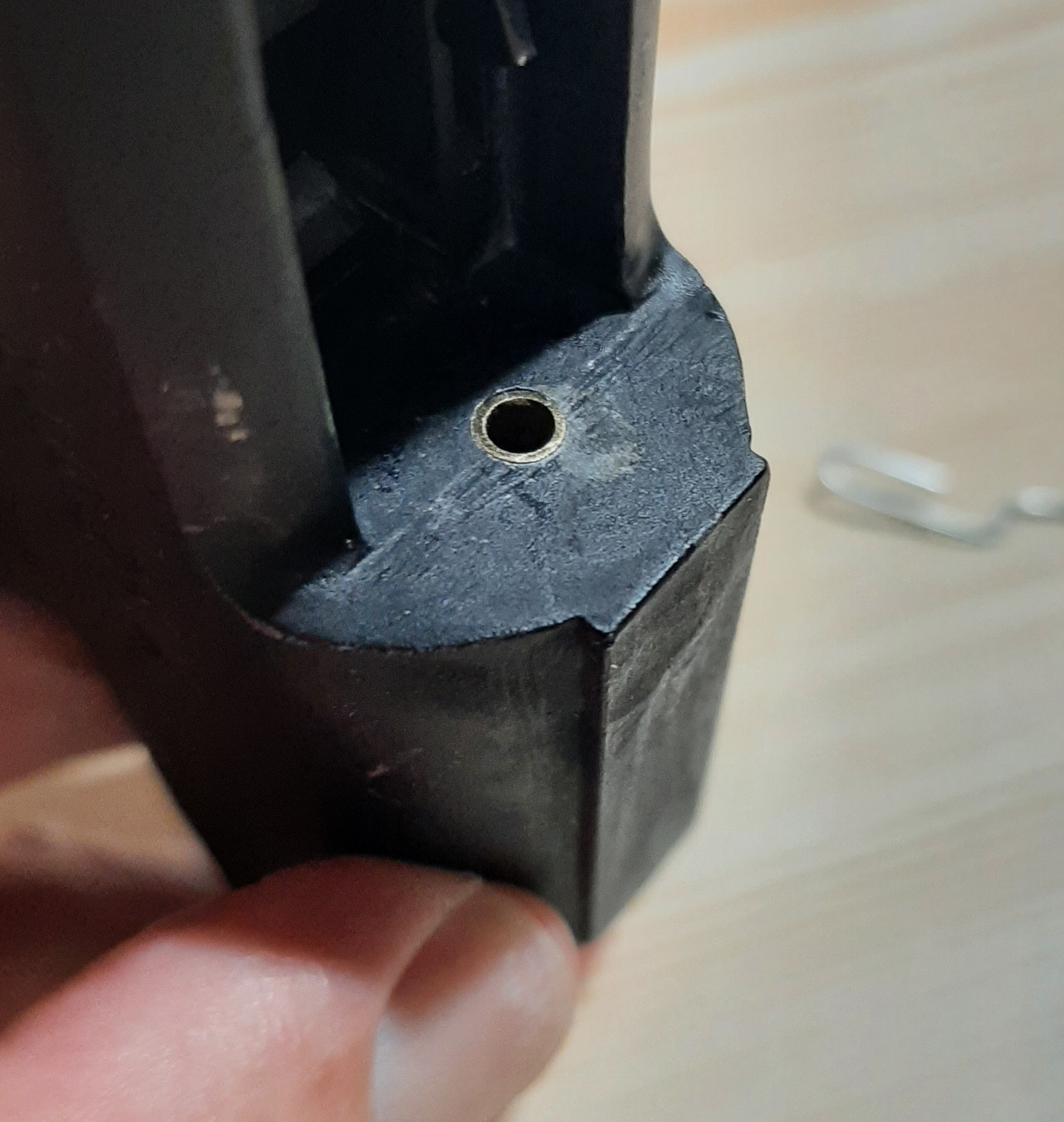

Next up is the brass tube for the TP reduction.

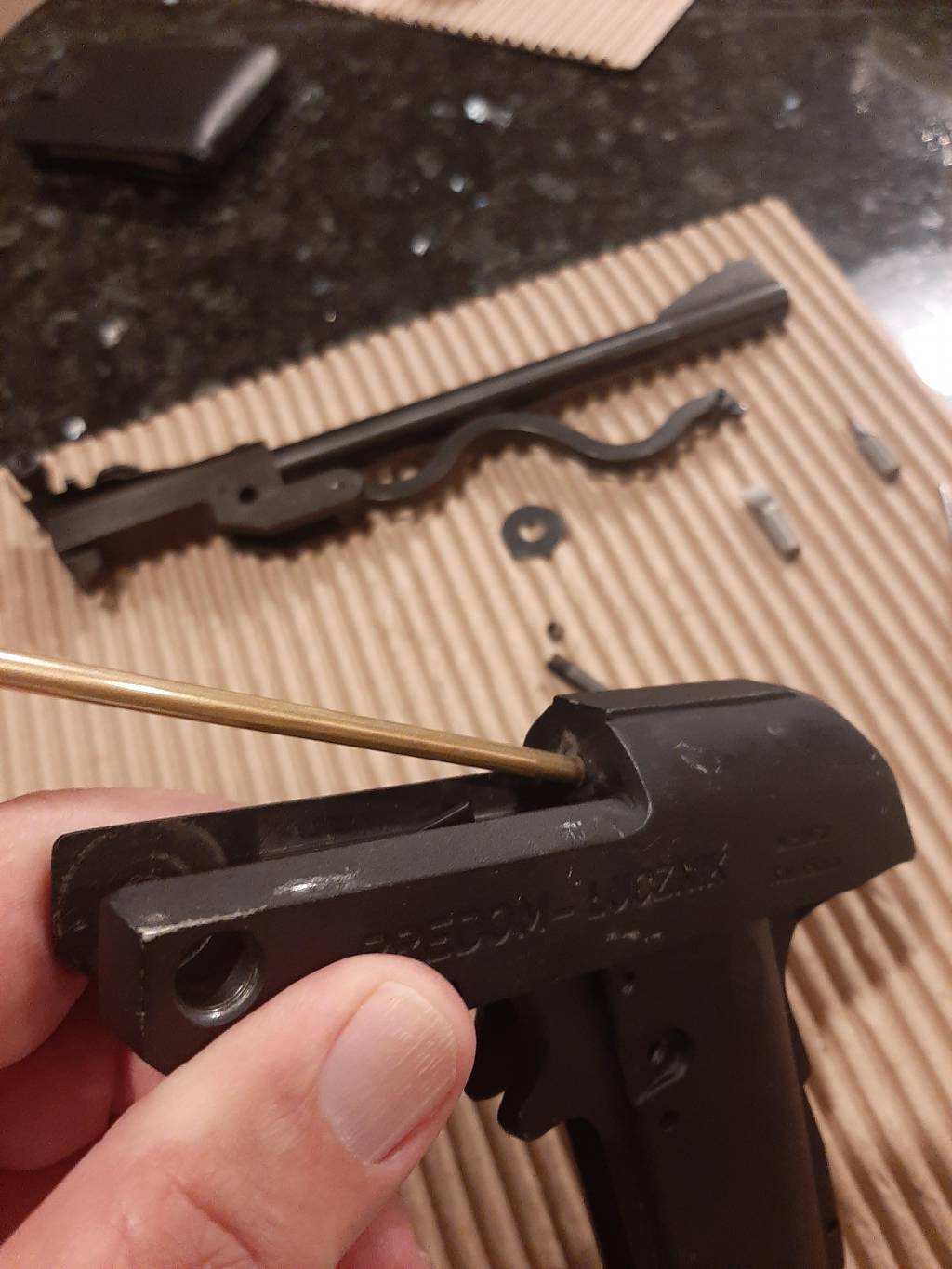

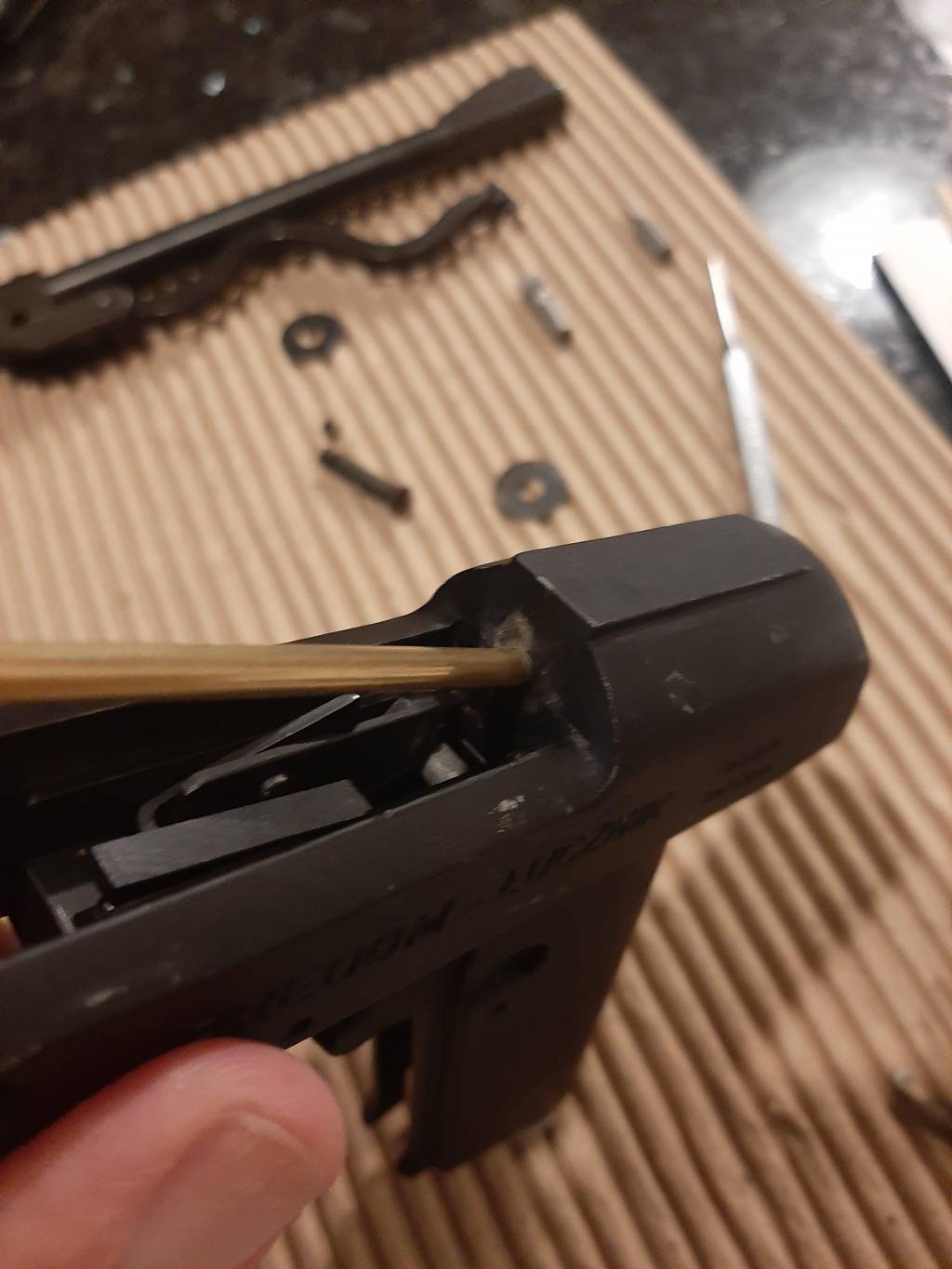

Prior to test fitting the tube I manually ran a 5/32" drill bit in the transfer port removing quiet a bit of trash. I think the 4 mm tp was cast in the frame as the drill did not quite enter the cylinder, though with enough force the drill could open it up. I'm relieved that the drill & tube was stopped by the casting as my fear is that I haven't figured a way to prevent the brass tube from falling in the cylinder just like the wood screw parts I discovered when I removed the piston.

You can glue in a 4mm tube with 638 Red loctite. Im 1000s of rounds in with no hint of any movement.

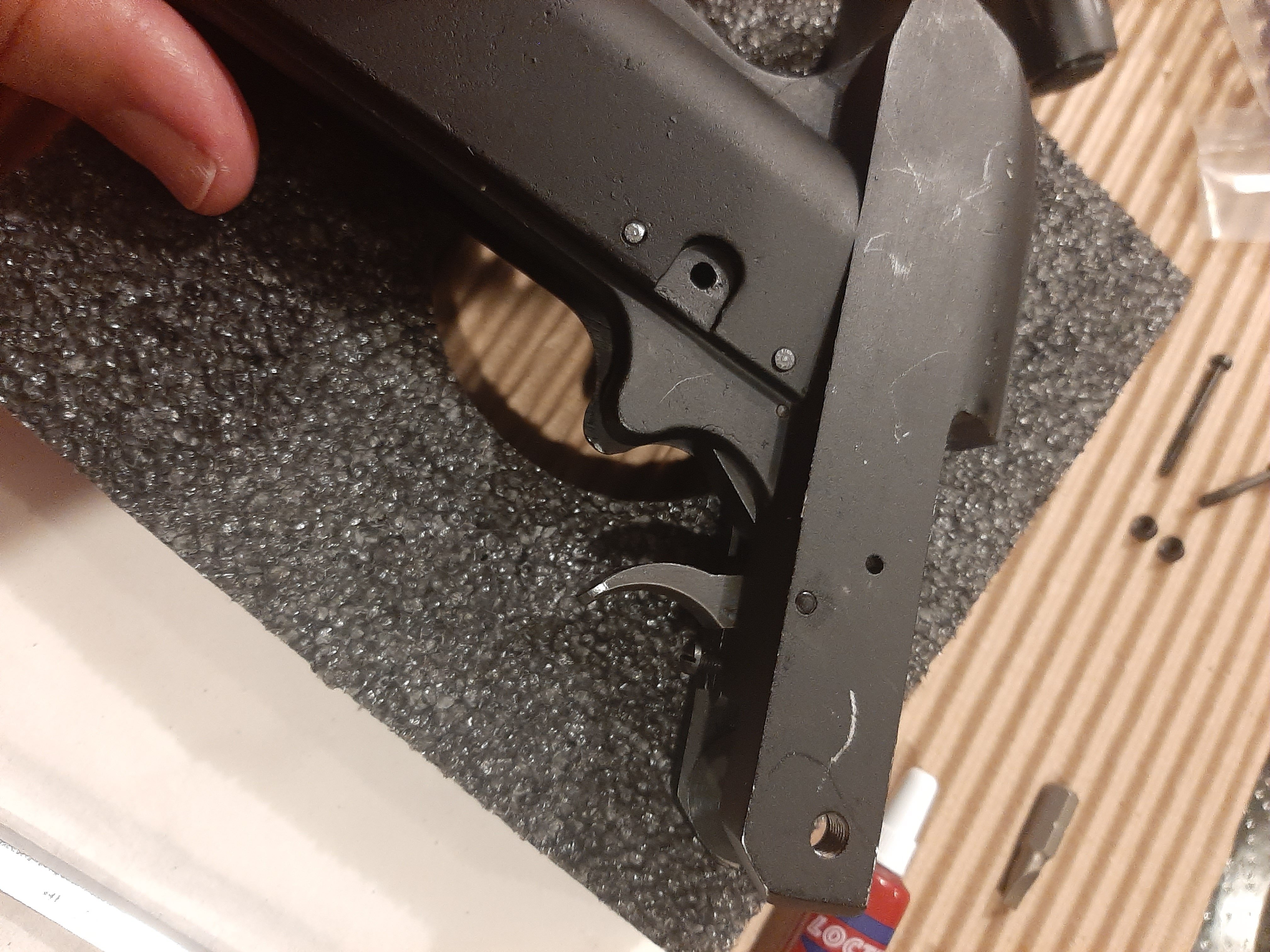

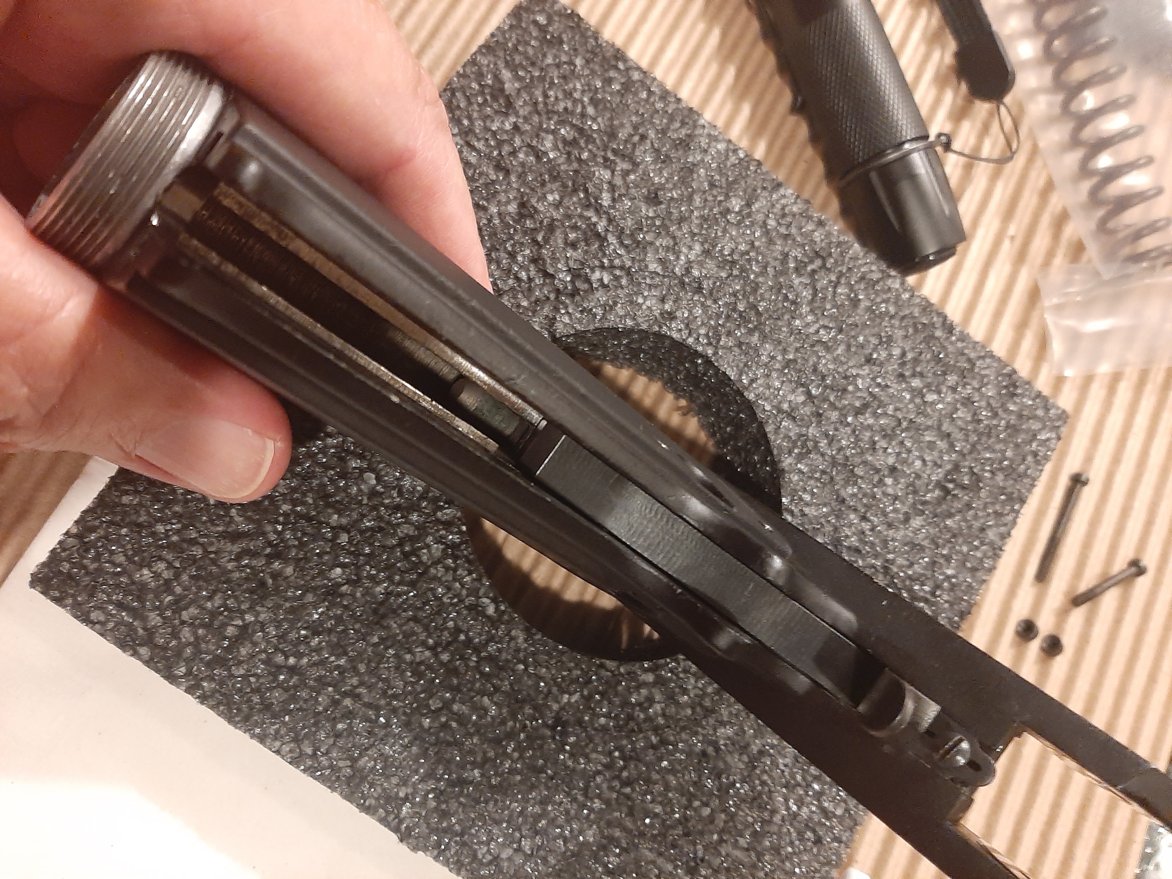

The pawl requires the piston to be at about the middle of its stroke position … .As it will not seat down low enough unless the stirrup is sat on the machined flat of the slot …
Next you need to apply pressure on it with your thumb (at the trigger guard area) until u can align the pin.
Tips…
Polish the dowel pin down until its a an easy slide fit into the hole. You dont want to be having to drive the pin in with a hammer, while trying to align the pawl.…you dont have 3 hands!
The pin stays well gripped anyway, by the pressure of the pawl and did not need to be a drive fit like the other pins….Have it so you can push it through with the ball of your thumb.
Use some grease on the pawl and the pin so everything slides nicely into place…
These pistols strip and rebuild beautifully after wearing in the manufacturers fits …which takes a good 10 rebuilds…
All is well. Holding the trigger back while applying pressure to the top of the sear will allow the piston to move up. When lined up the sear pin just fell into place. Then the springs and cap can be replaced along with the sheet metal piece and grip panels. It functions again and seems to have more velocity (no chronograph). Now to put some oil in the transfer port for the night.
