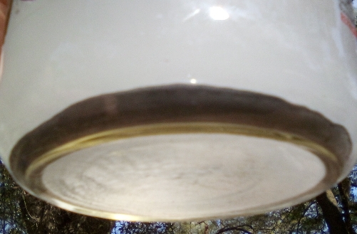

Just from one cphp.22 tin. Rven after a good vleaning i found i can go 250 shot then i hot to yend to the barrel. The old cphp i could go 1000.. also the old jad that gray stuff on them the new dont its that black like in the wash water above.

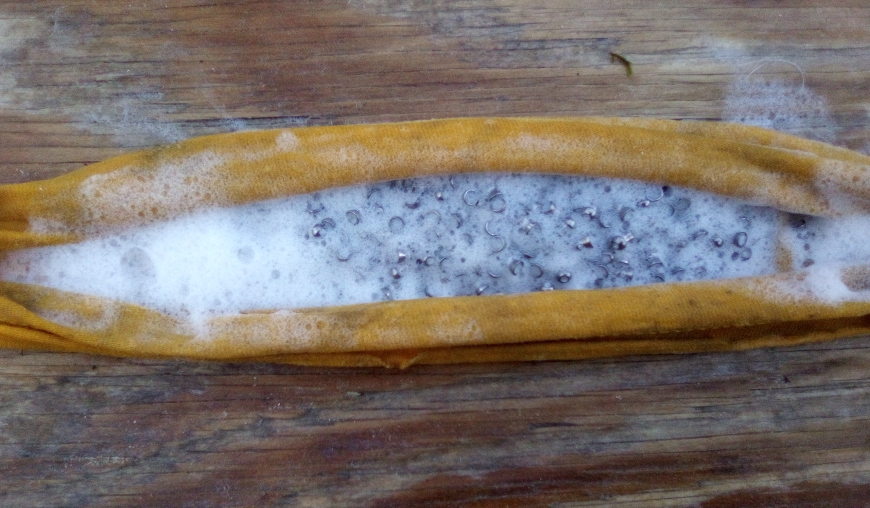

I do kinda got a picture-turial . Mayter of fact i did it a new way yesterday and liked it .. it gave a good scrubbing of fresh dirty pellets i think over my old way.. its football day so ill size pictures and post somthing on it you can look at . Just maybe some time its not like a Tuesday. That tenn- fla hame i aint missing..

My new way is in the red fleece rag dump pelleys in the add dish soap water ( that dawn claims 50% less scrubbing). Fold rag grab at each end and " shoeshine" buff working rag back and forth . Then rince ( i rince over the cups to see how much dirt comes off ) so its easy to wash rince repeat if nessary). . then buff dry pellets . And last is lube rag .. lightly lubed rag add pellets and buff again. I found that gives less risk of over lube and not get lube up in skirt. If you feel too much just rebuff in dry rag..

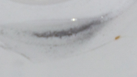

I try to knock it off a few times/ shakes till i stop seeing any in the bottom of the white cup i use . I do see better results vs not doing it or doing it once.
Suds job.. i forgot to add to above pics ..
