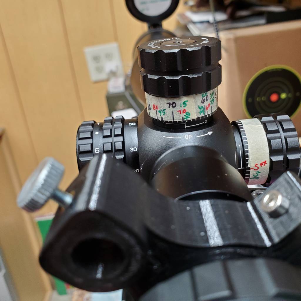

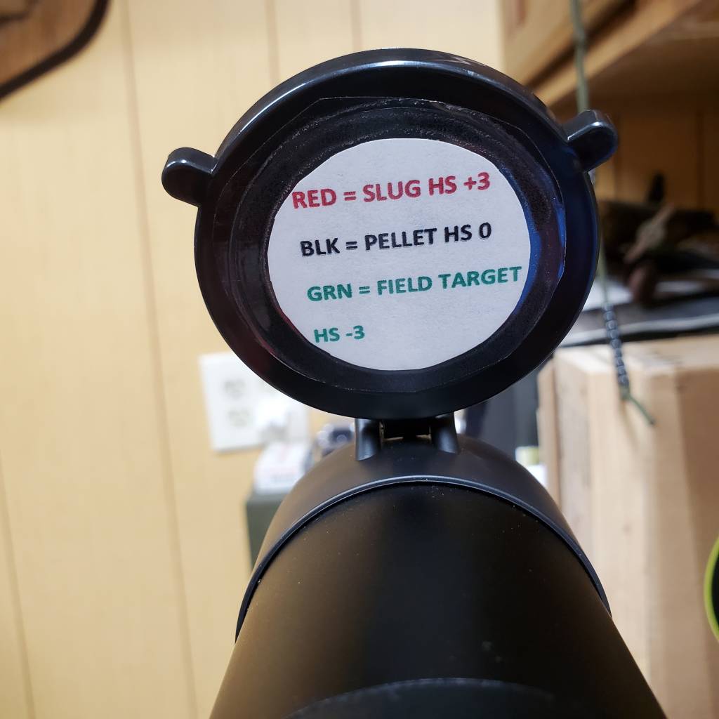

Getting ready for my first Field Target experience. Yesterday I found my HS setting for under 20 ft. lbs. Was able to mark my turret yardage. Today I made a new scope tape and a reminder for on the scope cover (because I'm a simpleton and need it). Looking forward to the Palmyra Sportsmans upcoming shoot. If anyone has any suggestions, I'm all ears.

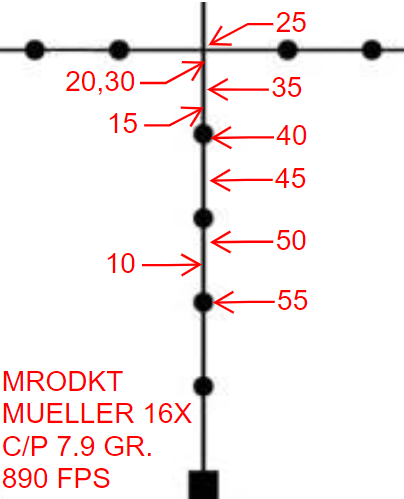

Most matches max range is 60 yds but what ever max range is zero scope for half of that so lets say 30 yds then you need to range find using your reticle and then find your proper aim point on the reticle without dialing the scope. Therefore a mil dot or similar reticle will be key for hunter class. For example at 10 yds you may be 2 mils low of center and at 60 yrs you may be 2 mils high of center and then if really windy you can of course use your windage mils for adjustment as well.
In addition to proper "hold" technique for the rifle of course so you are steady HFT is really about proper hold over or under (and windage when necessary) on the reticle based on your best estimate of the distance to the target using the information the reticle will provide you. 20 yds or closer KZ will probably be dime sized 40 yds + probably quarter to half dollar some lanes may be a * forced * off hand so be sure you are prepared for that as well. Good luck and have fun!
