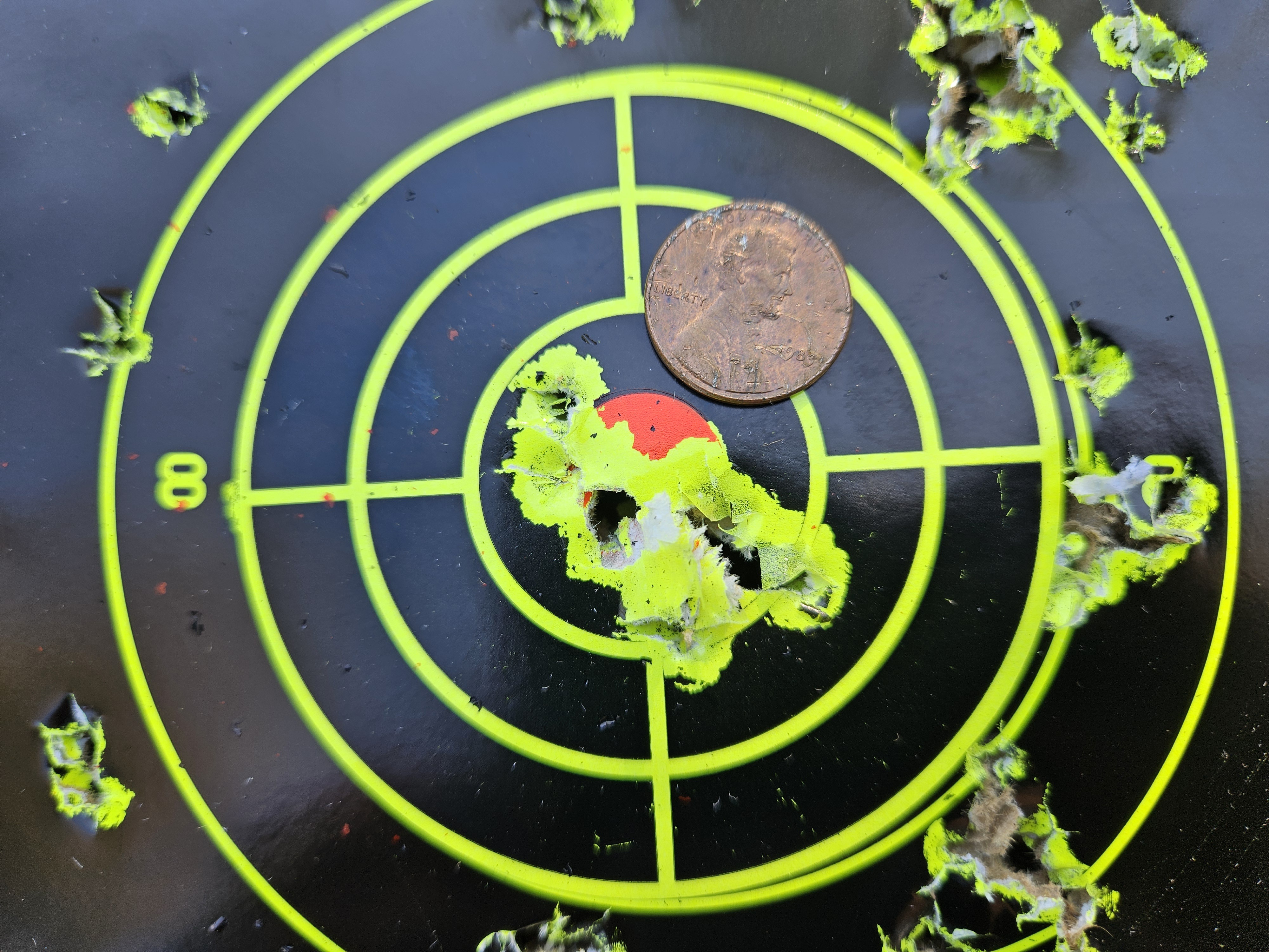

Here are some groups at 35 yards.
This large group was towards the end of my shooting to show what I mean by the downward right drift.

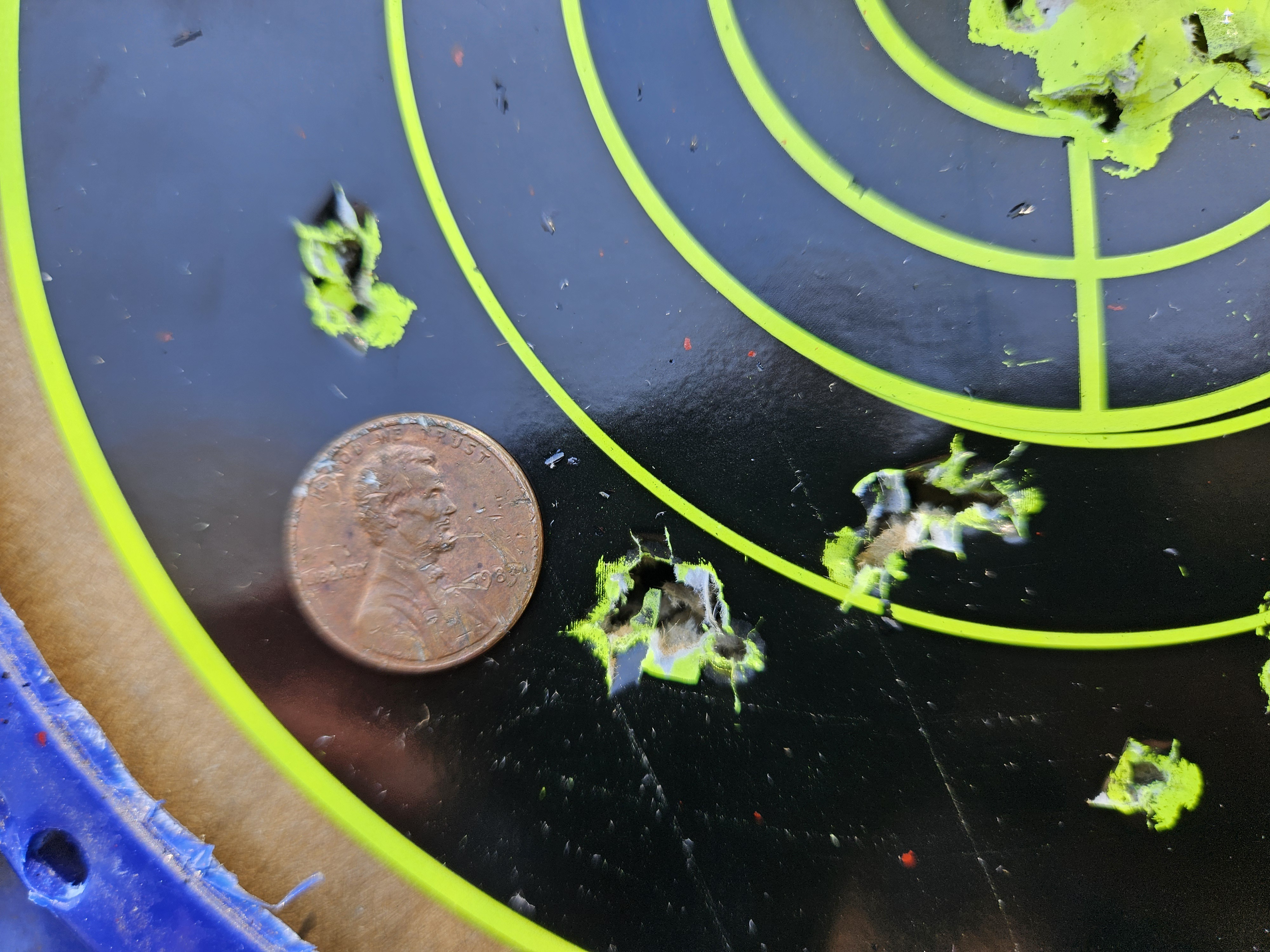

This next pic is 3 separate 5 shot groups with a fresh fill.

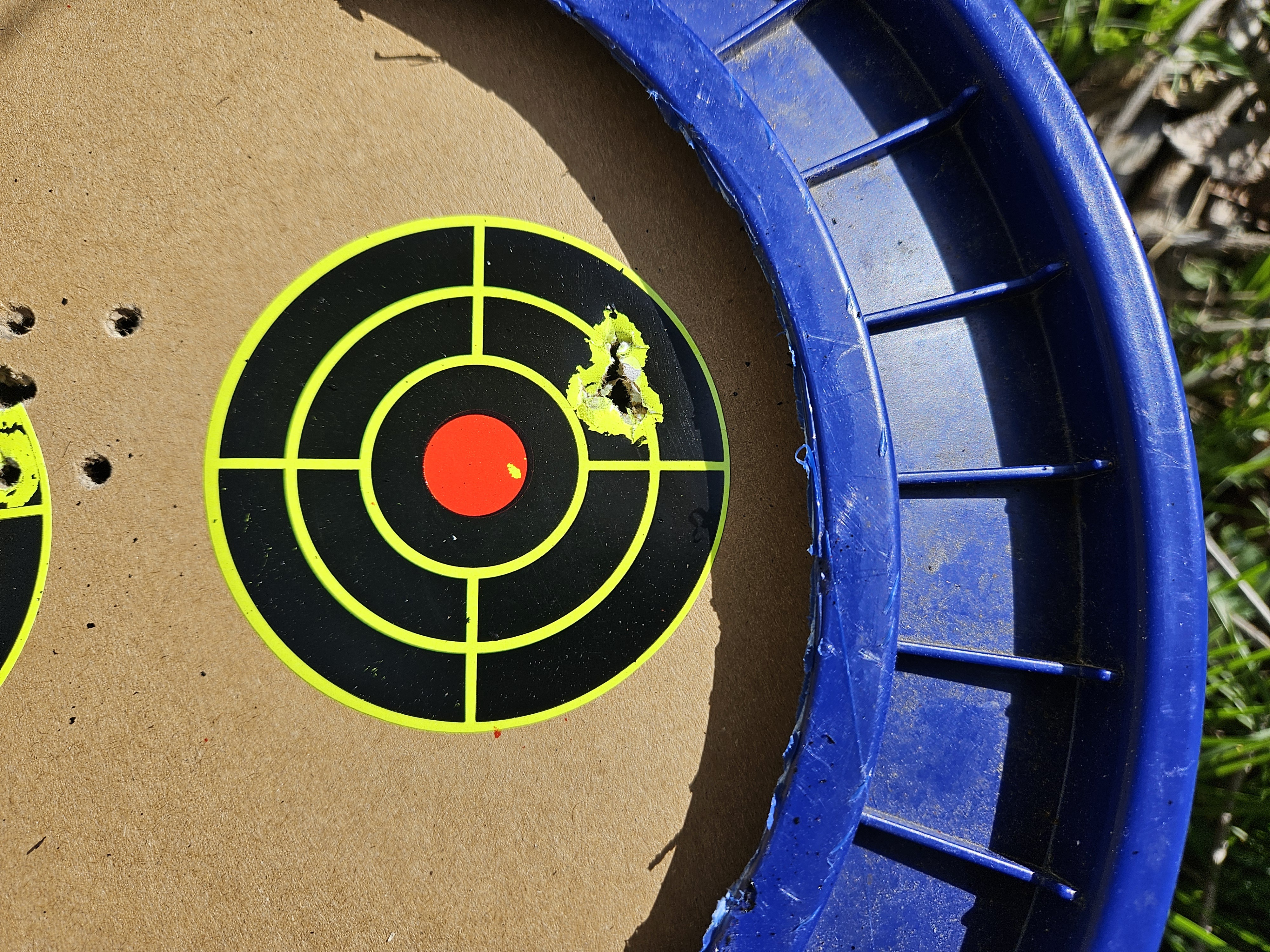

Here was a quick run of a full 12 shot mag
These groups were all shot from a seated position using only the bipod amd shouldered no rear bag.

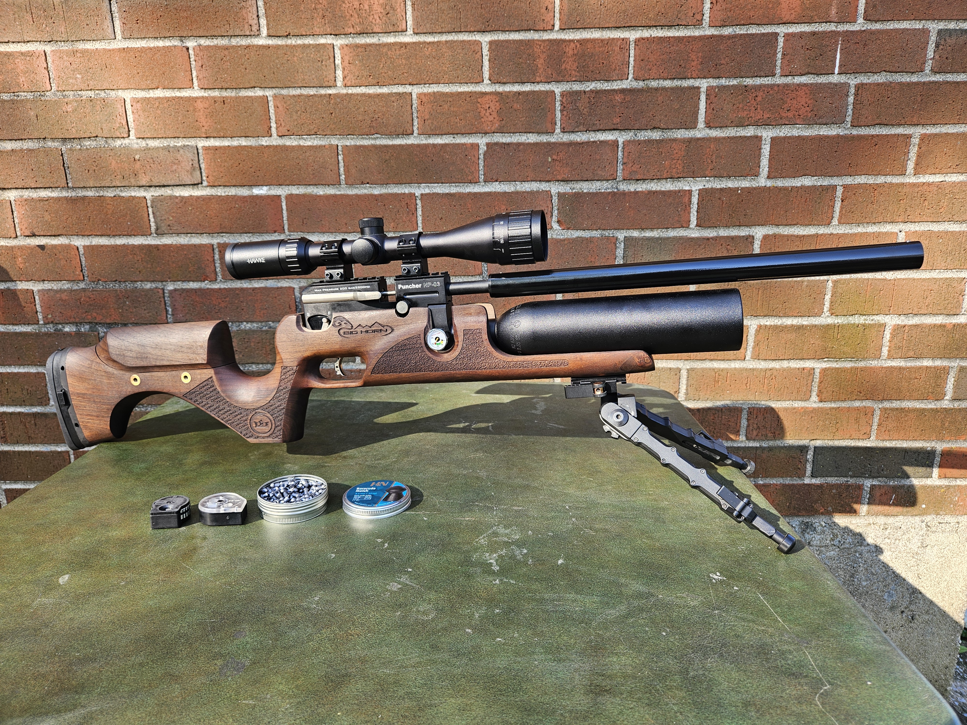

Here is the gun in question.

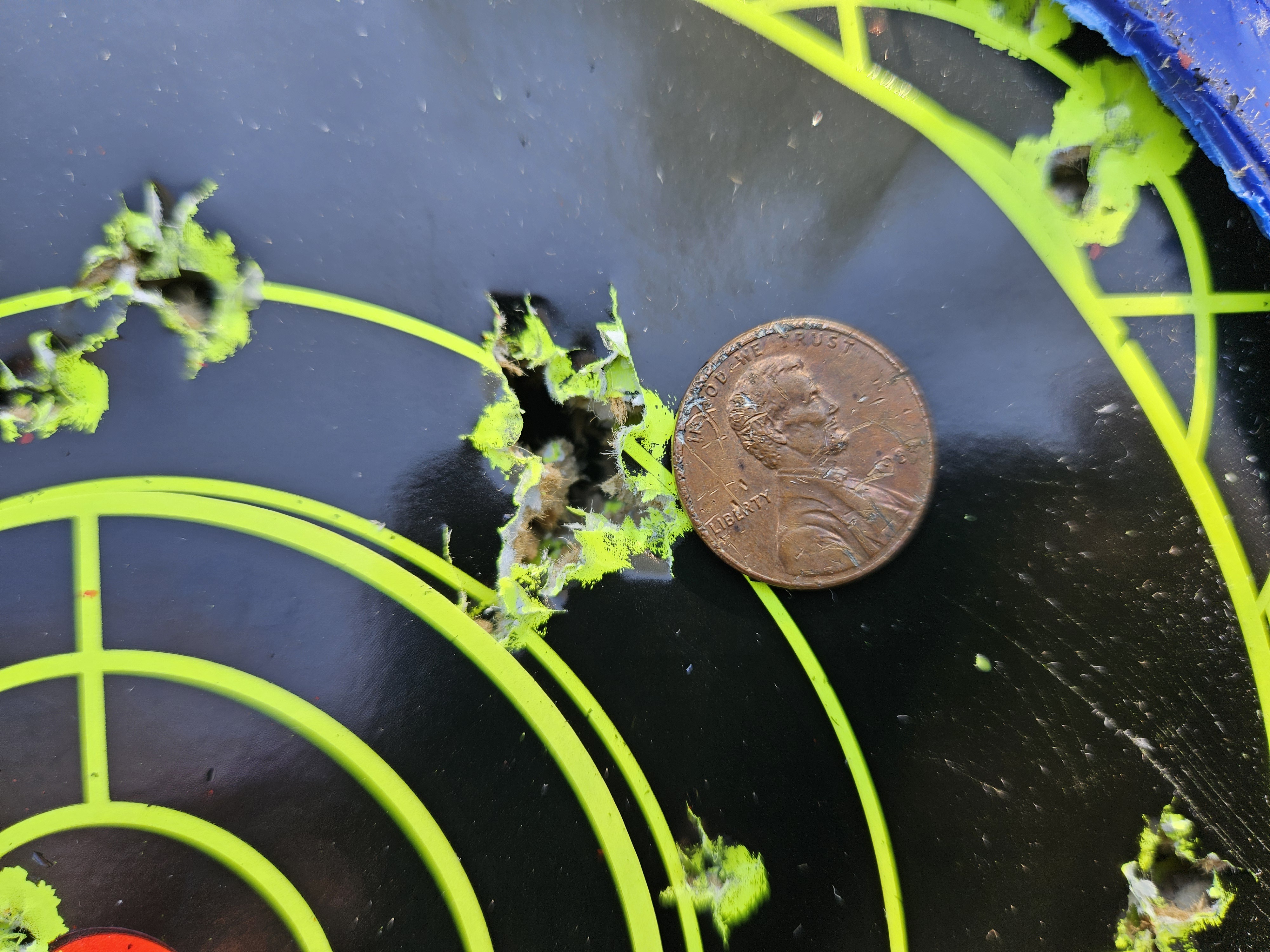

I didn't adjust my scope at all, just aimed at center where it's dialed for the baracudas. The fliers on the left side target were baracuda hunters. Odd, they group great at 800 fps out of this gun, now they're running close to 900 and open way up.
