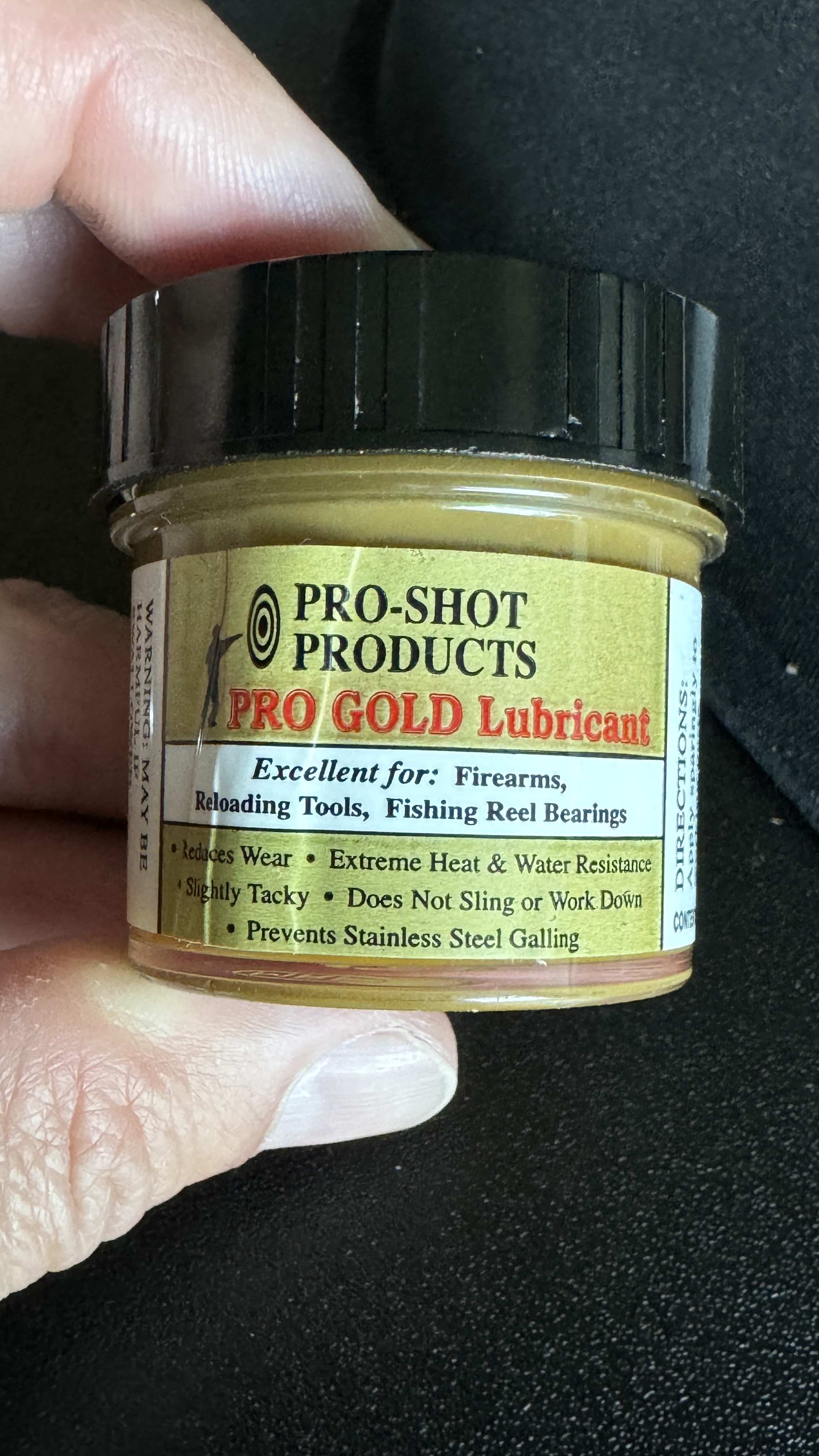

I use this on threads and high friction areas

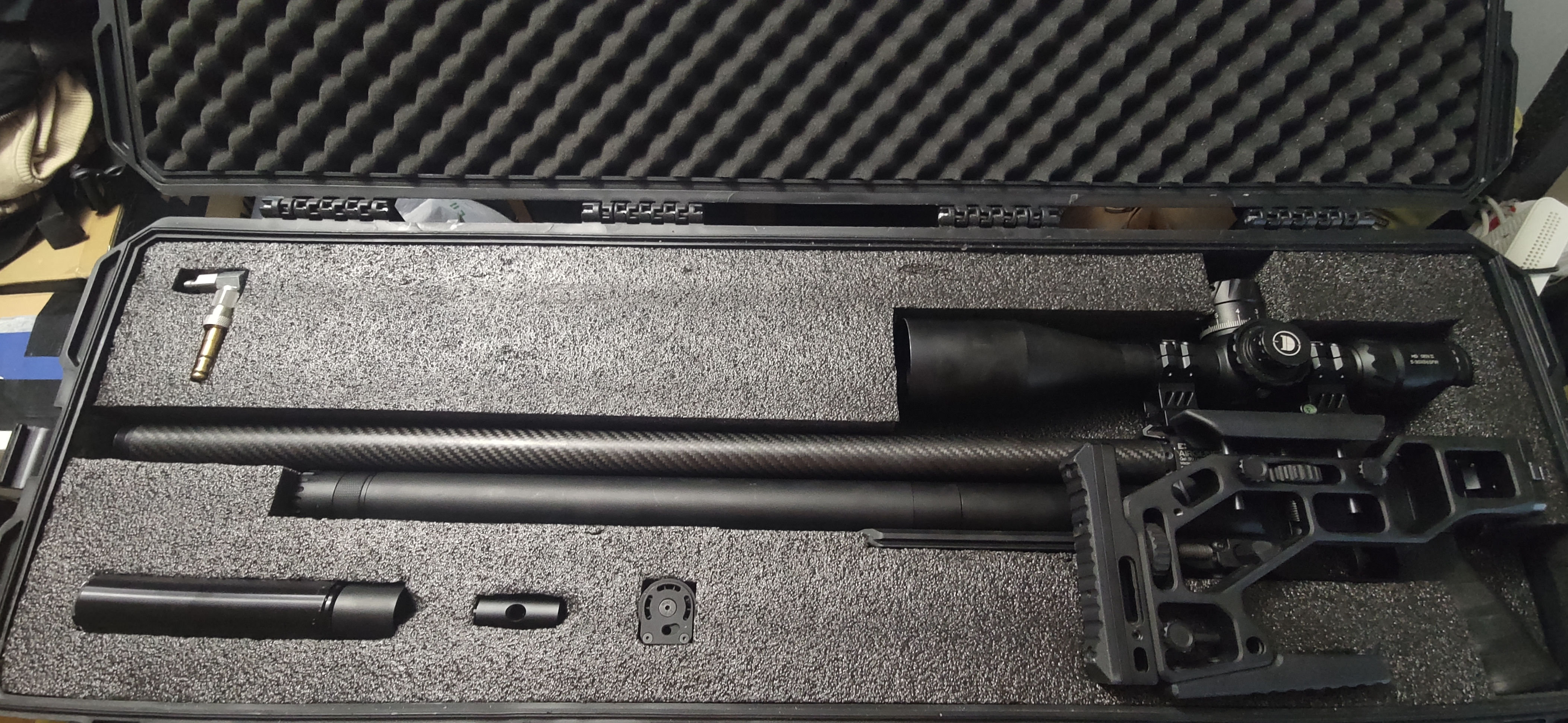

On my Two i just gave up and the Adaptor and moderator are now one.
Also. My case are so small not really room for the adaptor on the barrel.
This is the old Finnish made powder burner moderator, but i have my Huma one which i then swap around between other rifles.
The issue is the same when i put a moderator on my Cyclone, the piece that cover the smooth twisted part of the barrel have a tendency to want to come off too.
I too use something similar to the Pro-Shot product.
It's called STOS, which stands for Slicker Than Owl Sh!t. It was used to lubricate reloading machines and IS THAT SLICK!
The other suggestion of using anti-seize, while good is messy. And using Silicone on threads is not a good idea, they usually seize up.

@Revoman Thanks. I was thinking of using powdered graphite or molly paste on the threads between the moderator and adaptor. I'm aware of not using silicone for metal-to-metal.
