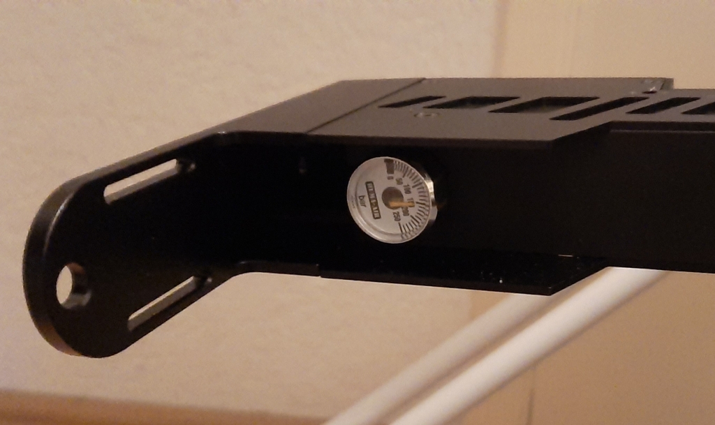

I'm awaiting a Huma mini gauge which i will screw into the breech instead of the hose fitting, so i can rule out the regulator as the cause of all.

It's not a reg tester i'm waiting for, just a cheap gauge. You can screw it under the breech and let it sit there instead of that hose fitting and read the true pressure of the reg.
Got the Huma gauge in the breech now so i can read the true regulator pressure. The gauge on the reg itself shows around 6/7 bar more than the Huma gauge in the breech, so i could rise the pressure a little to get a true 150 bars.
At 150 bar i now get 879fps with the 25gr Redesigned pellet. So it's better, but still a little short compared with Gregor in his review.
