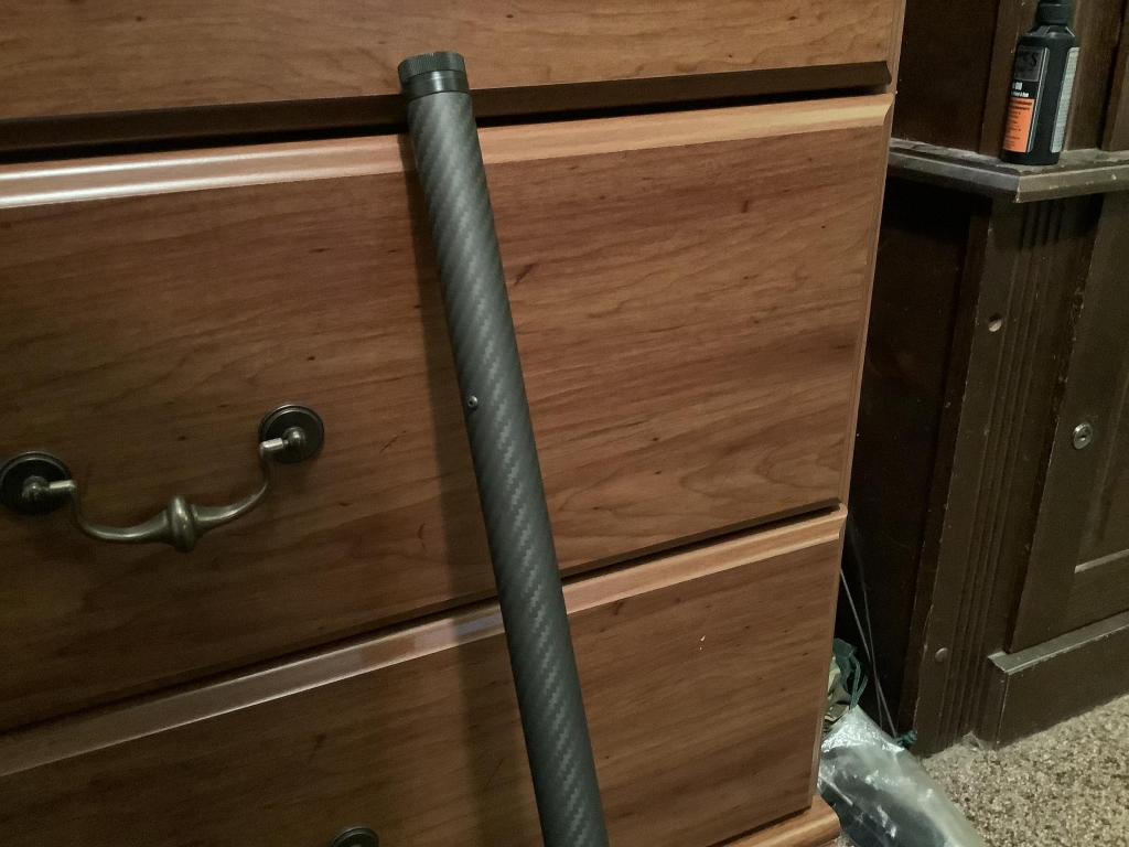

That first photo looks like you were going to show us a 28" barrel in that moderator.
Nice build.
Nice build.

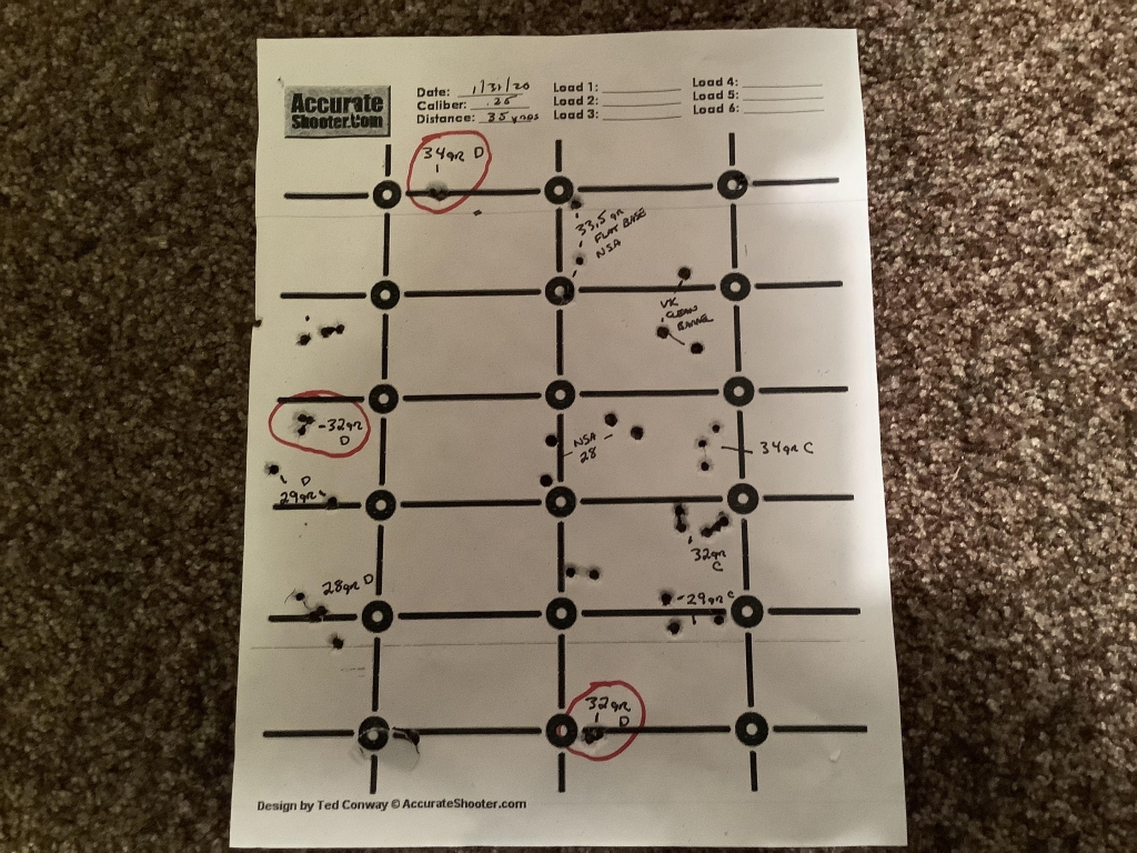

Its a real shooter with pellets out of the slug barrel but as of now it hates slugs. Starting to think if I would have put a choked pellet barrel on it would have loved slugs and hated pellets. Some guns are just defiant.
That is frustrating. Makes me think that its not the barrel and probably another issue. I am still new to pcp's but I would think there is a little bit of science that goes into the guns that manufactures make to shoot slugs exclusively. I would think a larger plenum volume and longer hammer dwell time would be more conducive to a heavy slug that has more friction against the barrel. But then again your knowledge of AG's far surpasses mine!
Have you tried the FX Hybrid slugs by any chance? Sorry if I missed that above, just did not see you saying that you did.
For slugs to fly true you need a different twist rate and a lot of power that's why some barrels are designed specifically for them.
Also some barrels are choked which with pellets improves stability and accuracy, slugs barrels are not chocked .... Now that being said, my short barrel, chocked and with a 17:1 twist rate on the Taipan was grouping great with some slugs....go figure!

I may have an answer for the issue. I too tried the old HW style inserts in the shroud. what I didn't catch for a while was the hair curlers were contracting in length under the high pressure. I didn't catch it until the accuracy got really poor. They were crushed.
I replaced them with thin walled alu. tubing that I cross drilled and wrapped with screen then foam. They held up and accuracy was much better. I think the accordion effect was causing clipping that I didn't expect, and never experienced with pellets at much lower fpe.
the lede will have to be longer, and smooth. It will help. But you probably already did that and polished the bore.
