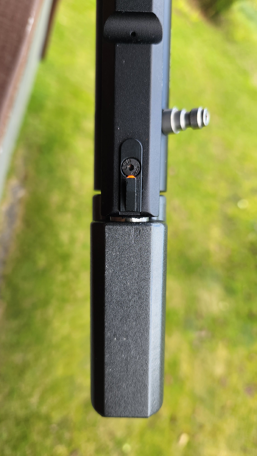

I have a few of Subscribers GK1 moderators. I have a .25 caliber V1. Shooting 24-46 grain pellets/slugs
I was looking for a moderator that I could use the iron sights, so the design had to be offset. I also informed him that I only shoot at the higher power levels (70-80fpe) while my preference is an aluminum or carbon fiber tube, I settled on a 3d printed design, the ones I have are very effective at controlling the powder burner report. I have yet to blow one up. None of mine have clipping issues. I will say though I have never dropped mine or bumped it hard. Price wise for me I’d definitely consider it to be affordable.
