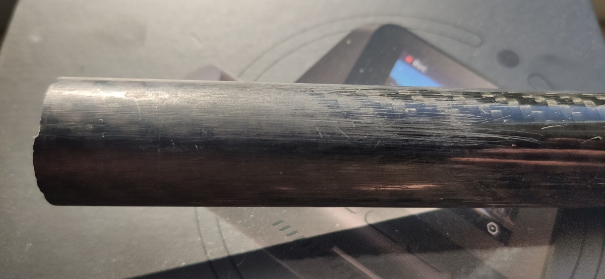

I just used pieces of sand paper and then went to town on the pipes, like a young boy would do thinking about the neighbours pretty daughter.
Have to be careful with CF dust though, that's not nice stuff to breathe in, i suppose you could wet sand with coarser paper than you would use sanding a car.
I just did it outside with the wind in the back, and wearing a corona mask
you can still see my sanding on the left over pipe.
You of course have to pause now and then to make sure you are not taking off too much, so the pipe fit nice and snug inside the barrel housing.

Not sure I needed that visual... Or, maybe I did because it worked! I used wet/dry sandpaper held with a damp towel [to capture the dust] and went to town! I do believe there was a coating because it didn't take much before it slid into the Barrel Housing. It's on the Liner and in the barrel now, so that job's done! Thank you for all the replies and assistance!
