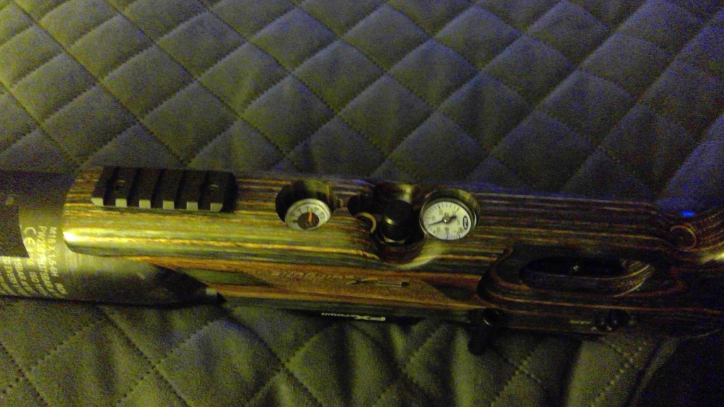

My FX Crown drama continues... After waiting 12 days for my warranty parts, I receive two used and incorrect gauges for my new 2000.00 FX Crown...
Hmmm, this doesn't look correct AT ALL...!!! I'm not going to install the second gauge, the first looked so terrible and is obviously NOT for this rifle, I am so upset...
So, now I get to wait until Monday, call FX and get them to send me the correct parts...!!!
FX will make this correct, and then I will probably sell this FX Crown and never look back (now I wished I had purchased this with my Chase card, I'd get every penny of my money back for this lemon)... This has to be the most disappointing customer service I have ever received...

I still can’t believe FX is using these “gauges “ . I replaced both on my Impact at my cost with the new FX black faced . Don’t get me wrong , I really like the Impact and haven’t had any real problems with it . This to me is like putting plastic hub caps on a Ferrari.
Out of curiosity what other issues have you had with the Crown ?
