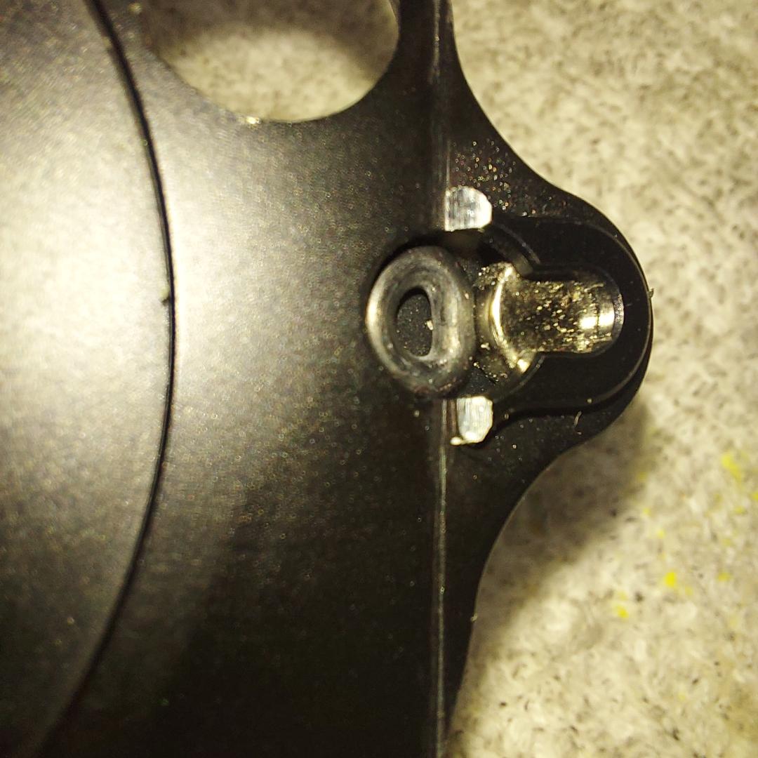

So here a few weeks later ... I have a EPOCH in house & been playing with it as weather allows.
COCKING JAM .. or as discovered a MAGAZINE jam preventing closing of breech / cock handle ... OR, just firing an empty shot.
Well it happened a few times to me being similar to OP of this thread in video.
* What the hell was the issue .... The skirt of a pellet just catching the tabs of the magazines cover plate was found at fault.
If I firmly knuckle tapped the loaded mag it would free up .. OR, removing mag from rifle would see a pellet 1/2 way visible to being able to load, or an empty hole.
Starting to remove Mags cover plate and the pellet cassette would jump and all would line up & work again.
This simple mod is taking a small file and placing a bevel on the edges of the 3 index tabs of cover plate, thus prevented a pellets skirt for snagging & getting hung up ... it IF & WHEN a pellet skirt was rotating by it when up against the cover plate.
YES SKOUT has been forwarded this finding FWIW ;)
