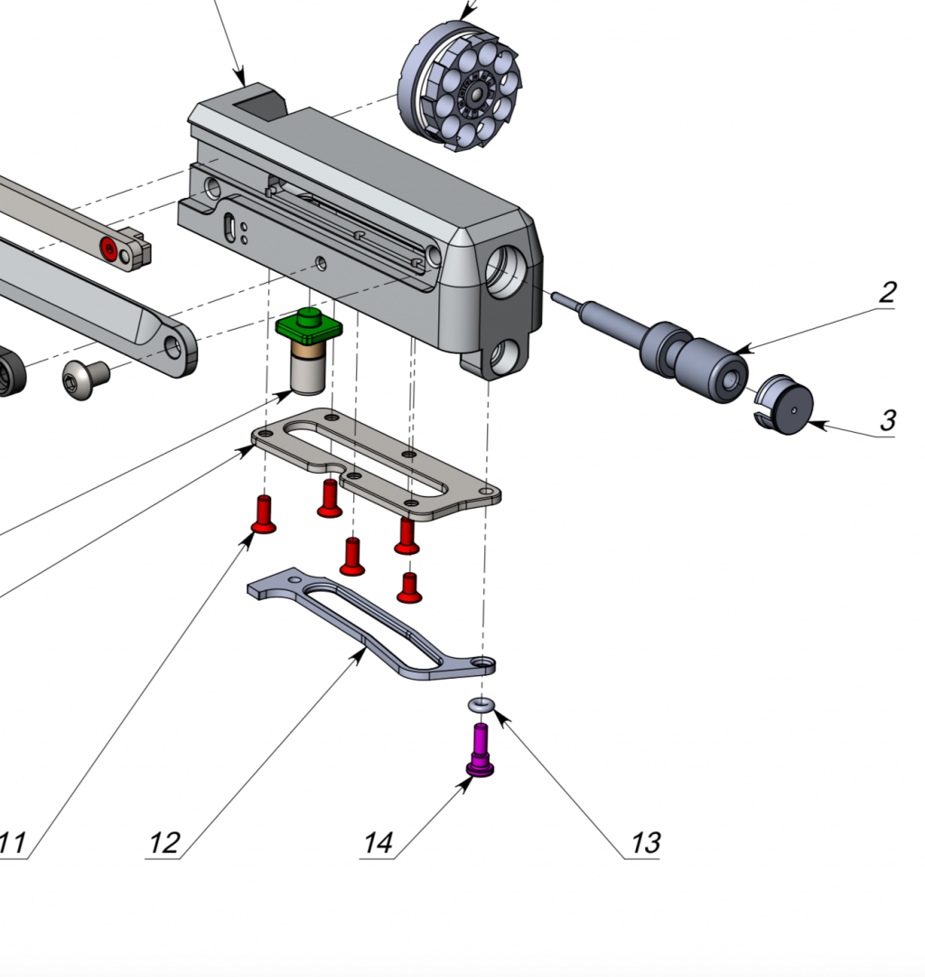

...Maybe your .25 R5M accidentally had a .22 or .177 indexing lever installed which would mean the 9 shot .25 magazine will not fully rotate every time you cock the rifle.
The R5M does need a firm and deliberate hand when cocking, the handles need to be pulled firmly all the way to the rear to fully index the magazine. If you don't pull the lever firmly all the way until it stops, the magazine will not fully rotate and it will either stop the bolt when pushing the cocking lever back forward or the probe will "bump" the magazine into alignment when pushing the bolt forward and shave the pellet skirt as it enters the breech which hurts accuracy.
The "Lever" part for the .25 and the .22&.177 as kiba points out are different..which probably explains why .22&.177 don't tend to have the same issue as the .25..
Lever #12 on the drawing
KL100401 .25
KL100404 .22 & .177
