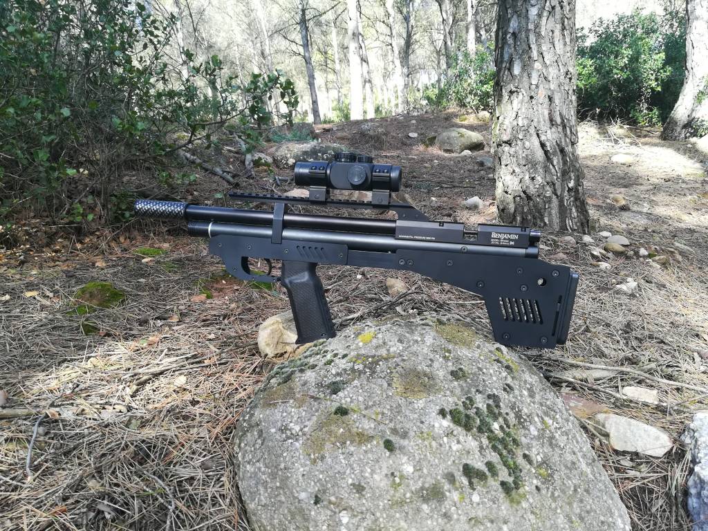

Hi all:
I show you the data of my P.rod with its improvements.
- Transfer open to 0.1181 in
- Hammer feed to minimum.
- hammer spring tightened two turns
- rapid-70 regulator (no need to drill a hole in the air tank)
- Regulator set to 1800 psi
Average speed: 679 fps
Medium power: 14,67 fpe
Pellet: JSB jumbo express 14,35 grains
(3000 PSI)
675 - 679 - 675 - 672 - 679 - 679 - 679 - 675
682 - 679 - 682 - 675 - 675 - 673 - 679 - 675
675 - 676 - 679 - 675 - 675 - 678 - 678 - 675
675 - 669 - 666 ..... (1800 PSI)
Three magazines excellent. I believe that for the size it is; it gives me a good autonomy of shots.
And now, a few days ago, I received the new bullpup kit made by Rapid-70.
I am in love with her. 😍😍
She has it all: trigger safety, butt plate adjustment, quick strap connection ... And the weight is ridiculous 3.80 lbs.
