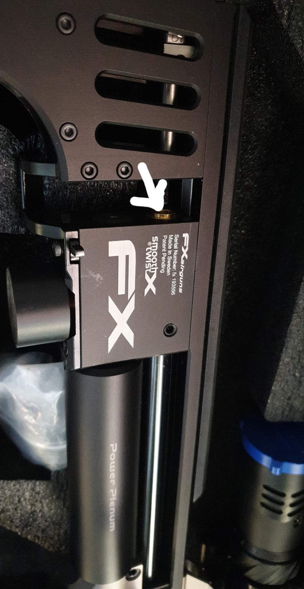

I have sometimes the same problem with my FX, it leaks out where the arrow points.
I think the main reason is impurities and dry o-rings, because there are not always leaks,
but especially in cold weather they happen more often.
