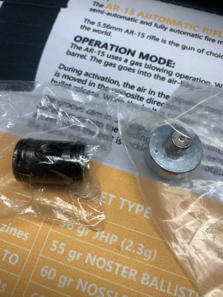

On the P-rod the gauge block is floating in the tube, it's seals with o-rings on each end. The block is about 1.5"-2" long. to seal the gauge to the block use teflon tape on the threads and that should be good.

Here's what the block and the gauge looks like:
