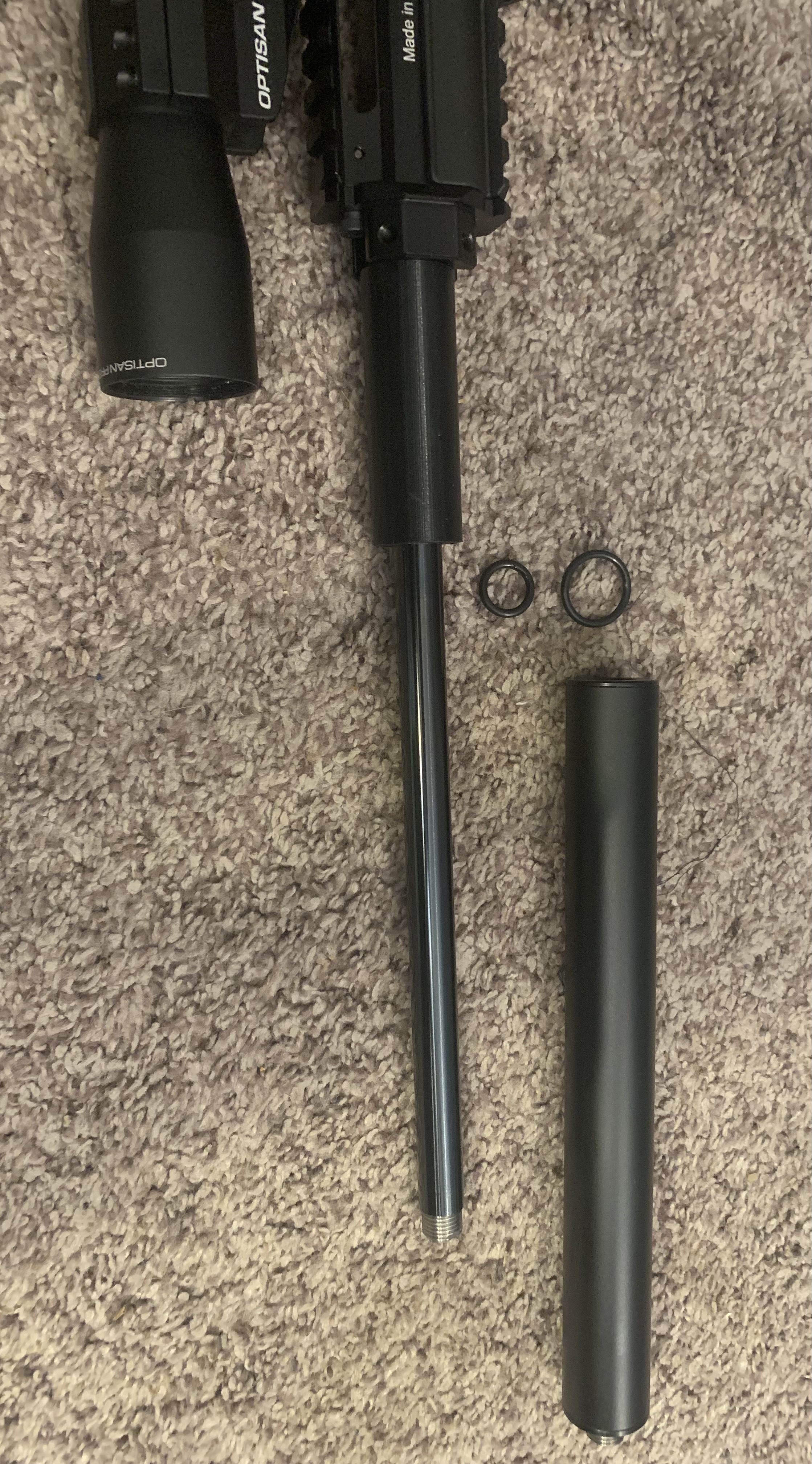

I then decided to try the Flex approach using a Huma adapter and FX liner/barrel sleeve and shroud. I used a 177 500mm heavy liner that came from Europe that I already knew to have stellar performance with the little Zan pills in my M3.
Initial testing was made with 150bar reg and 2.2mm total jetting shooting the 10g slugs at 970fps. No doubt, the platform is capable of much more but that’s not my goal here. If I can shoot beyond 80y accurately then I’ll take the quieter, more efficient 10g slugs over their larger siblings.
The first evaluation of this approach , using a standard barrel setup with the liner secured with 2 orings and the FX shroud in place was pretty good. Accuracy was on a par with the Alfa barrel but the fliers were gone. I’d say 1.5-2moa at 80y. However, a big improvement was observed in terms of sound. The FX shroud and an IA1200 mod completely silenced the front end, leaving only the action noise which is pretty mute with the high reg pressure/large jets producing a very snappy cycle. Unquestionably backyard friendly and no louder than popping open a can of soda.

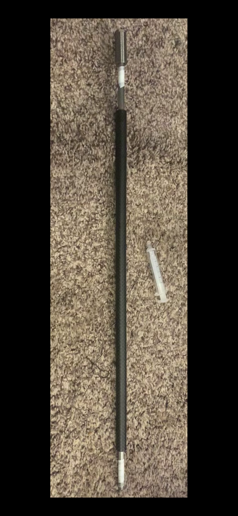

Still, I felt that the accuracy could improve so I set about making the liner and barrel more rigid. First, installed a carbon liner sleeve bonded with silicone and wrapped the ends of the liner with Teflon tape to ensure a snug fit into the FX jam nut and TP adapter:

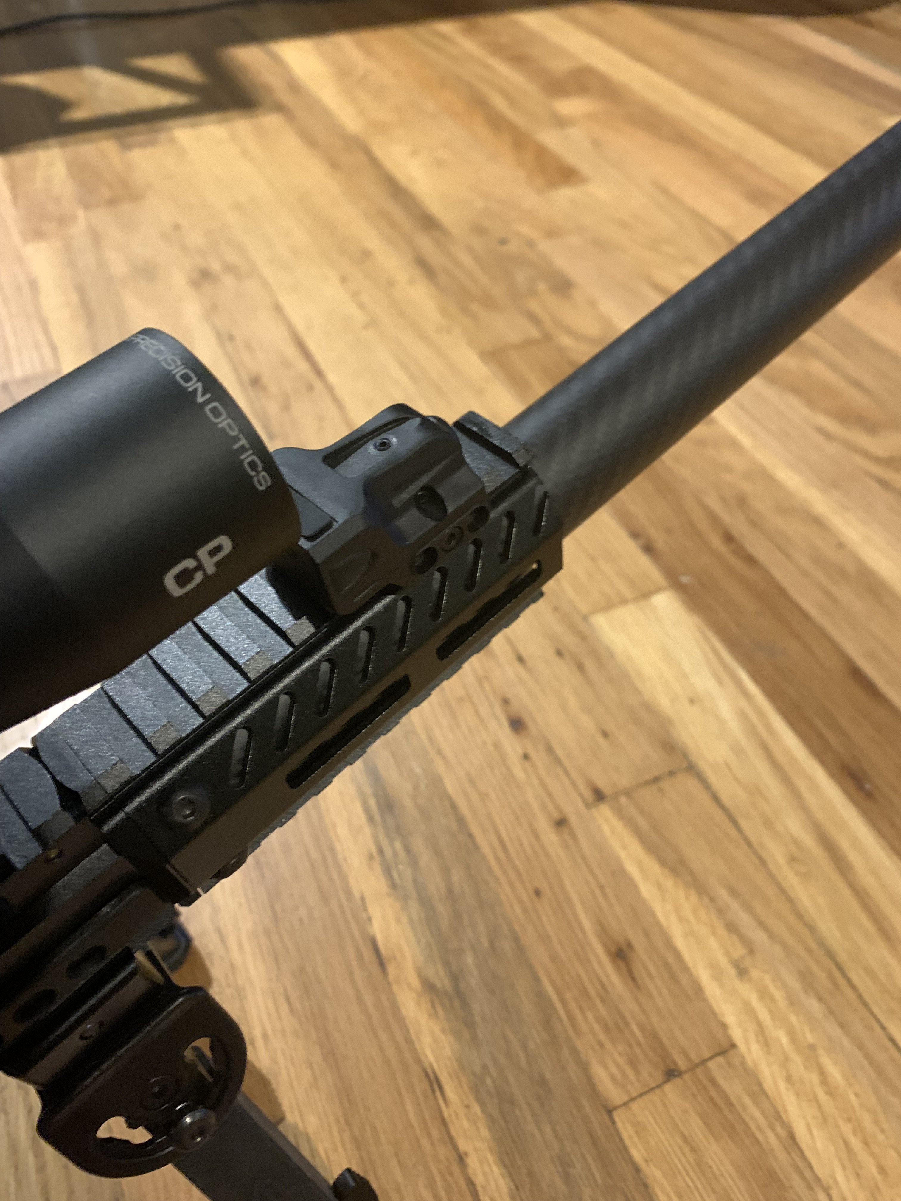

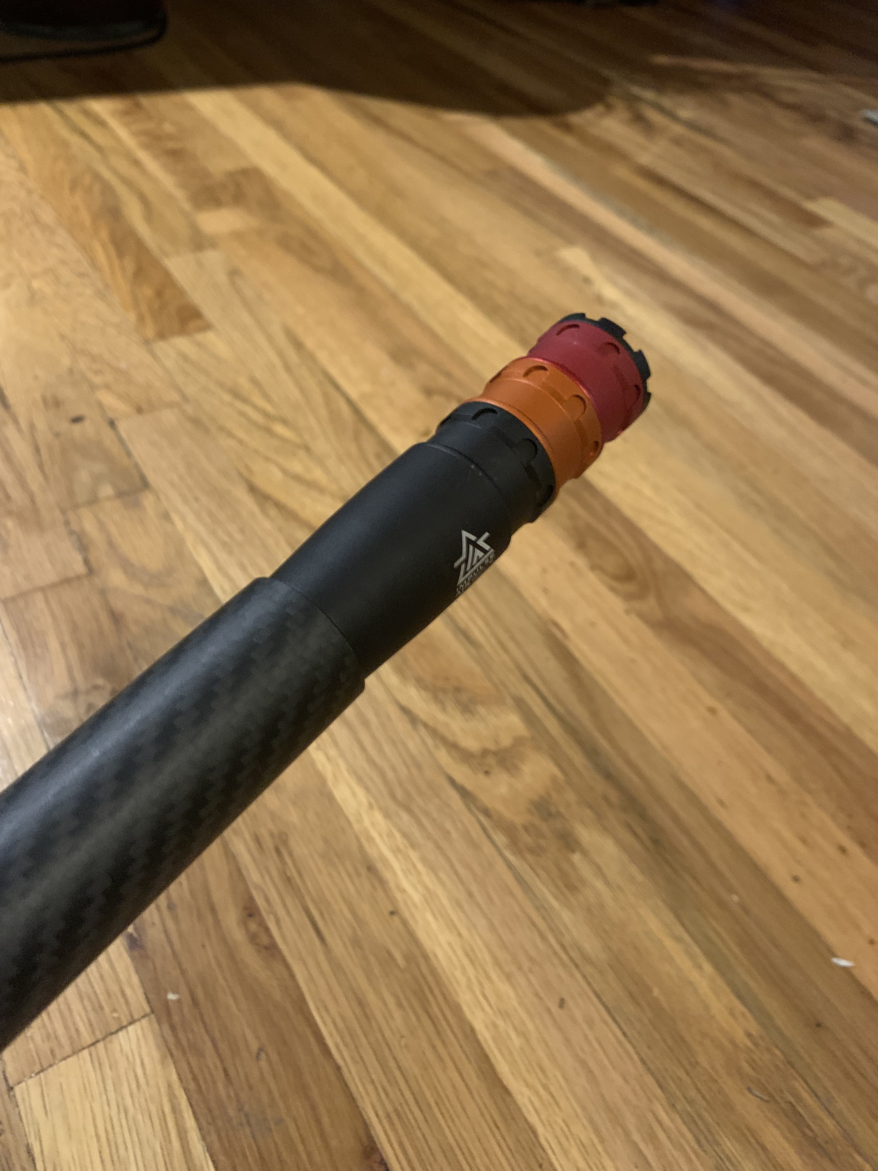

Then, over a few weeks I tried various methods of making the barrel more rigid. Sparing the details, I ended up using a printed piece to fill the gap between action and shroud. Because the shroud and printed “buffer” might not have perpendicular ends, they were put together using epoxy washers, with the shroud getting tightened down while the epoxy was soft, to create a natural fit. The shroud and action surface were first coated with silicone to prevent the epoxy from sticking, allowing the shroud and buffer tube to be removable. Shot with just the buffer tube on: (ignore orings - they were superseded by the epoxy attachment method)
Following mounting of the shroud, a CF tube with an ID matching the OD of the shroud was slipped over and glued in situ to the printed buffer. Note that this is not working as a tensioner, just a stiffener.
The whole arrangement is very rigid, consistent in POI and increased in accuracy.

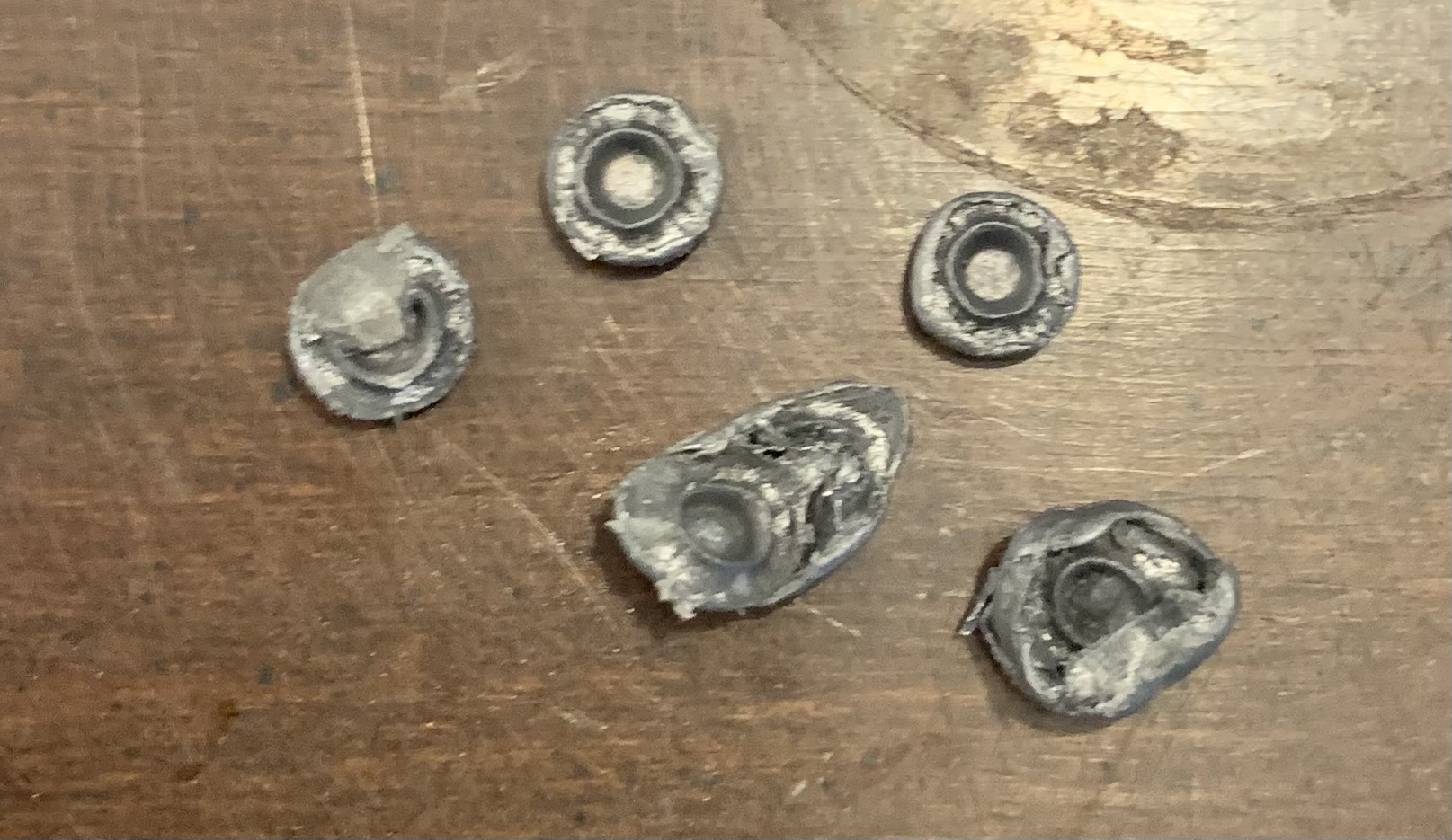

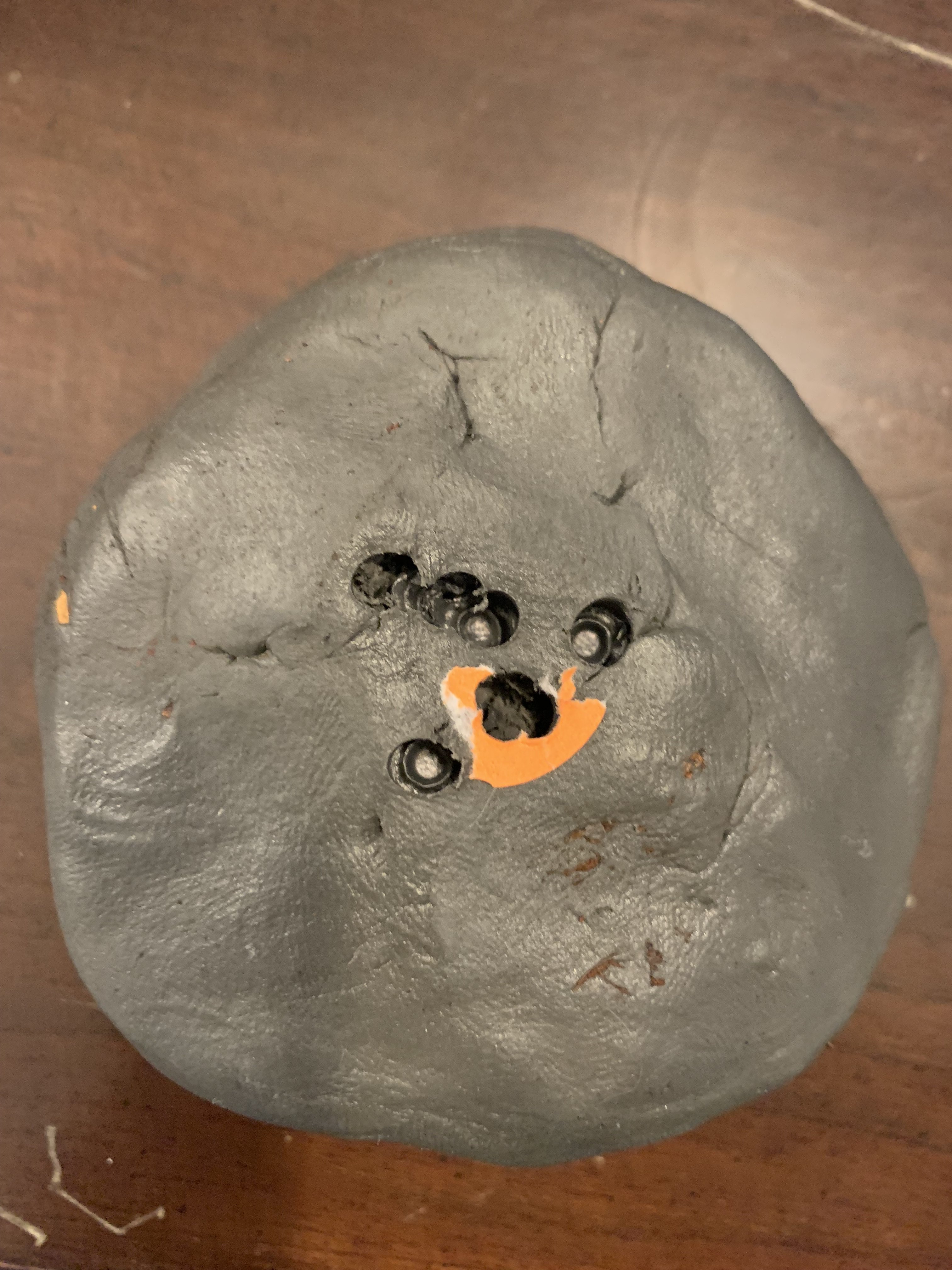

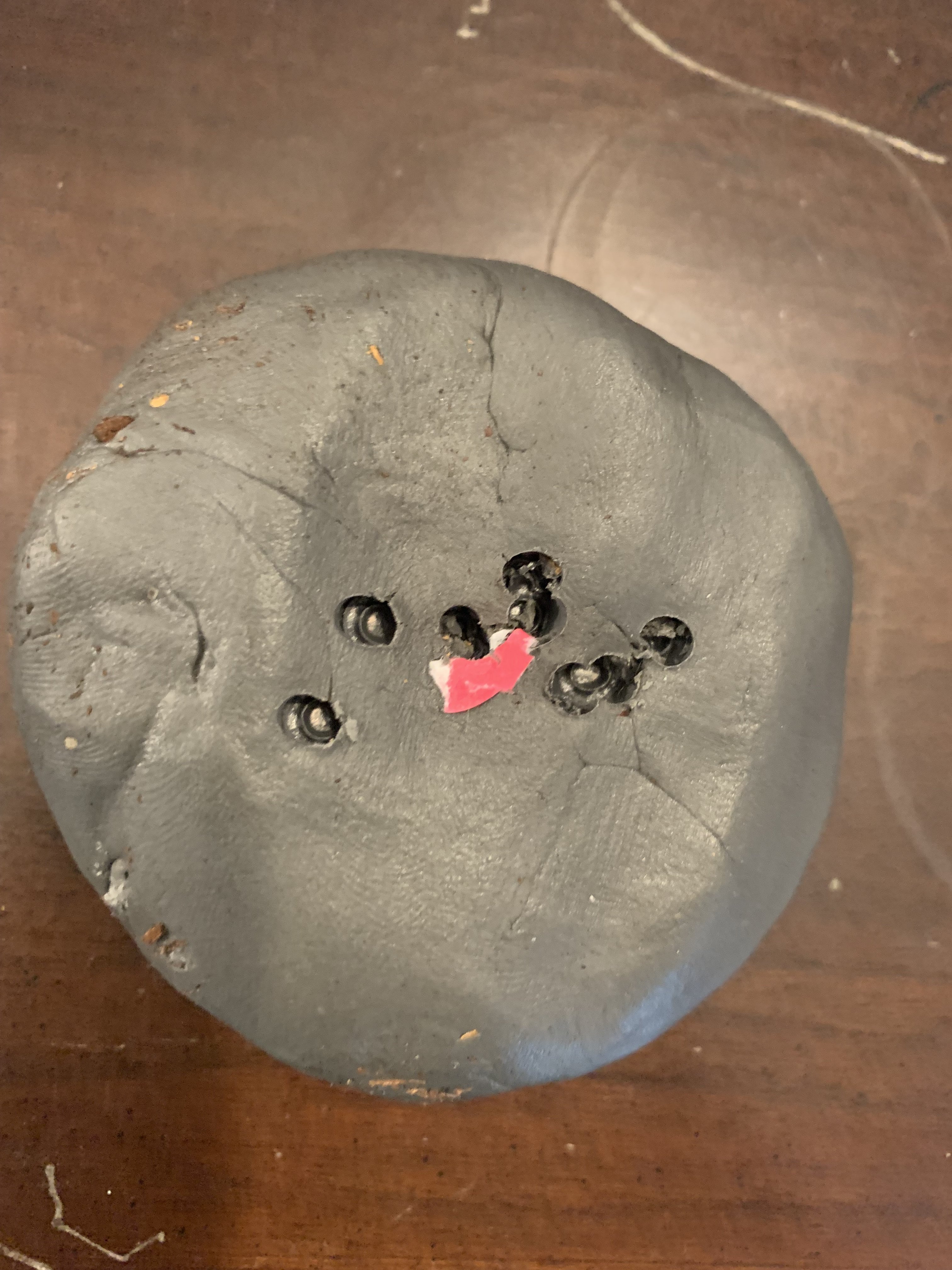

The slugs extracted from the duct seal:

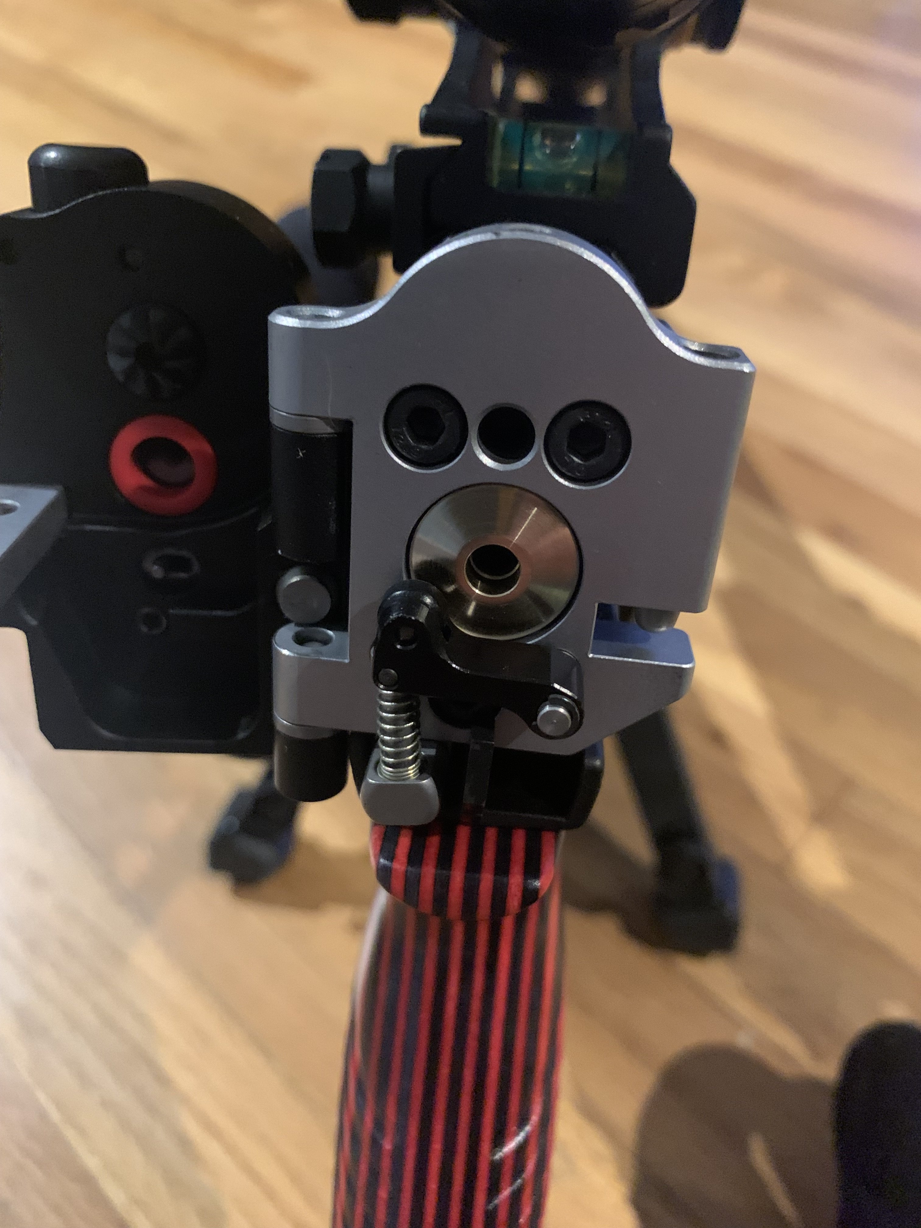

What I could not manage is - a blow by between the mag and the barrel insert. No matter how I am trying to eliminate a micron gap, when I raise the gun against a backlight I can see that little gap....with a magnifying glass...
I got a feel that the barrel clamping hole was bored under slight angle (to get a MOA on the top picatinni rail) and the magazine is not sitting perfectly perpendicular.
This doesn't bother the accuracy but makes a noise.
I was thinking to remove the silver backplate and shim it, but so far I was more lazy I could not bother with.

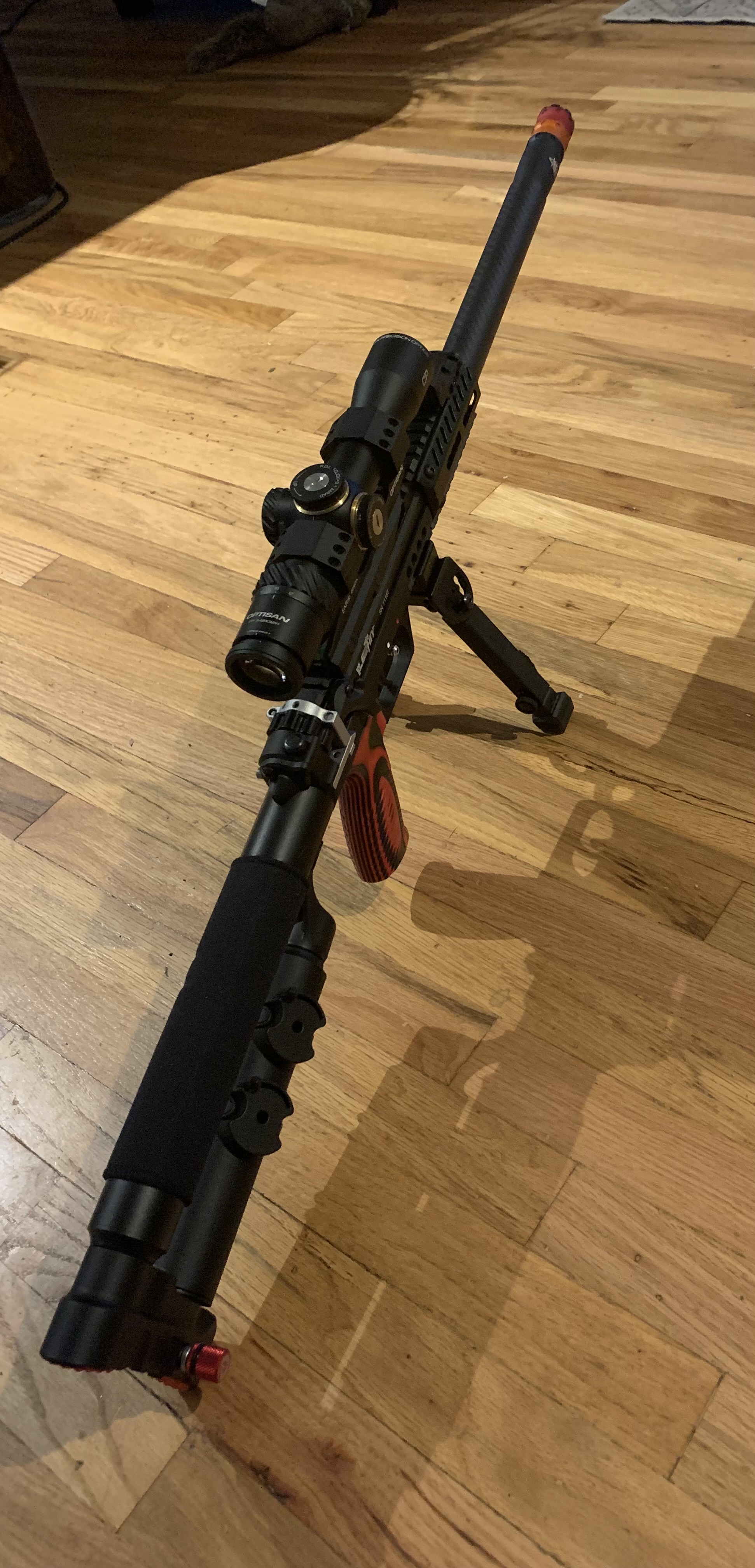

I had a PM regarding my description of an “epoxy washer”. This is just a chunk of resin molded into a donut/washer when it’s partly set. It is then placed between (in my case) the shroud and printed buffer such that the epoxy ends up forming a mating surface between the ends of the shroud and buffer, or the buffer and the action when the shroud is tightened on. Obviously the buffer is printed with a length that is 2mm short at each mating surface to accommodate the buffer.
Here is a shot of the first one I made. I subsequently reprinted the plastic buffer to exactly match the shroud OD so that the CF tube would be snug:
