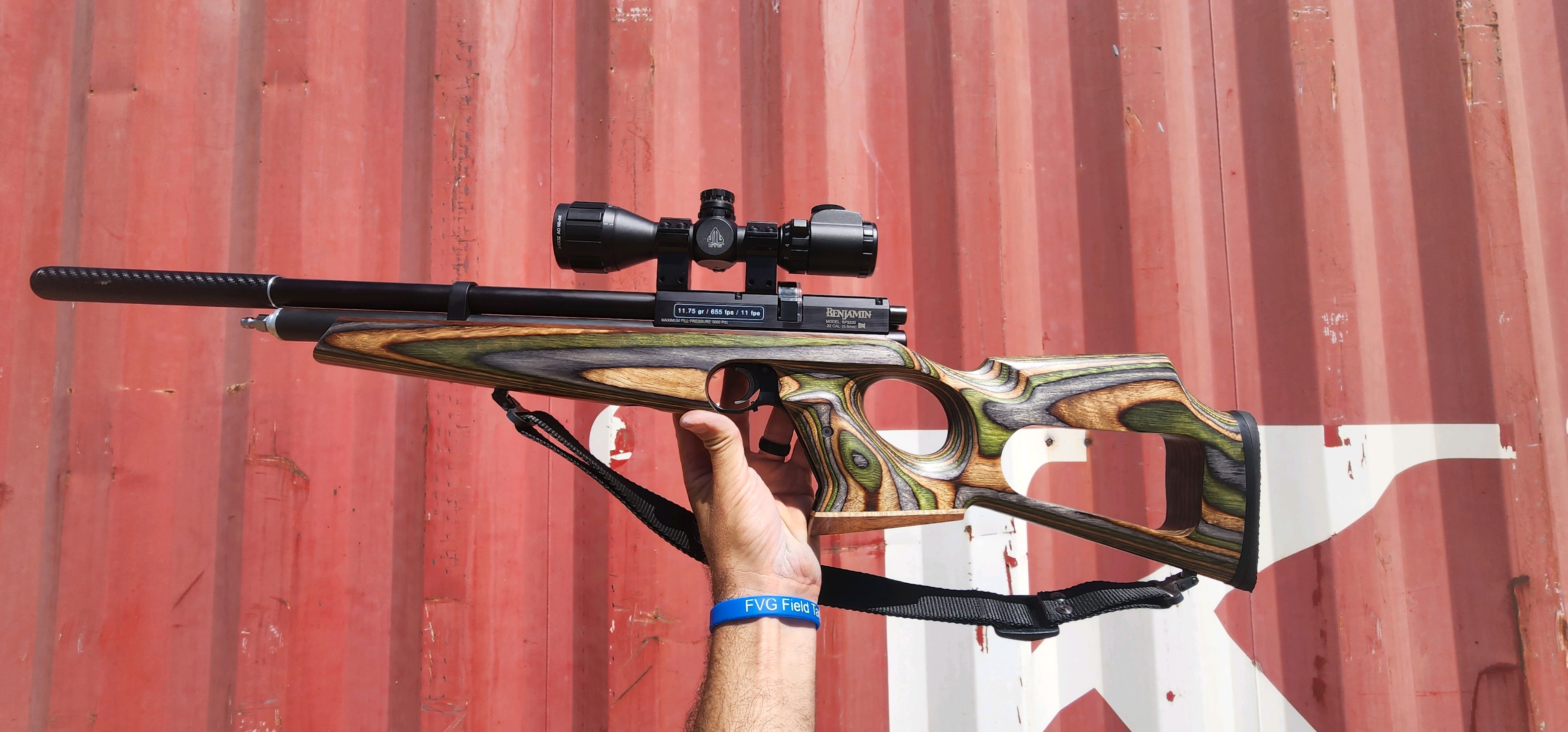

While I love mine, if one is a tinkerer this is a great platform. It's helped me develop an amazing tune for the 1720 and prod.
I love my little Prod build. It's a solid shooter!
25 shots at 18fpe per fill.
Corcoran Carbine Stock
Marmot Militia Barrel
TKO Moderator
Light Weight hammer
Valve porting
Trigger work
Custom springs (Hammer and Valve)
Huma Regulator installed
Some secret mods I don't share online
Tuned for reasonable power, I could go for more power, but why? It shoot so well at this speed.

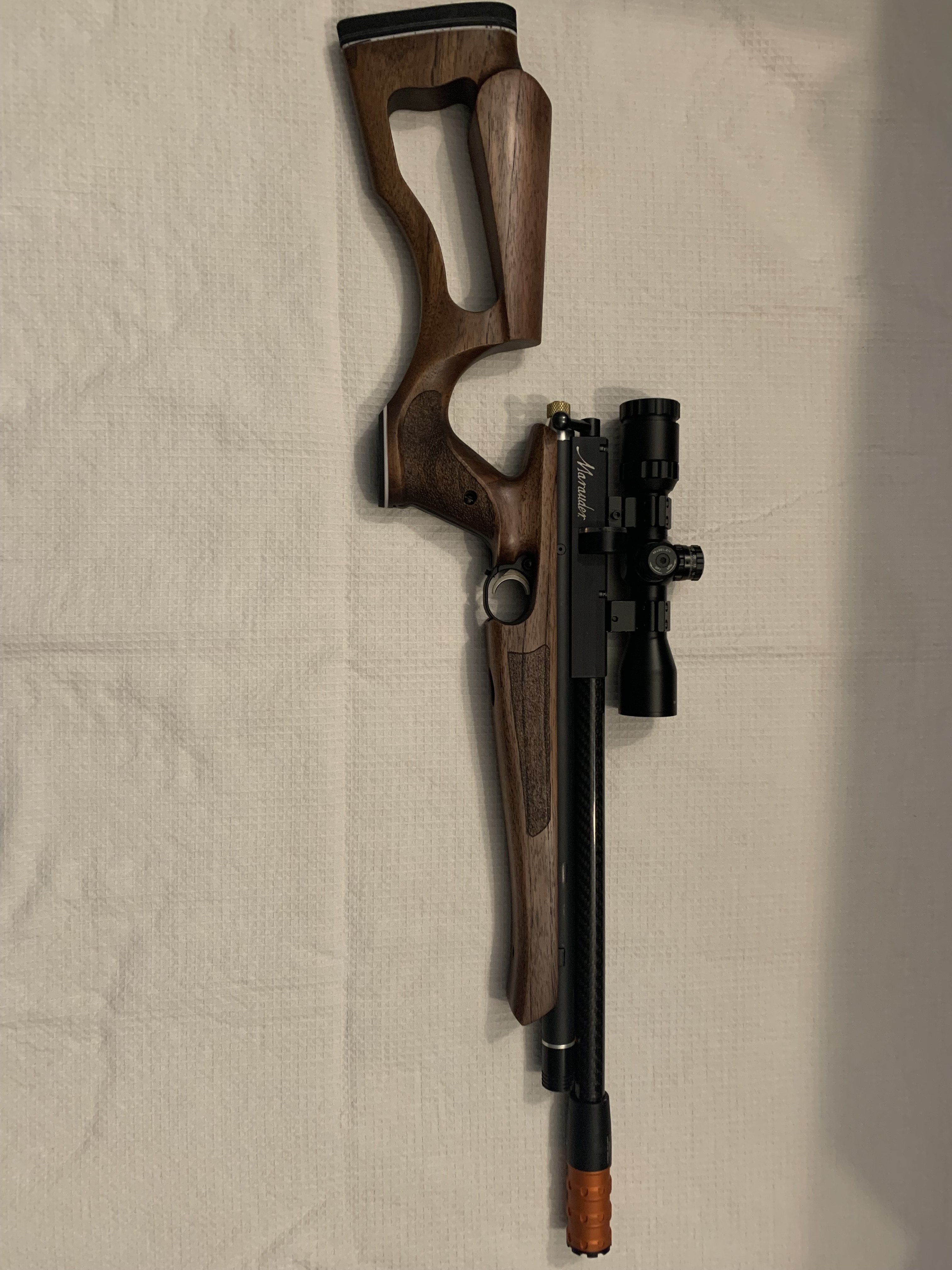

One of my favorite P-Rods I’ve seen. Love the looks of it with the laminate stock. I just got into PCP airguns myself. I got a Umarex Notos and just got a prod to tinker with. I got a manop stock for mine.
I’ll start with a shout to @_CTAIRGUNNER_ for inspiring me to finish this P-Rod with an Airgun Revisions wood stock and thanks to Rich for doing such a nice job. I’ve had this prod for a couple years and it’s been through quite a few “experiments” including orings, SSGs and a balanced valve.
I finally settled on a Huma reg at 115bar with a gauge delete, lightweight hammer, PEEK striker and 45 spring. It is ported at .125” from the (stock) valve to the TP. Crown and leade were cleaned up and the mags were resprung to prevent pellet damage. Finally, the trigger was polished and set at 12oz. The barrel has a stock shroud that was shortened by 1 inch and is affixed into indentations at the muzzle end by 4 grub screws. The barrel is then tensioned via a carbon tube by the impulse air IA1200 moderator. It has a taper at the muzzle end that allows for cap removal and filling without unscrewing the mod, which would be a dealbreaker with the tensioning. Part of the stock barrel band remains to affix the wooden stock.
The power adjuster is set to deliver 700fps with Hades, tuned at 97% of peak speed and gives 20 shots from 3000psi before dropping off the reg. I’ve played around a lot with pressures and speeds and this is the sweet spot for me. ES is ~6fps and I have no issue with creep after sitting for a week. With the light hammer and moderator, it is absurdly quiet at both ends. The main goal here was to maximize accuracy and the mods have really worked in that regard. It stacks those Hades out to 40 yards! As always, it’s a bittersweet moment — It’ll be a pleasure to eyeball and View attachment 406082shoot but I lament the end of the tinkering. Thanks again CT and Rich!
Great looking P-Rod! It even shoots as good as it looks too! I’m new to pcps and just got a prod to tinker with. I also got a manop stock from Rich.
What moderator is that? I may have some more questions down the road on tuning. Sounds like you’ve got some experience. I have no clue what I’m doing.

Hi Rob - it is an Impulse Air 1200.
