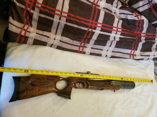

Saw this tip on another thread and yes .25 mags will cycle .22 pellets just fine, so amazing. This is a short barrel, believe it or not it brings the Royale down to 38.5 inches almost like a carbine in this setup.
Tape is hooked onto that silver air stripper thing.

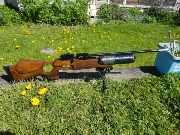

Looks great! I like it much better than the original because the original Royale's look like the barrels are a mile long...this just looks right to me. I would put a 4.5" Huggett moderator on there though if it were me...not just to make it quiet but as air stripper for added accuracy. I like the pictures...I would have fun picking off the dandelion flowers at 50 yards with that .22 for sure!
Your the best, Chuck
Looking good there Nathan, glad it's all coming together as planned. I think it'll look great with the factory moderator on it. It'll probably be really quite and a few inches shorter. Now you can go from room to room without bumping the door facing. Ask me how I know of something like that.. Can you pull the one off of your 500's barrel and put it on this one?
Jimmy
Unfortunately can't put any Huggetts on up here, and the muzzle flip won't work on this barrel either. The barrel doesn't end the same way my Royale barrel ends, I'm not sure what this barrel is off of.
I have a bunch of pellets from my .22 springer days to try out, Yeah Jimmy much shorter it went from 44 inches or so to 38.5, no muzzle flip either adding those last few inches combined with a 20 inch barrel.

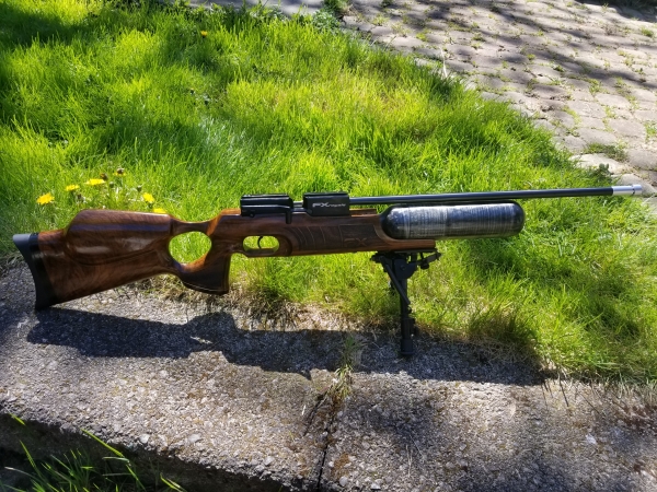

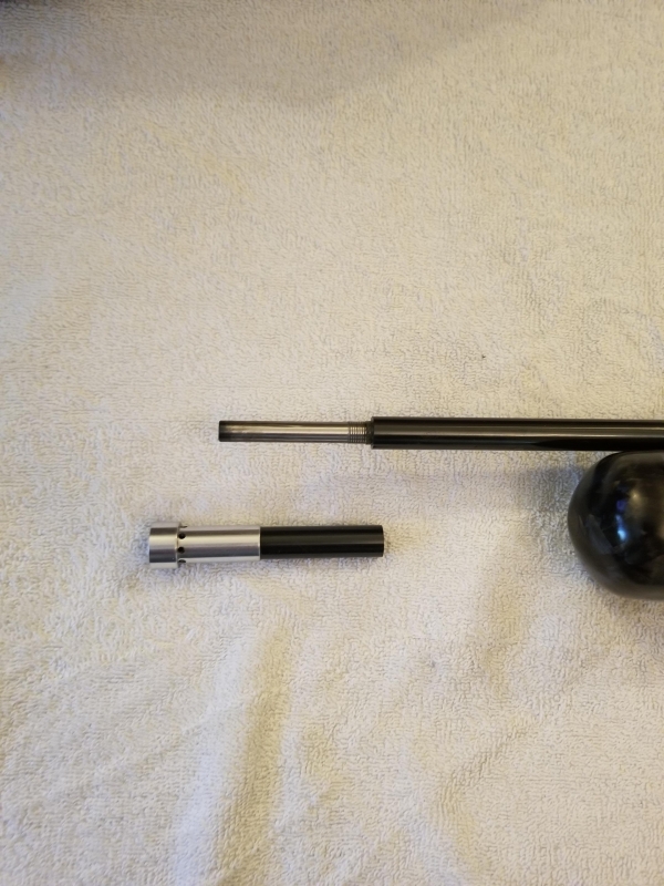

Is that a 1/2X20 thread that is on the barrel and would that aluminum piece unscrew from the other piece and if so I wonder what thread that might be? I bet some one could machine an adapter that would fit nice and snug to your barrel with a 1/2X20 on the other end so that you could use your Huggett or the factory shroud. Just thinking out loud..
jimmy
We get different stuff up here, moderators of any kind are not legal (remember Canada). So I don't have and can't use a Huggett, and as far as I know we never got a shroud on the Royale's just what FX calls a muzzle flip. The Crowns up here are shrouded I think but still differences.
Muzzle flip[/QUOTE]http://www.fxairguns.com/2011/09/muzzle-flip/embed/#?secret=4bgIZ22xz2
Yeah actually I bet the aluminum end cap would unthread and would reveal 1/2x20 thats a good point if I wanted to put a muzzle flip on there, I'm just gonna leave it as is for now, the looks don't bother me. Really looking forward to the chrony getting here see what kind of numbers I get from how it feels it doesn't need much HST at all to get good speed. I have the HST turned all the way down almost flush with the block and try and grease a rat or two tonight it's quite quiet at this speed whatever it is and goes probably 1/2-3/4 into pine which should be plenty for rat head shots.

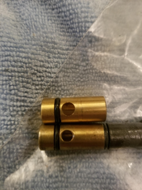

Chronograph FINALLY came in and able to check velocities, took 3-4 shots with each pellet with the HST almost maxed at 150 Bar reg pressure. The transfer port in the barrel seemed smaller than the second barrel inlet I have for .22, opened it up a bit but there's still room to open it up a bit more.

These numbers are with the small TP inlet here that I opened up a little already with barrel attached in pic. The new inlet from FXUSA has quite a bit bigger hole as you can see. I'll open the smaller in the pic a bit tomorrow.
These are both .22

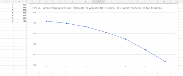

"mcoulter"Wow, thanks for sharing all this information. I was very interested in your JSB 18 chrony numbers. They line up almost exactly with mine after is screwed up the regulator adjustment and essentially make the gun shoot like an unregulated one. Disregard the BAR number above the graph.

Yeah that does overlap basically perfect, I'm amazed how accurate those 18gr pellets are it's been a while since I shot .22. I have some leftover 14.3 hollowpoints from my springer and man does this gun ever bark. I'm used to shooting it at the range with hearing protection, it sounds like a .22 rimfire!

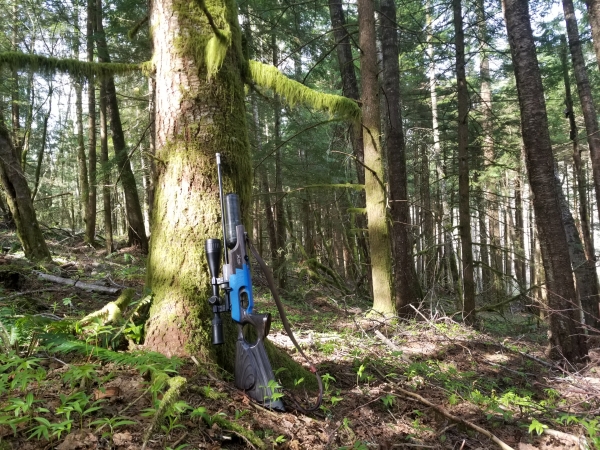

Got out in the woods today a bit didn't see any squirrels but was practicing shooting offhand and had a blast, got 3 sparrows (2 confirmed kills one just a fluff of feathers and managed to get away. All off hand at ranges from 10 to about 25 yards.
Put some masking tape on the stock I use for hiking to protect it a bit and keep it from rubbing on my backpack, so easy to shoulder with this short barrel. This area is a nice place that's within an hour or so from me but the wrong kind of trees for squirrels, spruce, cedar, birch and alder/cottonwood. Ah well still good to get some exercise and mountain air.

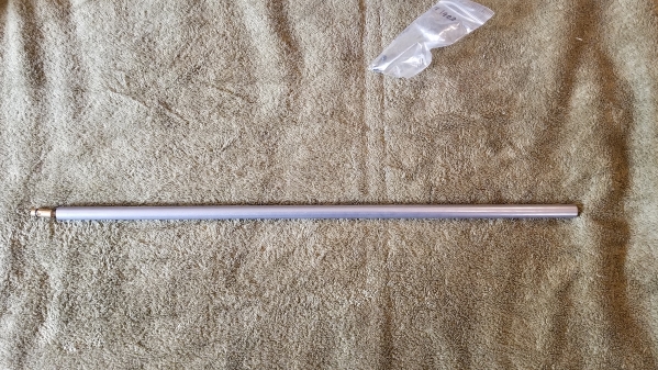

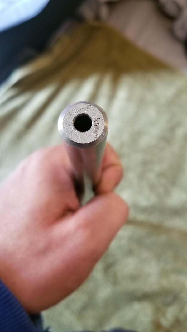

Well finally a bit of progress with what was my original intent to get a LW unchoked barrel to hopefully shoot slugs in .22. After paying for in February I had basically forgotten about the blank I ordered, many months later its in my hands all the way from ze fazerland.
German made LW polygon unchoked barrel blank in .22, it'll be a little while till i get it cut but hopefully it will be great.
