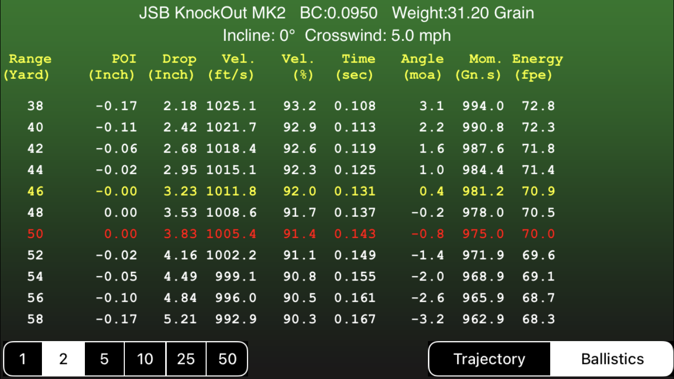

@Centercut may be on to something with the 50yd zero being too close. Here's an approximate snapshot..given we don't know what the real drag model in use..38yds to 58yds and the trajectory is +-0.17" which begs the question..how does one know if they're actually sighted in at 50yds when you have a 20yd window that is less than a slug diameter and the scope click resolution may only be between 0.125"(MOA) and 0.18"(MIL)? He could have a scope with 1/8 instead of 1/4 MOA clicks..IDK.

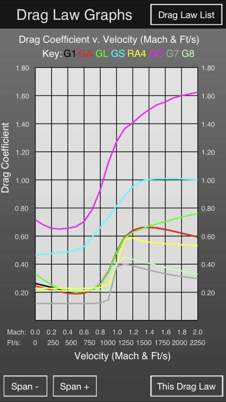

and here's a screen shot of all the drag models in Chairgun..curious they're all doing something interesting at around 1100fps..

OK, you mentioned the new drag models that ballistician Miles Morris calculated specifically for airgun slugs.
They are published on GTA and also here:
If you want to use them, this new ballistic calculator offers it, along with:
GA | GA² (domed pellet drag profile by Miles)
G1 | RA4 | GS | G7
