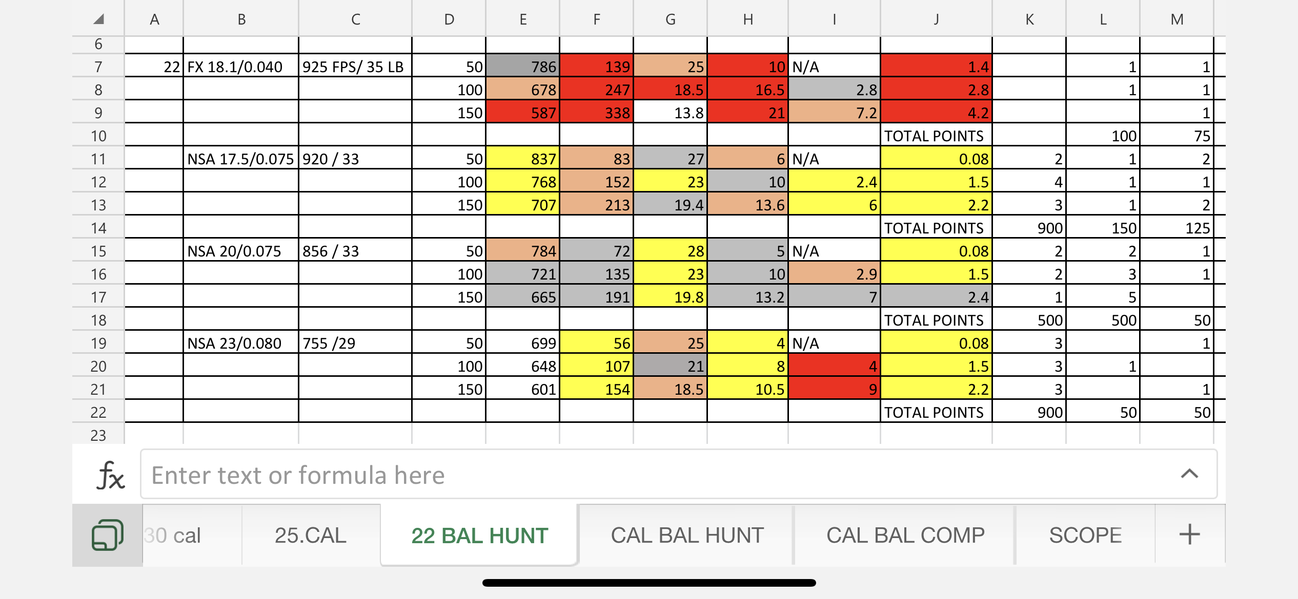

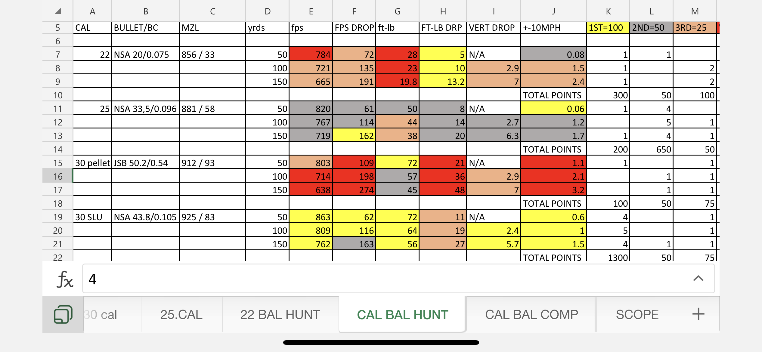

The reason for my question is because of the following test I did with my 22,25& 30 all this velocities were confirmed.
I’m going on a hunt and have meaning to do this test. As you can see the results are a little different from what we’re told
Check how much the 30cal at 100 yards do.
The 22 pellets at least for my rifle are completely out of the question.
Sorry I like spreadsheets.
Yellow = 1st choice
Grey = 2nd
Brown =3rd
Red = worst
At this point the 25 and 22 are winning due to the size of the rifle and performance just need to do an actual test.
Yellow = 1st choice
Grey = 2nd
Brown =3rd
Red = worst
At this point the 25 and 22 are winning due to the size of the rifle and performance just need to do an actual test. View attachment 296592View attachment 296593

On my way to a hunt I’m limited to a smaller rifle as my primary weapon is a Recurve, so I’m packing light, the 30 cal is out of the question.
I’ll be looking for your help on my quest
So far the 25 cal is winning

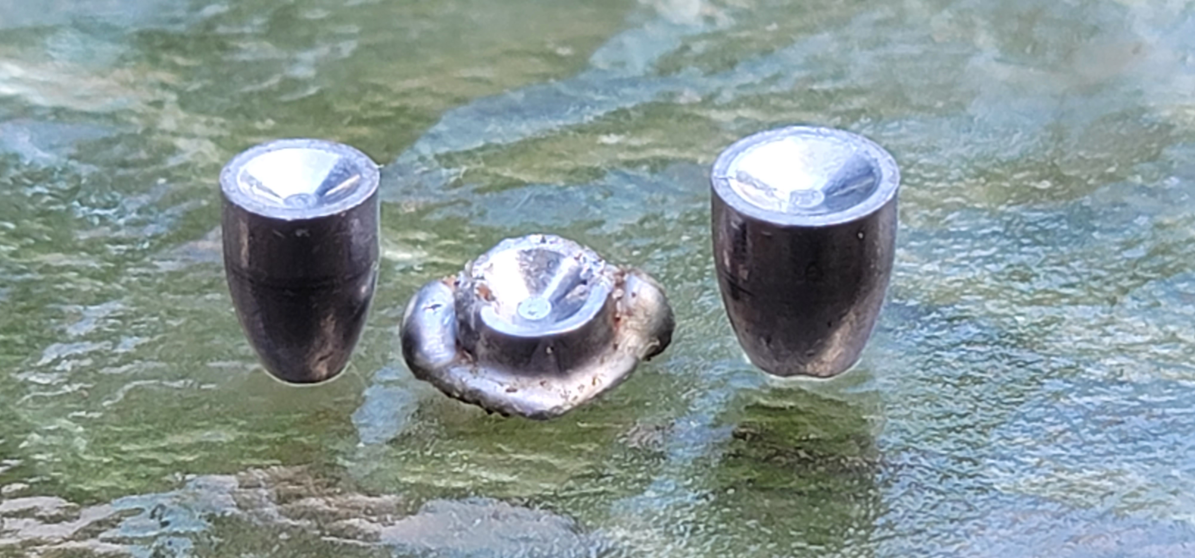

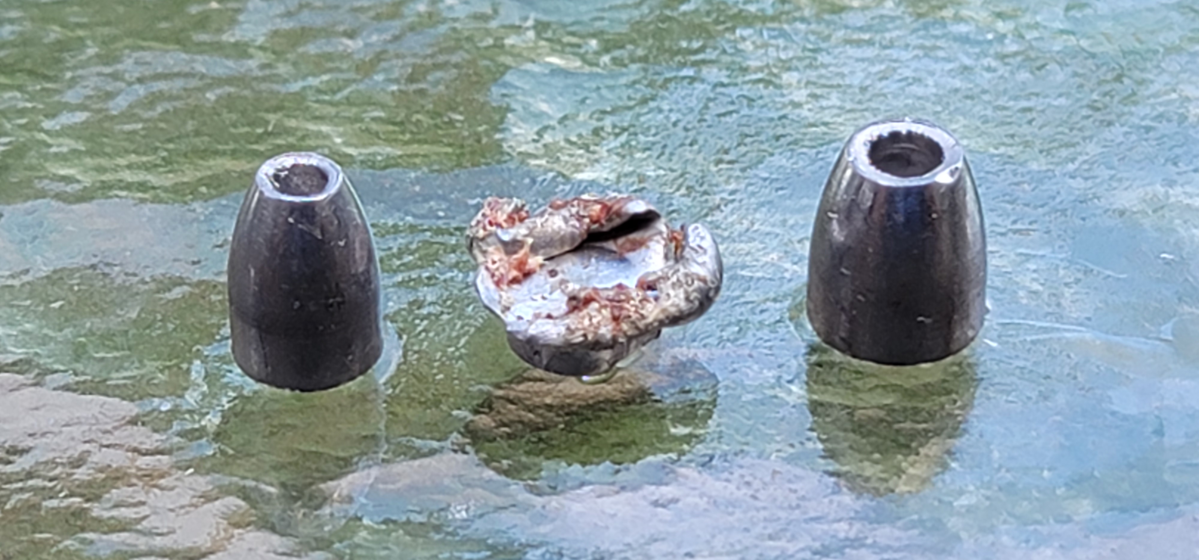

Thanks, I'm glad you enjoyed it.
I have to melt down the Ballistics Gel again and redo the test with my Maverick VP .30cal. Currently I'm head over heels in love with the Hybrid Slugs. Here is a photo of a slug recovered after a full passthrough on a groundhog. Here is a video of the shoot.
The slug expands better than any I've ever shot!
Left to right: Fx Hybrid Slug .30cal, Recovered Hybrid Slug .30cal, FX Hybrid Slug .357cal for reference.
