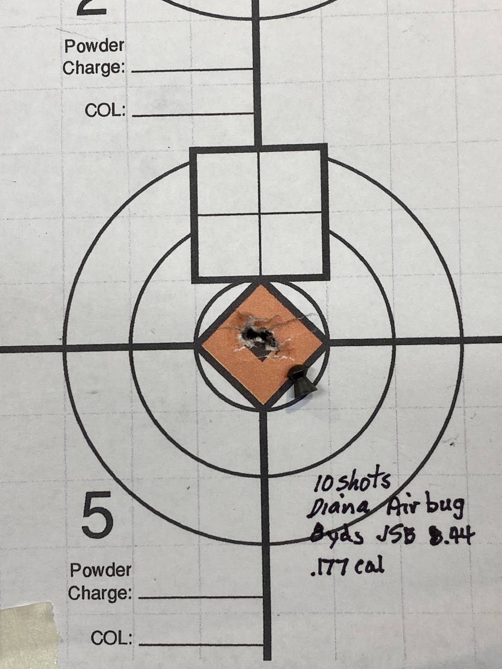

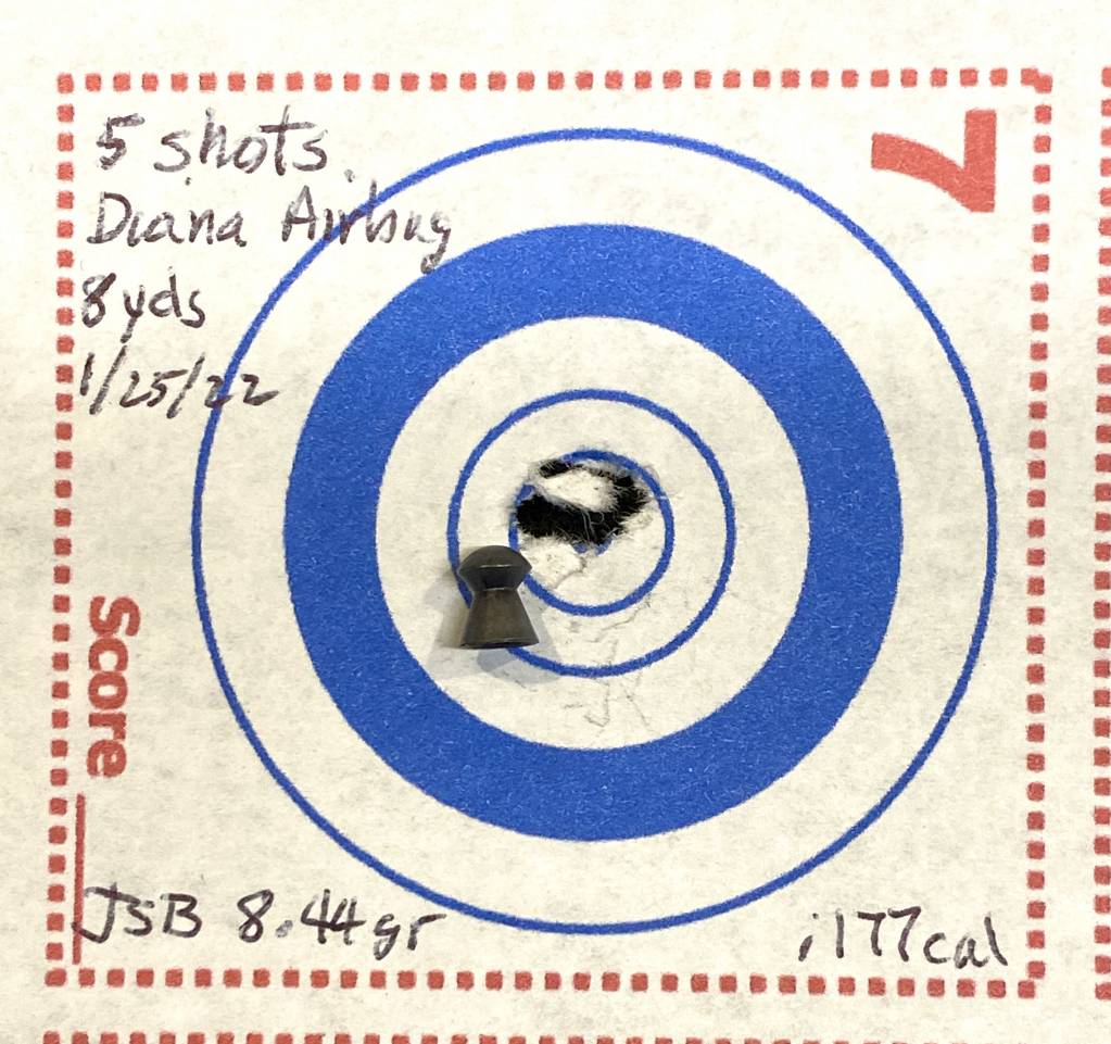

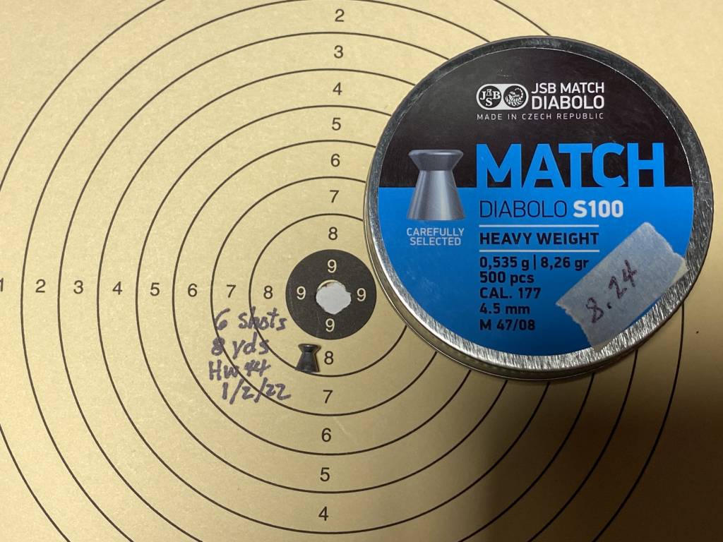

The Following pictures were taken after I "rediscovered" my proper handhold for pistol shooting. I don't always get groups like this, but then I didn't always get good groups when shooting powder burners in NRA Bullseye, either.

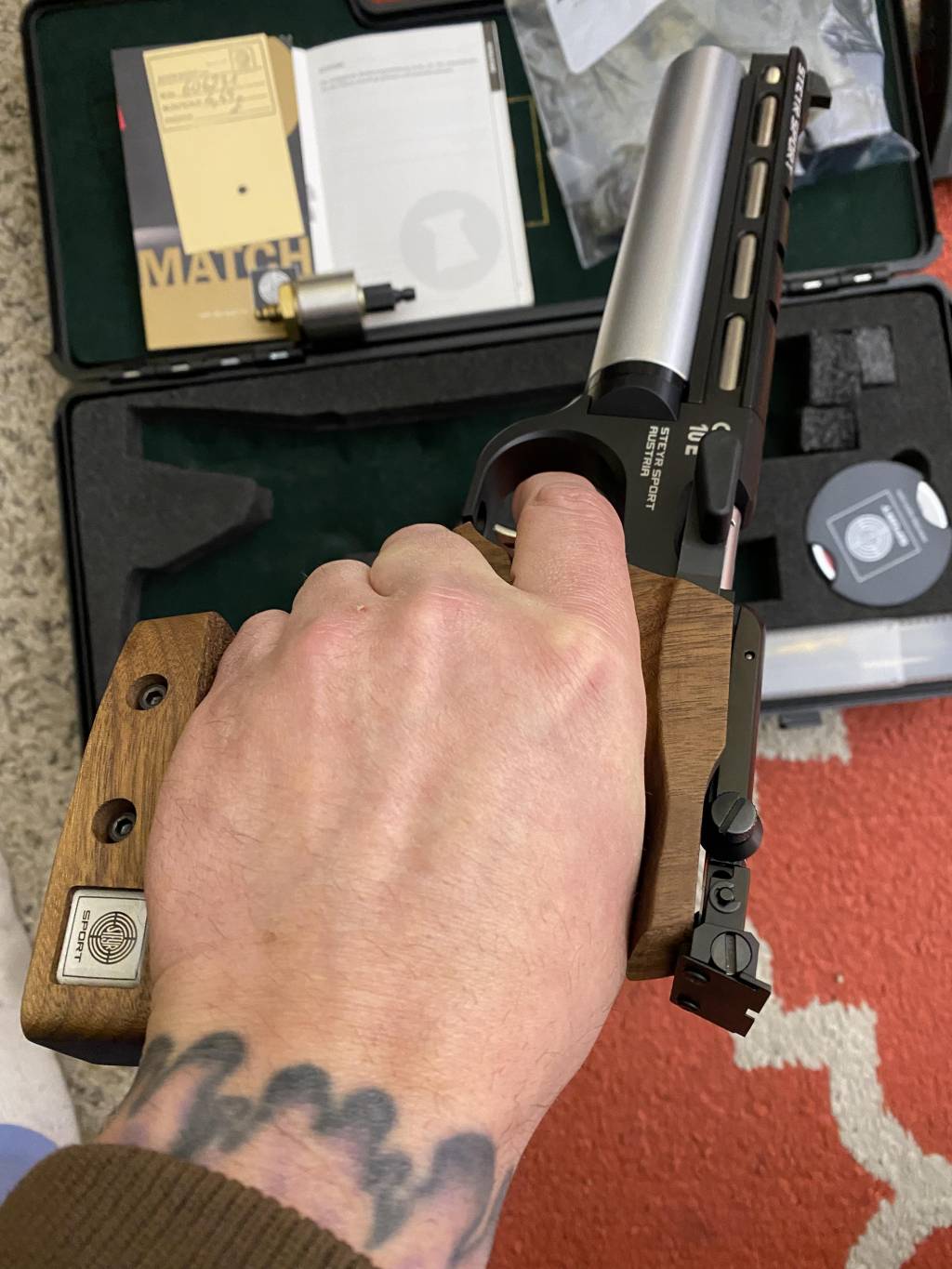

I'm going to have to try my EVO-10E at 8 yards off hand, bag rested. See how I do in comparison. I have it set up for 20 yards.
I very well may keep this if I impress myself or anyone else lol. Was thinking about selling it but let's see if rsfrid's post inspired me enough. Thanks for the honest post.

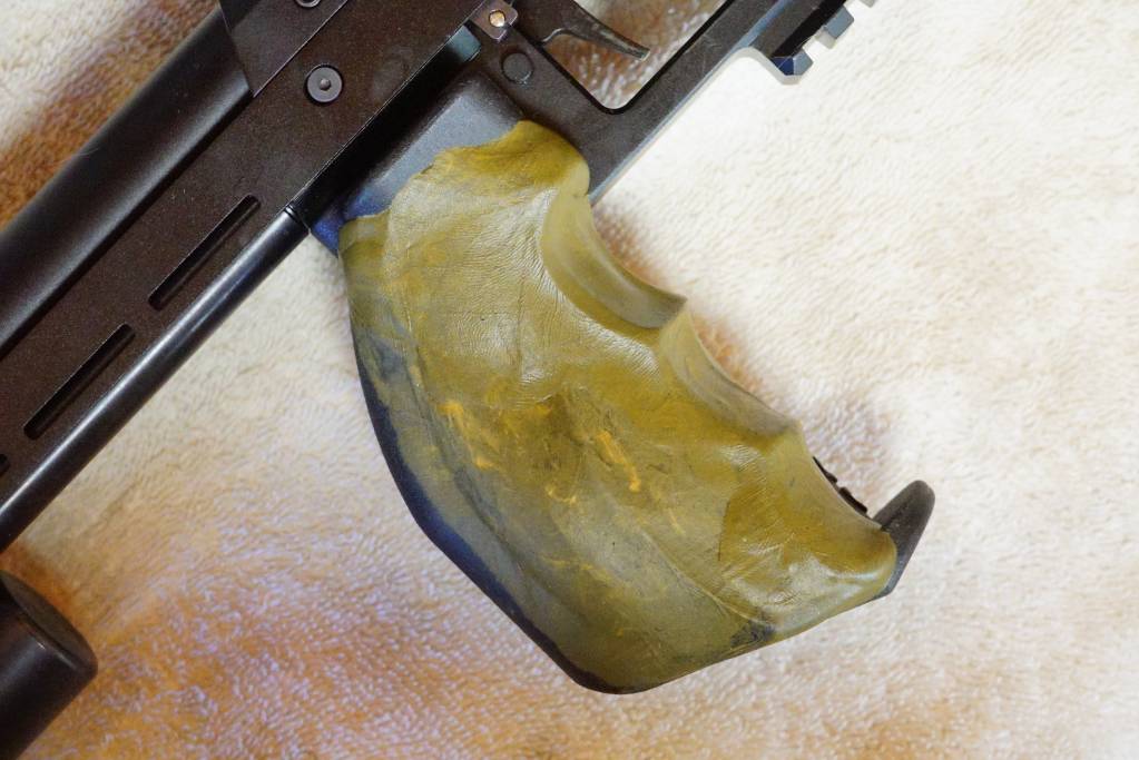

Because of my slightly larger hand size, I've modified most all of my guns grips to better suit my hand, in one way or another.
