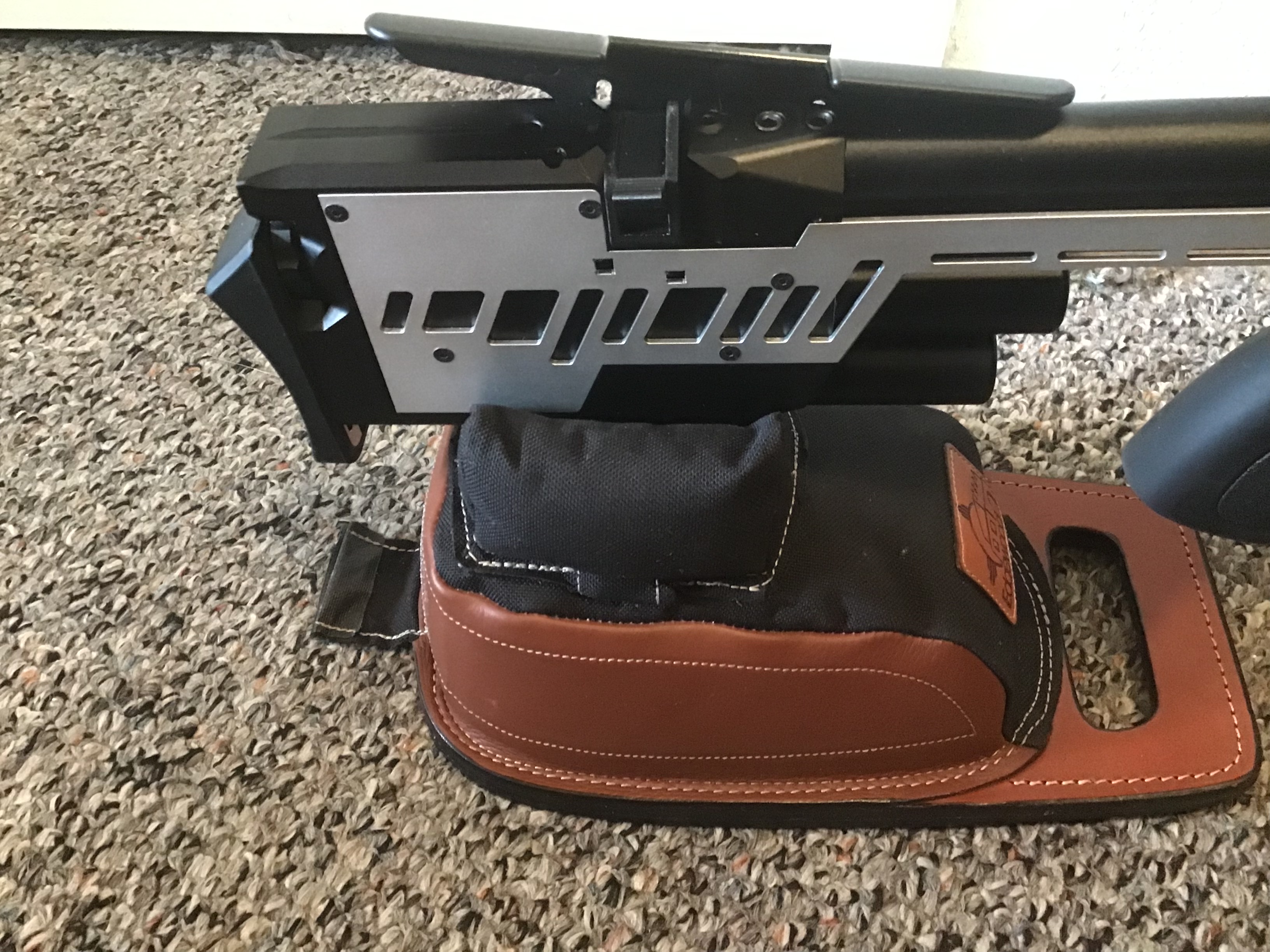

I have the P3, and i am not certian if the dimensions for the rear of the P 2.1 is the same as on the 3
I am able to place the rifle on a rear rest and it glides very smoothly
I didn't want the additional height with the rider...though i can see in cases where that is wanted
