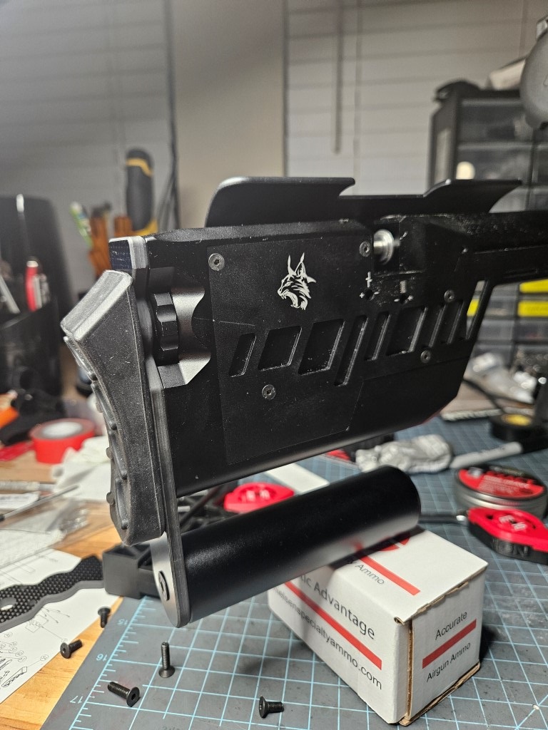

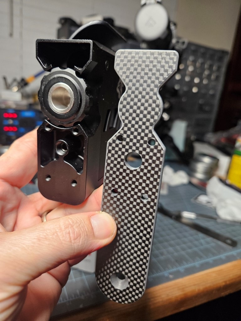

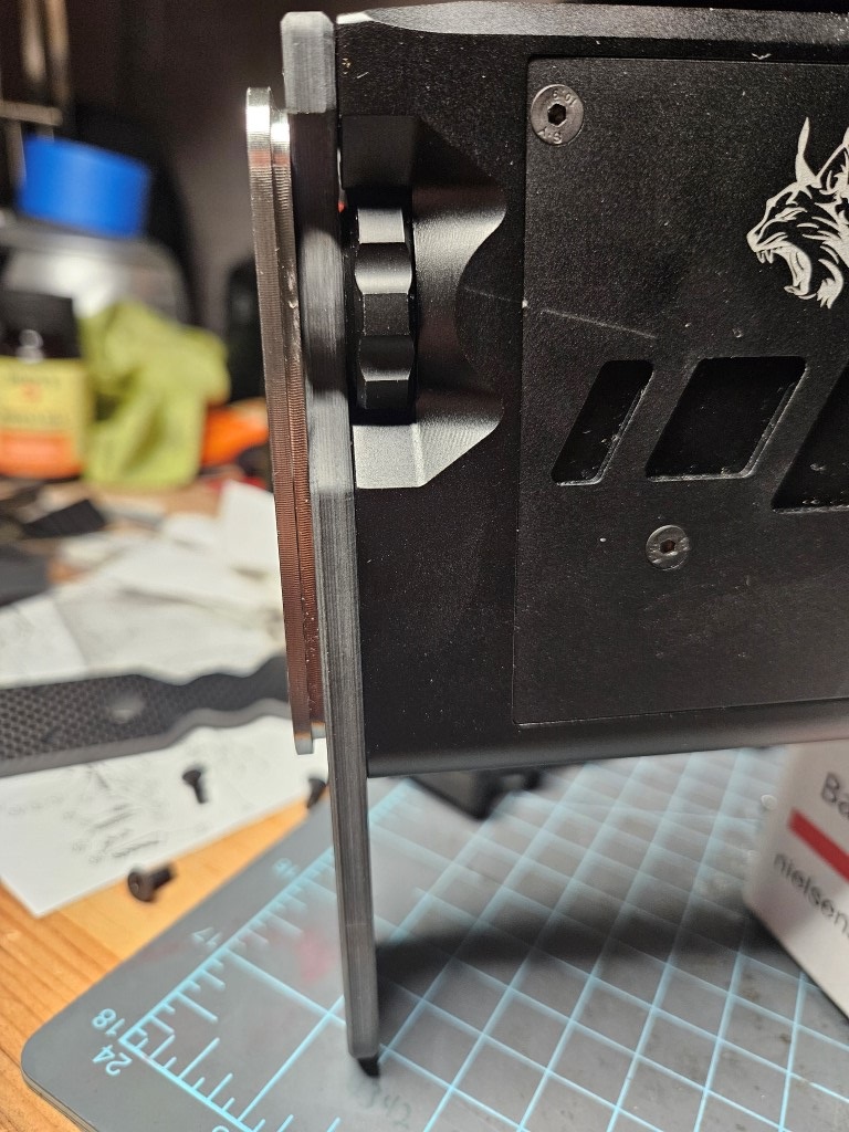

I cut a small batch of Prophet 3 bag rider adapter plates from 5mm carbon fiber so that P3 owners can still use the P1/P2 bag rider tube.. They are 1mm chamfered on both sides for safety & comfort.
I'm going to call Tony @ Talon Tunes tomorrow to see if he wants the extras I cut. If anybody wants one immediately I just need to cover my cost ($10)+ shipping. I only have screws for 2 plates. You will need M4 x .7 thread in 15mm length. Hardware stores like Ace only carry them in 12mm and 16mm length. The 12mm is to short and the 16mm is 1mm too long. I had to grind about .75mm off the end to get the screws to tighten down.

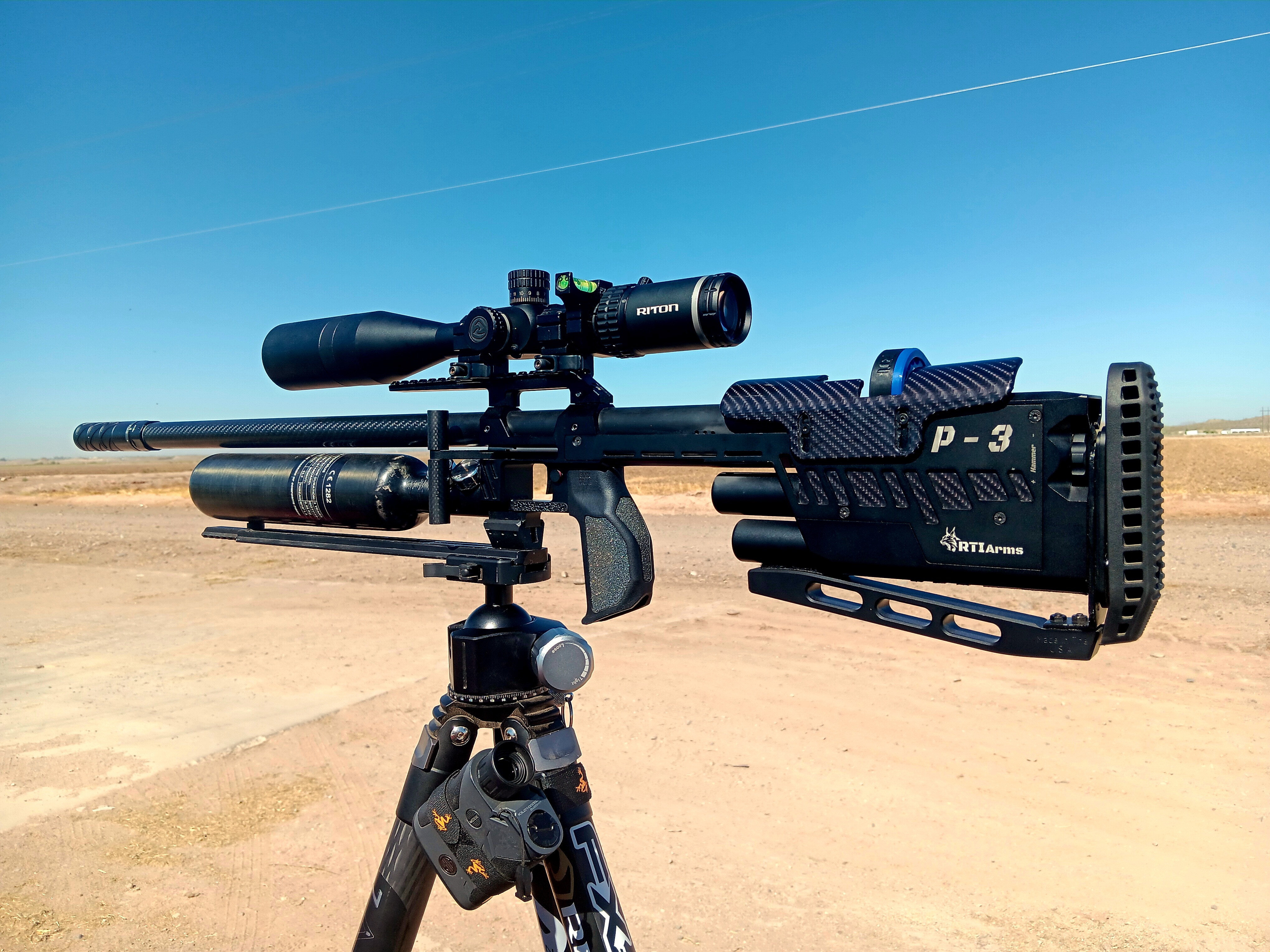

Adapter Plate and Bag Rider Installed

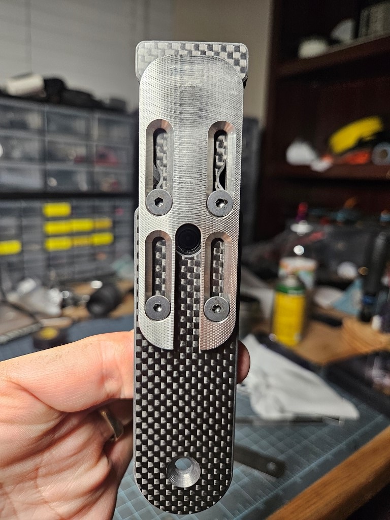

Plate follows the rear block shape with easier HST wheel access and maintains access to the bleed screw.
Adapter plate is mounted using the existing butt plate
