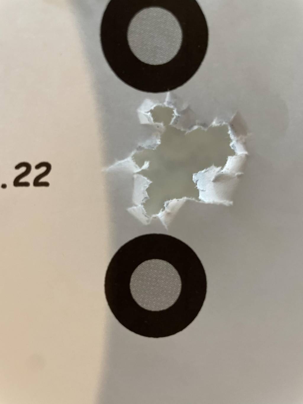

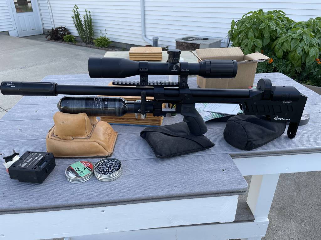

Took delivery of my .22 Compact Prophet today. Did a quick barrel cleaning and slapped on a 6X SWFA and put some lead through it. It came set up with the reg on 120 bar and HS flush. It’s shooting 18 JSB’s at 875 with a 2.8 SD and 16’s at 923 with a 3.0 SD. Shot count, at the OEM tune is 58-60 where it falls abruptly off the reg. I really wasn’t shooting for accuracy yet because I wanted to let the reg break in and barrel season and was more concerned with seeing what kind of shot count I would get. I was shooting off a Protektor bag in the front and squeeze bag in the rear. However, accuracy was surprising great. This is 60 shots through the same hole at 50 yards!
My initial observation is the 18s are likely more accurate at least at this tune. The 16’s were pretty squirrels at the higher velocity. I will likely leave the tune alone for a while until I break it in.

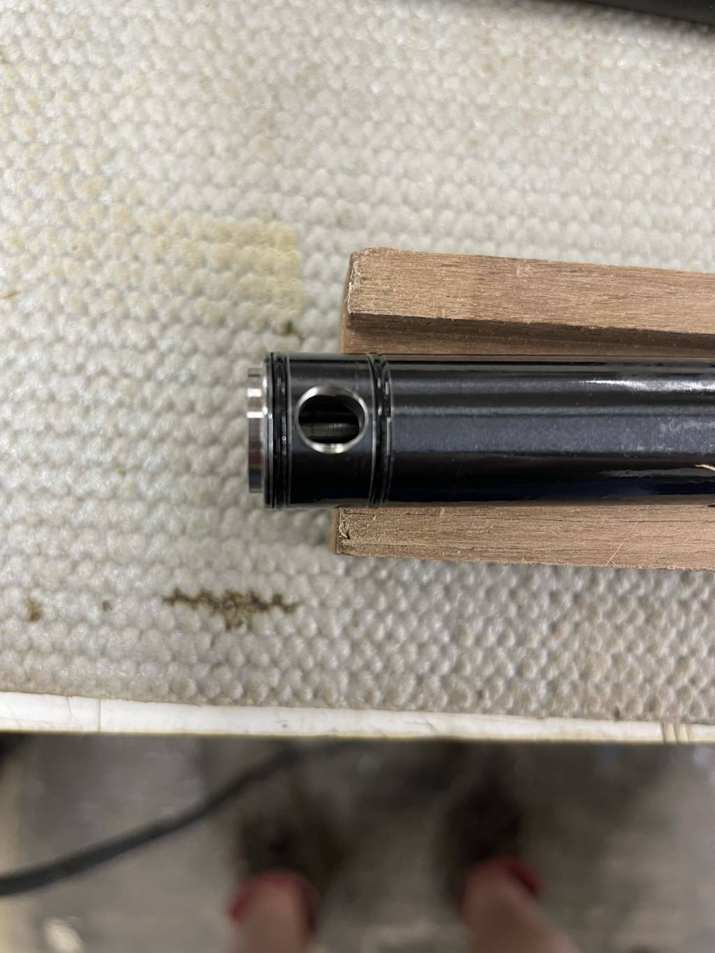

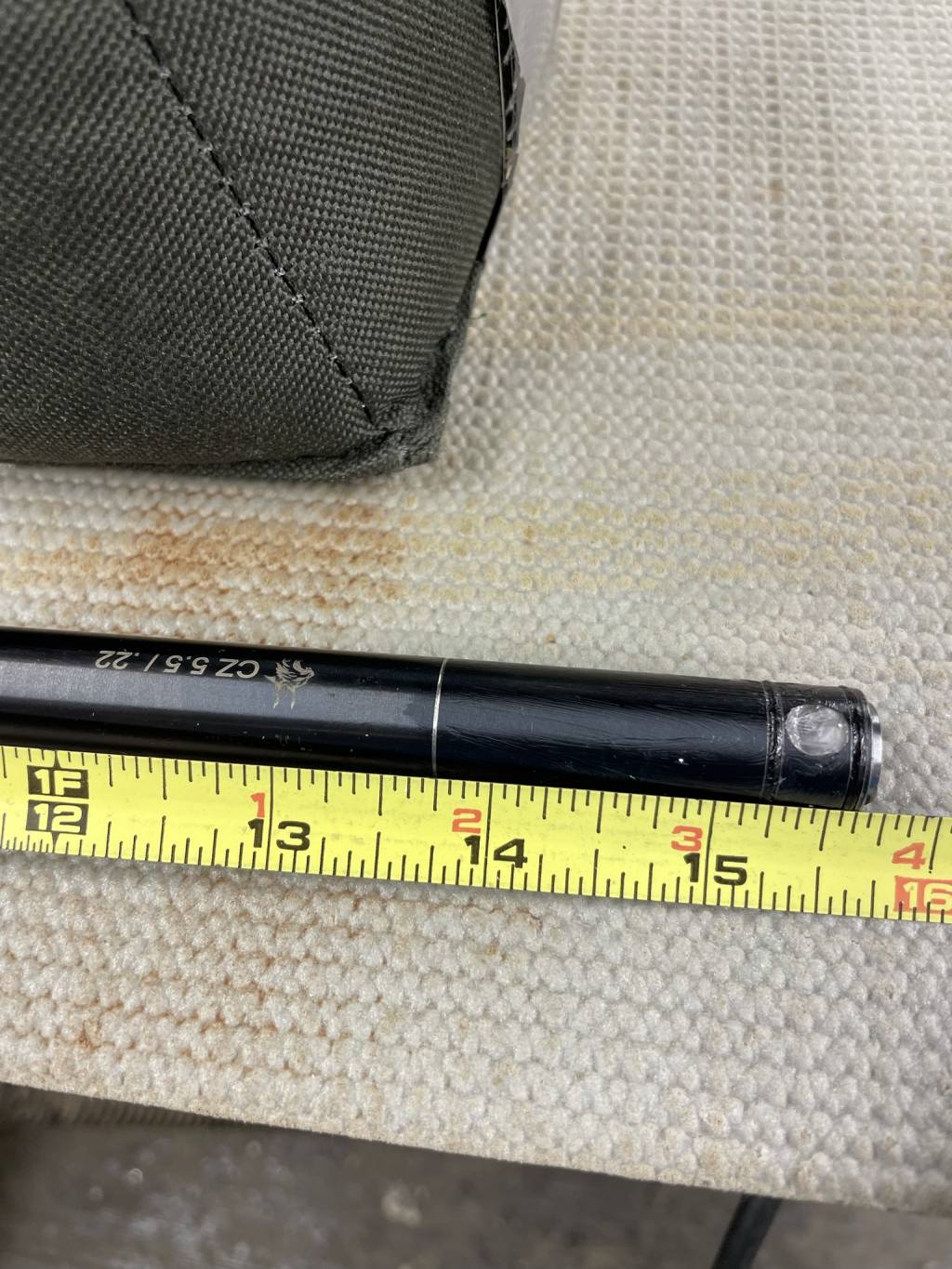

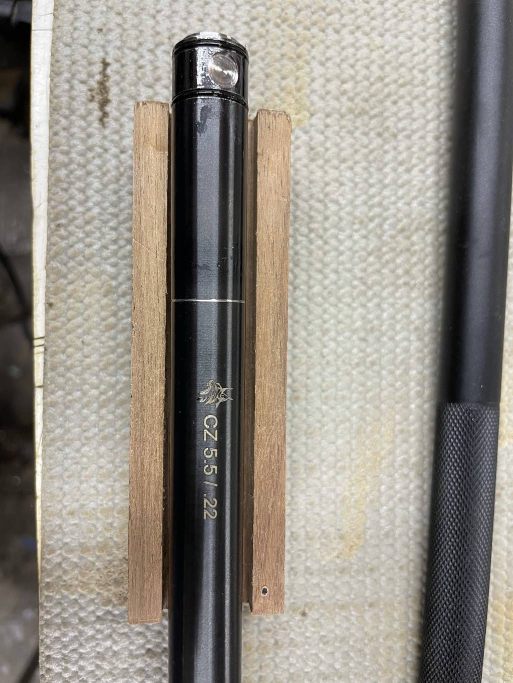

The Compact’s barrel measures 15-3/4” long and it’s made by CZ specifically for RTI. A notable change over the full size Prophet LR’s barrel is the port has been elongated and polished on the Compact whereas the LR’s barrel is just a single round hole.

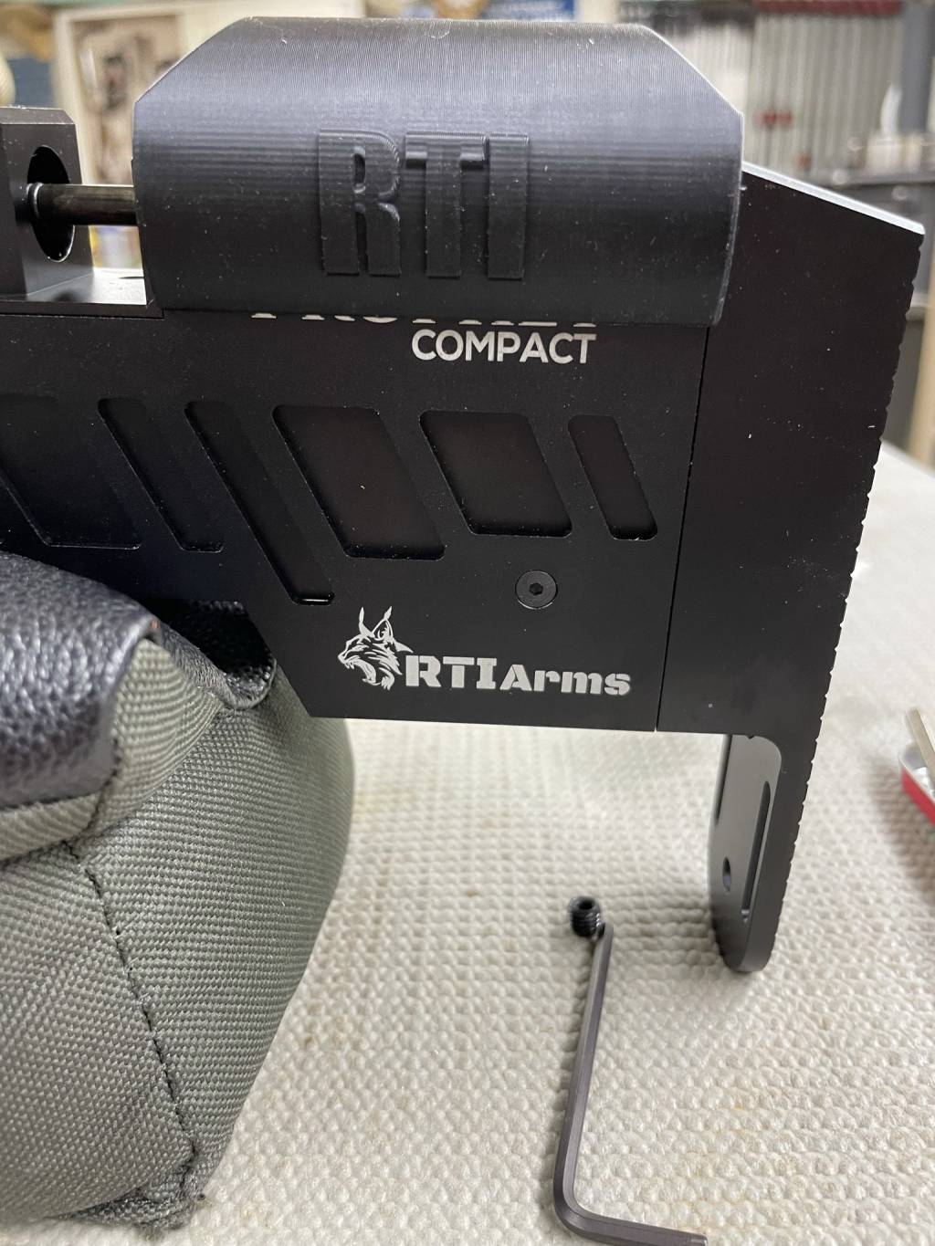

Another subtle change is the rear action appears to be a bit shorter on the Compact. I’ve added a 3-D printed cheek rest to both of my prophets and I noticed it hangs over the rear a tad on the Compact where it’s a precise fit on the full size Prophet. The cheek rest is the single best modification I’ve done to my Prophets. It is MUCH easier to make a repeatable cheek weld with the rest than without it because I never could find a way to get a consistent cheek weld by resting my cheek on the rear action “bevels”.

Someone PMd and asked about the cheek rest. I bought it on FleaBay. It comes mailed to the US from the UK in 2-3 weeks. I wish someone here would come up with one (Orion?), perhaps? It’s supposed to be a friction fit but mine moved around more than I liked so I put a small piece of double sided carpet tape under it and it’s solid now. I HIGHLY recommend it?

I noticed you are using some high rings on that setup
Yes, they are FX No Limit rings. I had a dilly of a time zeroing the scope this afternoon until I realized the rear bolt was not tight enough and not holding the rear scope elevation tight. Every shot the scope would move vertically and I burned a lot of lead chasing my tail until I realized what was going on. Put a smidge of oil on the bolt threads and it tightened up just fine.
