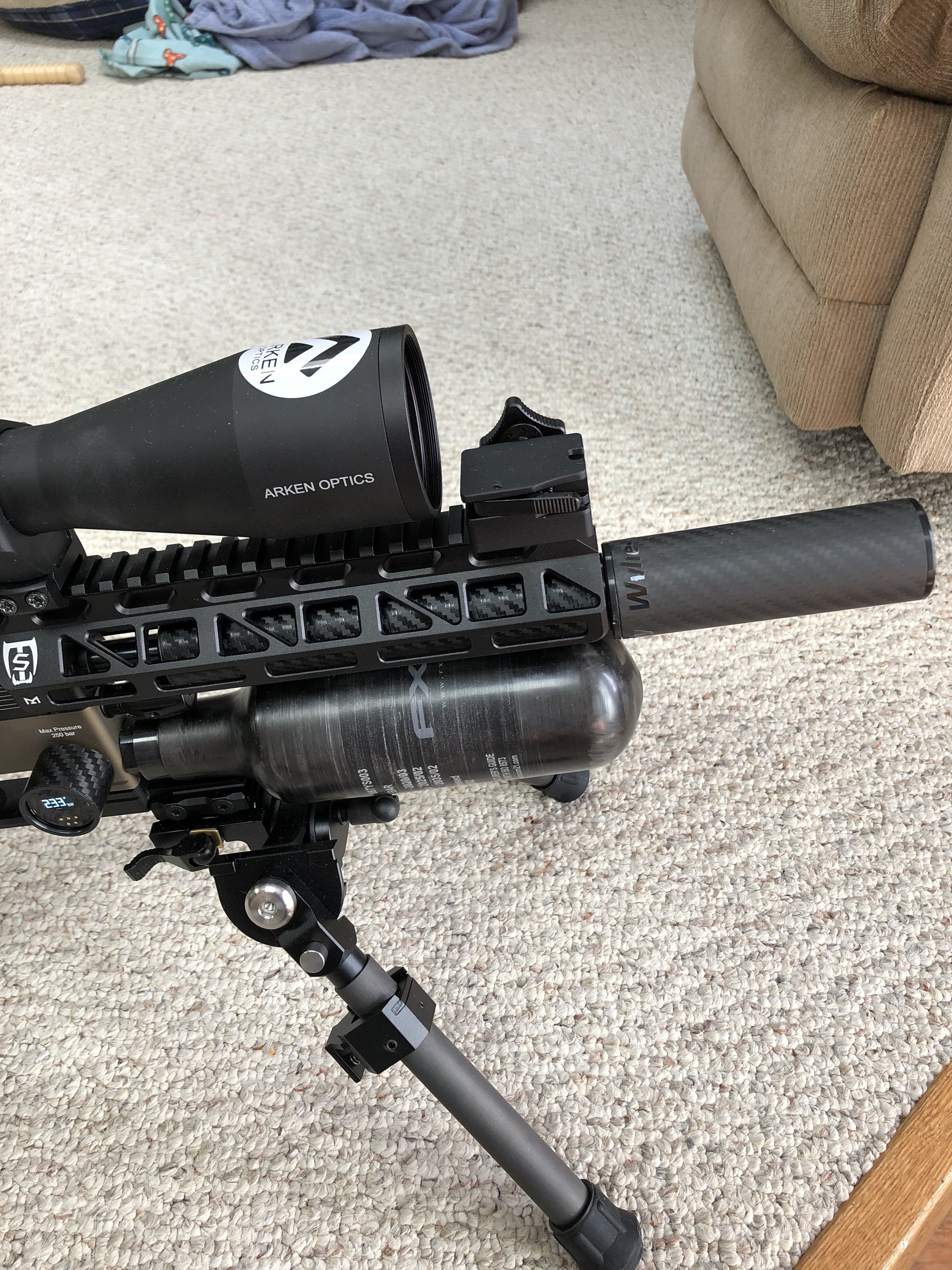

mine was nice and quiet i was also able to fit a 480 fx botle with a wylie silencer
Reactions: Jasonmc
