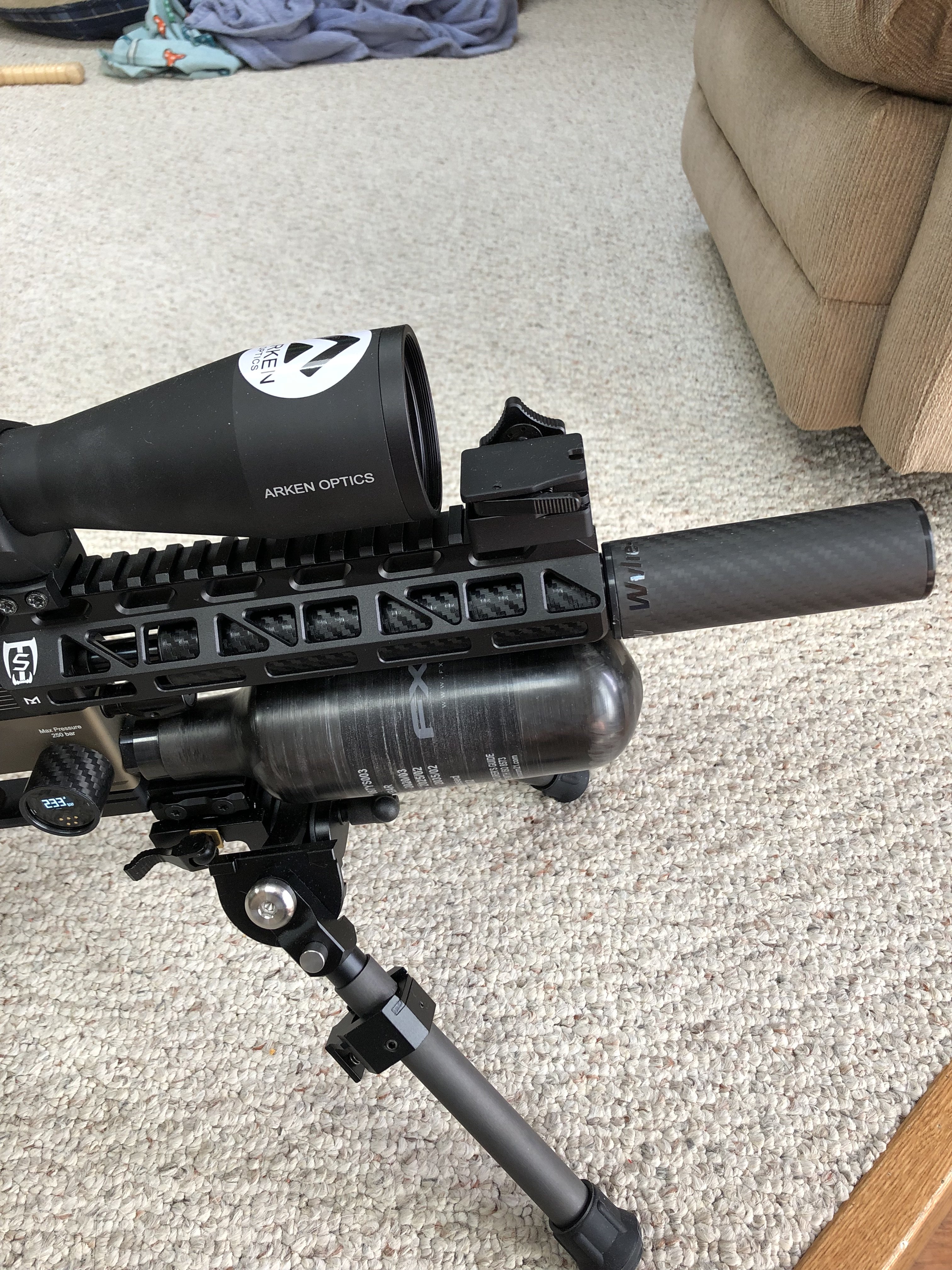

Just get a hand pump. I pump mine all the time and the small tank makes it easier to top off. I actually left me hand pump attached during one range session so I could top off without having to pump back up to tank pressure. I added a huma bottle reg so I only pump to 250 bar. I also clipped a coil or 2 off the hammer spring to give the hammer a little free flight to help efficiency.
Compressors and dive tanks will make you soft. Hand pumping keeps you young. Ha
Do you mean that a small 220cc tank on the gun requires less total pumping to produce say 50 shots, than a large 500cc tank?
Very interesting! 👍🏼
Please, would you explain the reason? Does this move the bottle forward? Does this allow you to switch bottles without degassing?
