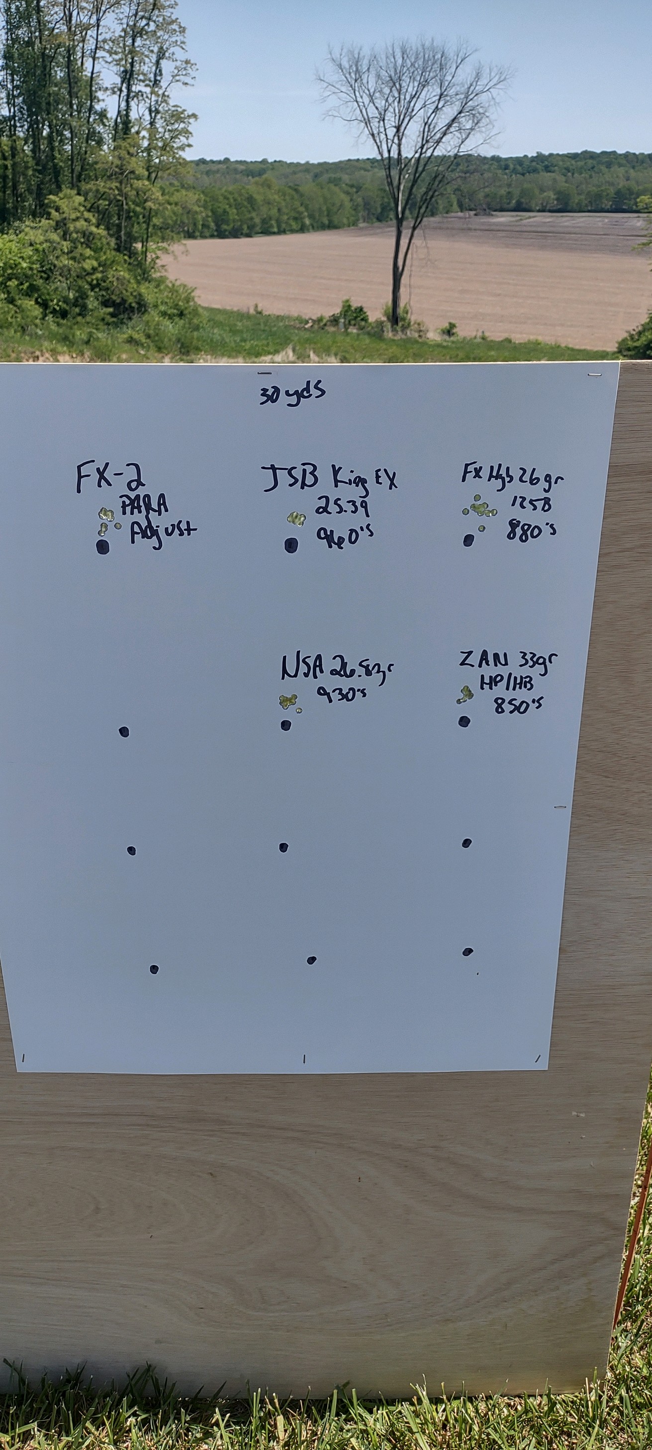

Did some leg work with mine today. Didn't shoot for groups as it's intermittently windy then dead calm. Also bear in mind that this rifle isn't broken/settled in yet, even with todays shots I still don't have 250 total shots through it as I was waiting on these plenum additions. There are two FX slug groups as I spaced adjusting the parallax for the closer target and chrono work. Came set from dealer at 125 BAR reg pressure. Rifle is 25 cal Performance model.
I don't really expect to see too much of a change until I go up on reg pressure, do get more shots per fill now obviously.

FX Hybrid 26gr Mk II .250 dia. (shot first and last slug groups as forgot to adjust parallax due to brain fart reasons)

The slugs need more speed, but had I been set up for groups it looks like everything, but the FX would have been one-hole groups minus the odd flier with the NSA.
Also looks like the more I shot the more the reg and pressures settled and as I said earlier it isn't broke in yet.
