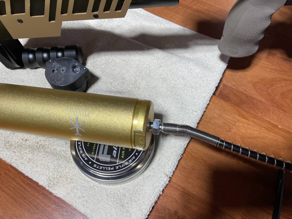

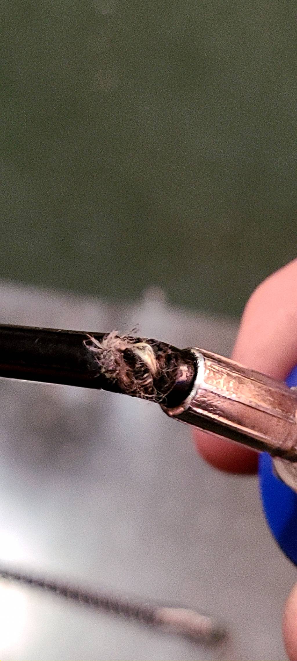

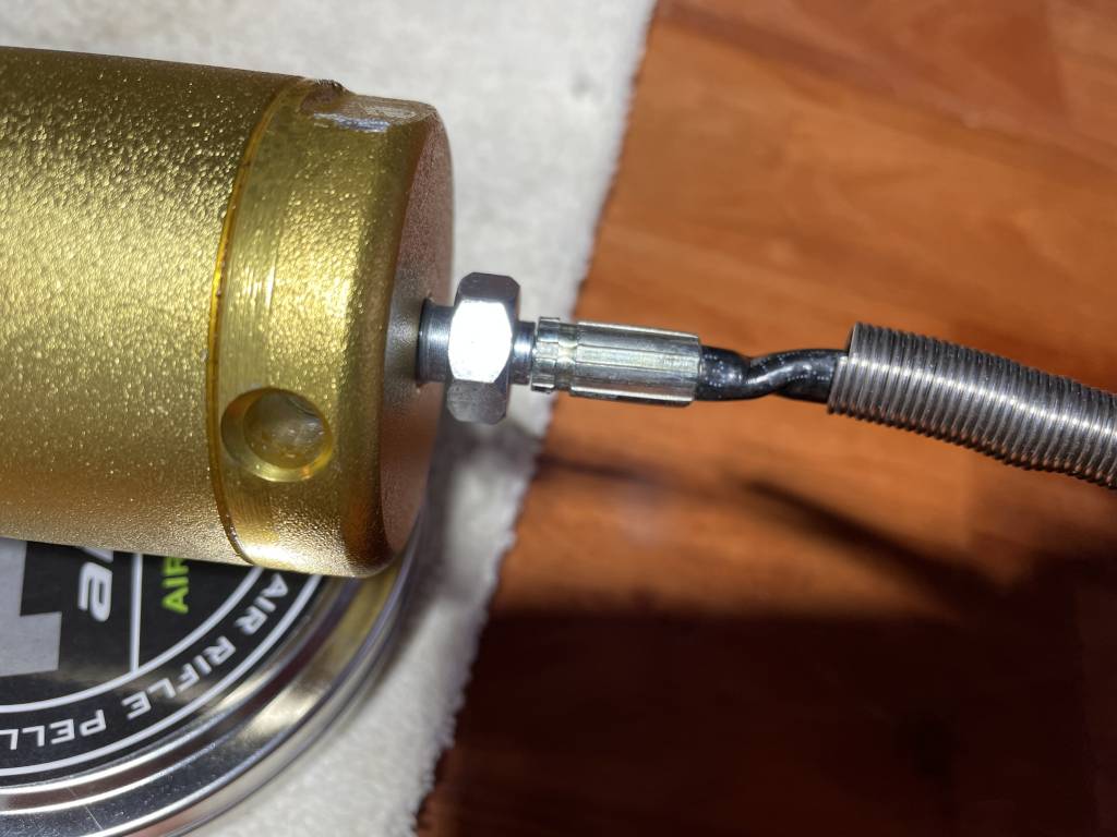

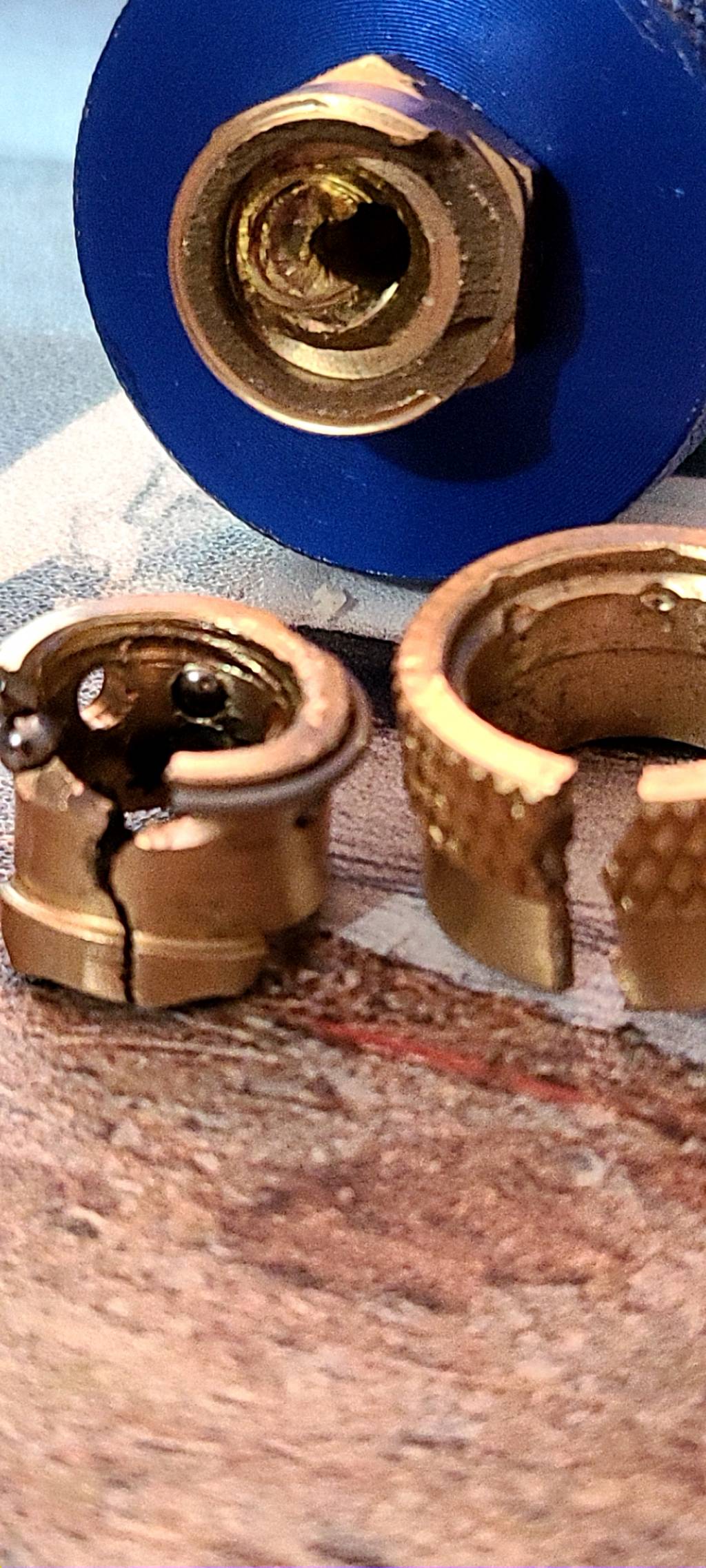

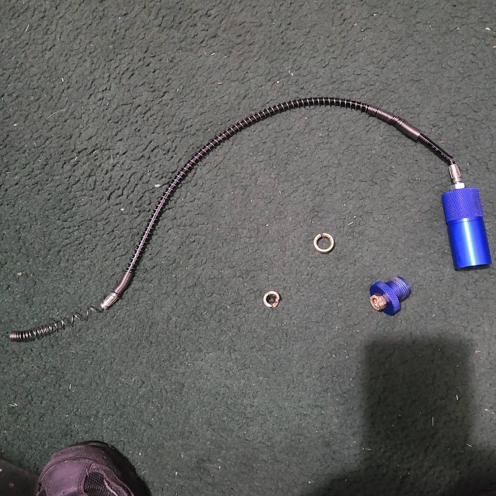

This is what happened to me a couple of weeks ago. I bought a new .25 Avenger and a chinese 4 stage hand pump on ebay. On the second use, at 3500psi, it sounded like a grenade. It took a solid week for my hearing to recover. I don't know what failed first, but the female QD was broken and still attached to the male fitting on the rifle. The male fitting was bent. The filter canister threads had pulled out. The hose had a hole in it and the hose ripped the fitting at the pump apart. Then something hit my leg. It took 14 stitches to close. So this was not a bottle or pump. The hose failed. I am now buying an electric compressor and will either build a cage or stand behind something substantial during operation. And use a steel foster fitting, not the brass used on the chinese hand pump.

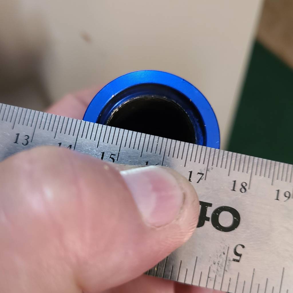

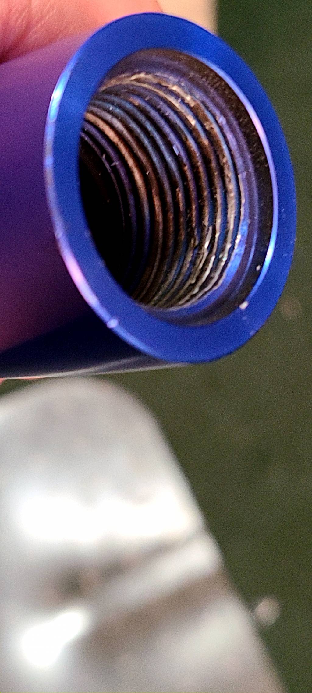

Would you be willing to share a photo looking toward the inside of the blue "filter."? I'm curious of the wall thickness.
It looks like it failed in multiple places, the female foster on the blue filter, as well as the threads holding the cap on the filter.
I use a similar oil/water separator type filter downstream from my Shoebox compressor, so you've got me concerned.
Sadly there has been more than a few reports of near misses and catastrophic failure like this, I'm glad you're ok dholder. Sadly the common theme in these reports is inexpensive no-name or knock-off equipment sourced from Chinese sellers such as Alibaba or E-Bay. Your story is another great example of a skewed risk rating between expensive trusted name equipment and inexpensive no-name equipment.
I hope your story and shared images serve as a warning to others who may lose life or limb in saving money on quality safe equipment. These pressures are not a joke.
