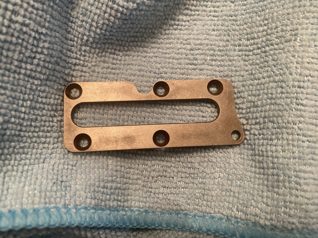

a) Interference is felt, the bolt / probe gets hung up in one or more places. Remove the magazine rotation mechanism and re-test for interference .. this is the component:
i) If interference IS NOT felt, this component is likely the problem. Inspect it:
- Check for burrs / gouges / rust / rust pitting on the part
- Make sure it's not warped
- Ensure it's torqued back down evenly
ii) Interference IS felt:
- Visually inspect the bolt / probe for marring
- Strip down the action and remove the bolt

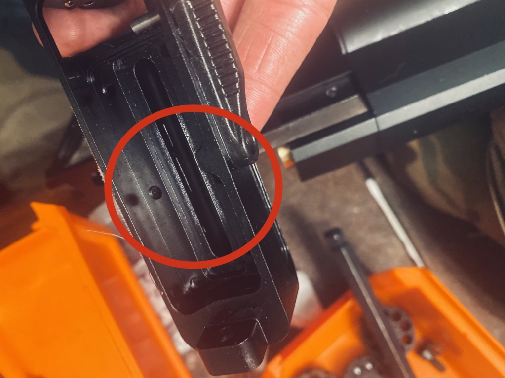

- Check the inner bore of the block that the bolt / probe slides back and forth in for scratches / gouges! If present, this is your problem!
This is an example what I mean:
The bolt is machined precisely to slide back and forth in the housing. Any scratches, nicks, or imperfections to that bore and/or the bolt are going to cause problems. You need to be very careful not to make the problems worse, but to resolve the sticking and rough charging issues - it has to be dealt with.
Polishing the bolt / probe - fortunately, there is an M5
I avoid sandpaper and use a very light polishing cloth. Do not remove a bunch of material and shrink the overall diameters!
As to how this happens in the first place - there are a few ways that small particles / debris can enter the bore that the bolt rides in. That debris can get mixed in with the (heavy) factory grease, and in turn forms an abrasive mixture that can chew away at the anodization and ultimately the aluminum block.
