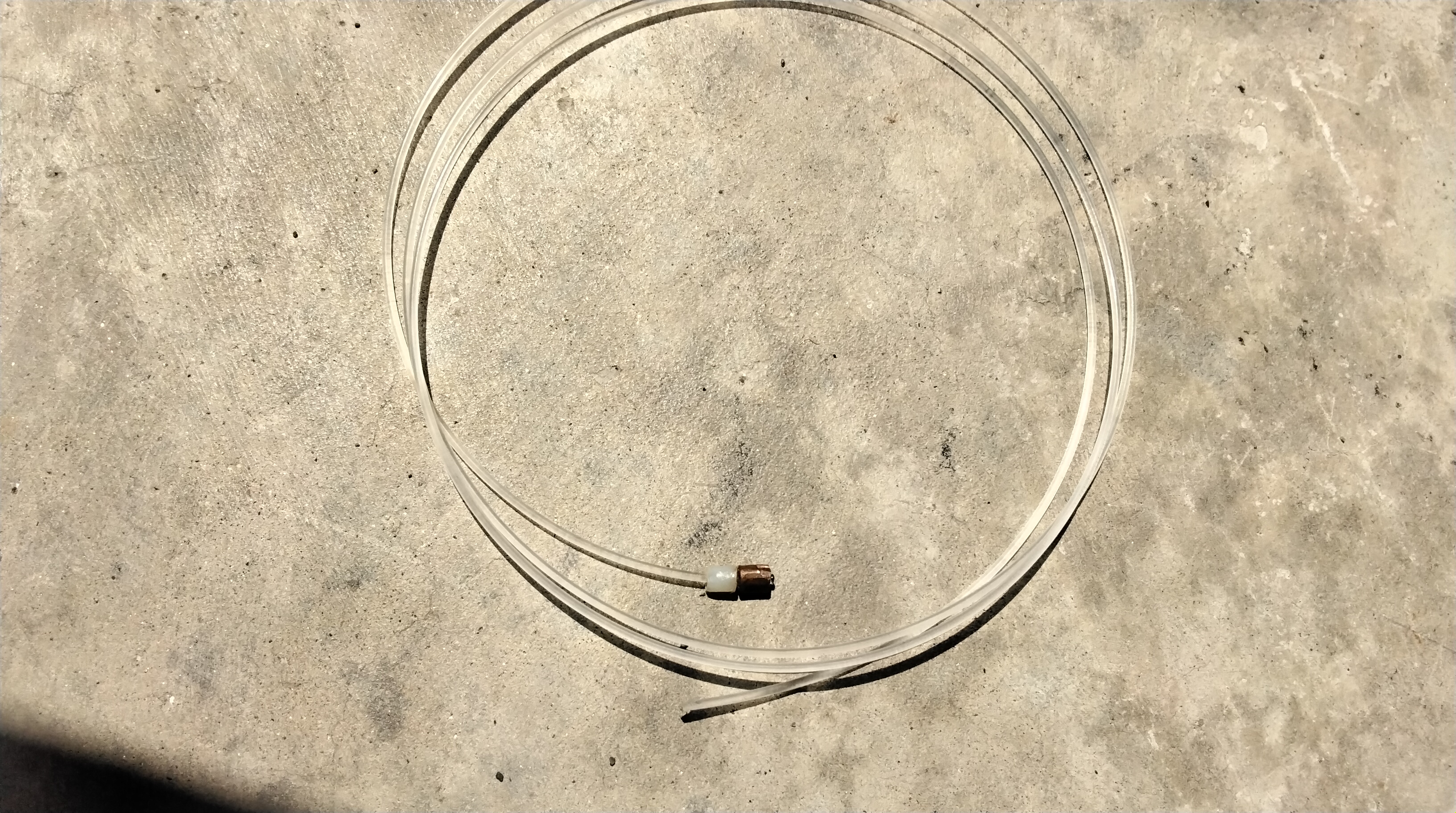

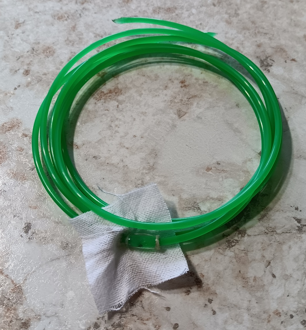

I make my own with weed whacker replacement line & a small, copper, single hole crimp at one end. You can make them as long or short as you want. REALLY simple to make & saves $ too. Even though the copper crimp is softer than barrel I put a small nylon spacer in front of crimp just to be safe.

I make my own with weed whacker replacement line & a small, copper, single hole crimp at one end. You can make them as long or short as you want. REALLY simple to make & saves $ too. Even though the copper crimp is softer than barrel I put a small nylon spacer in front of crimp just to be safe.View attachment 453697

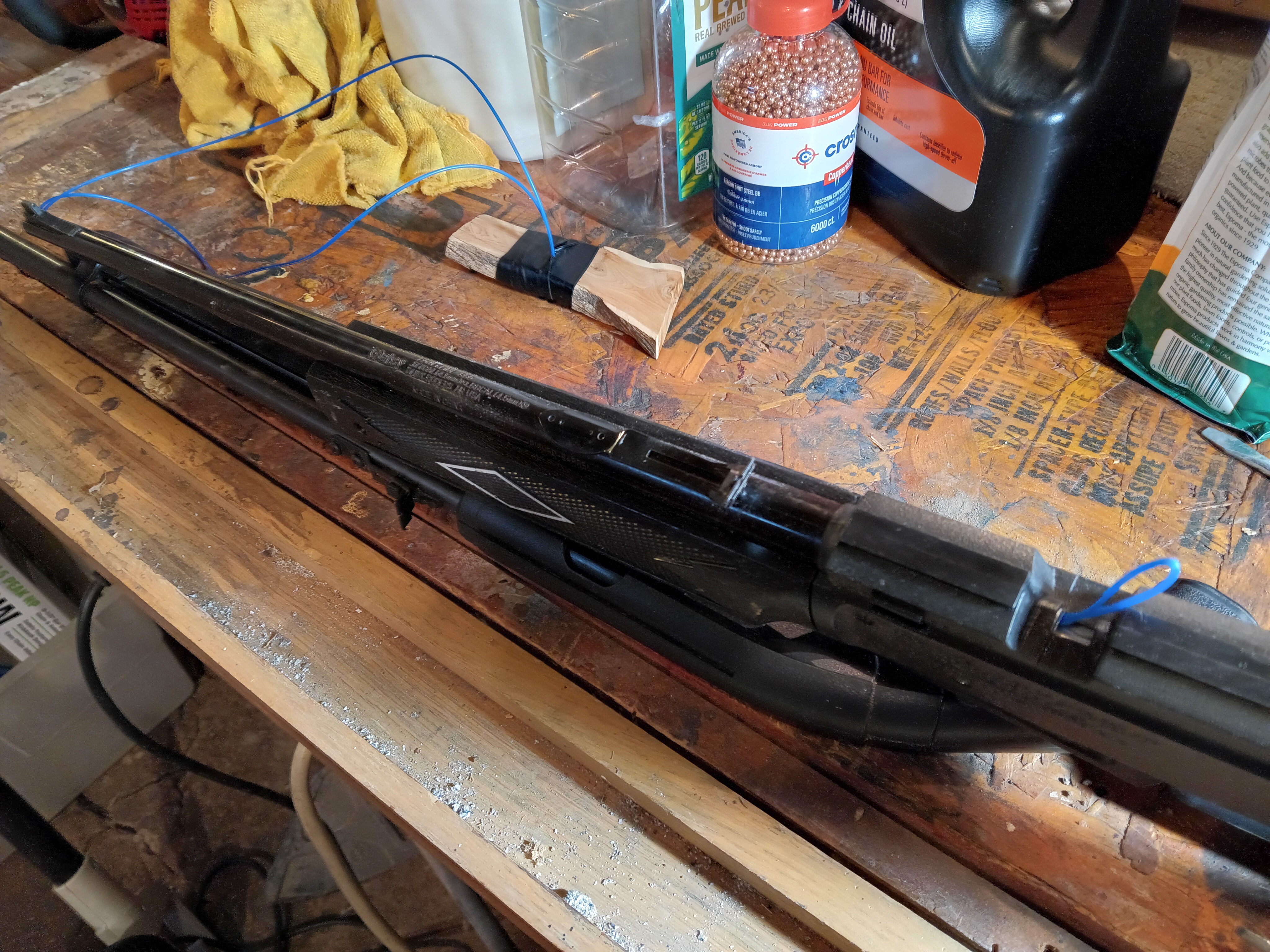

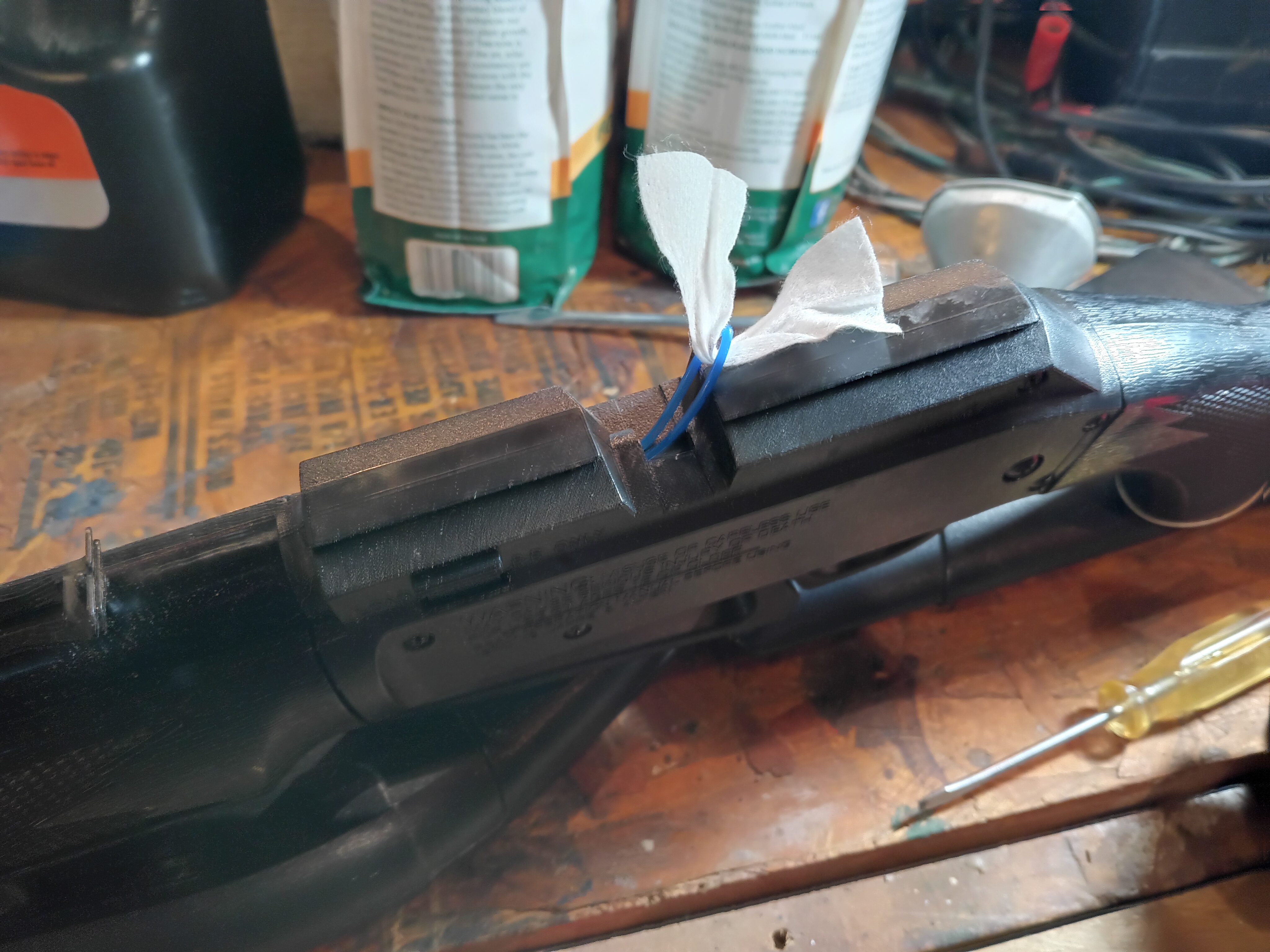

Nice - I made a simple diy cleaning snake for my .177 air rifles. by using 0.065 weedeater line folded in half and push through front of barrel to the small opening of the breach and put the cleaning cloth through the loop with some cleaning solution/oil and pull back through the barrel. easy and cheap.
