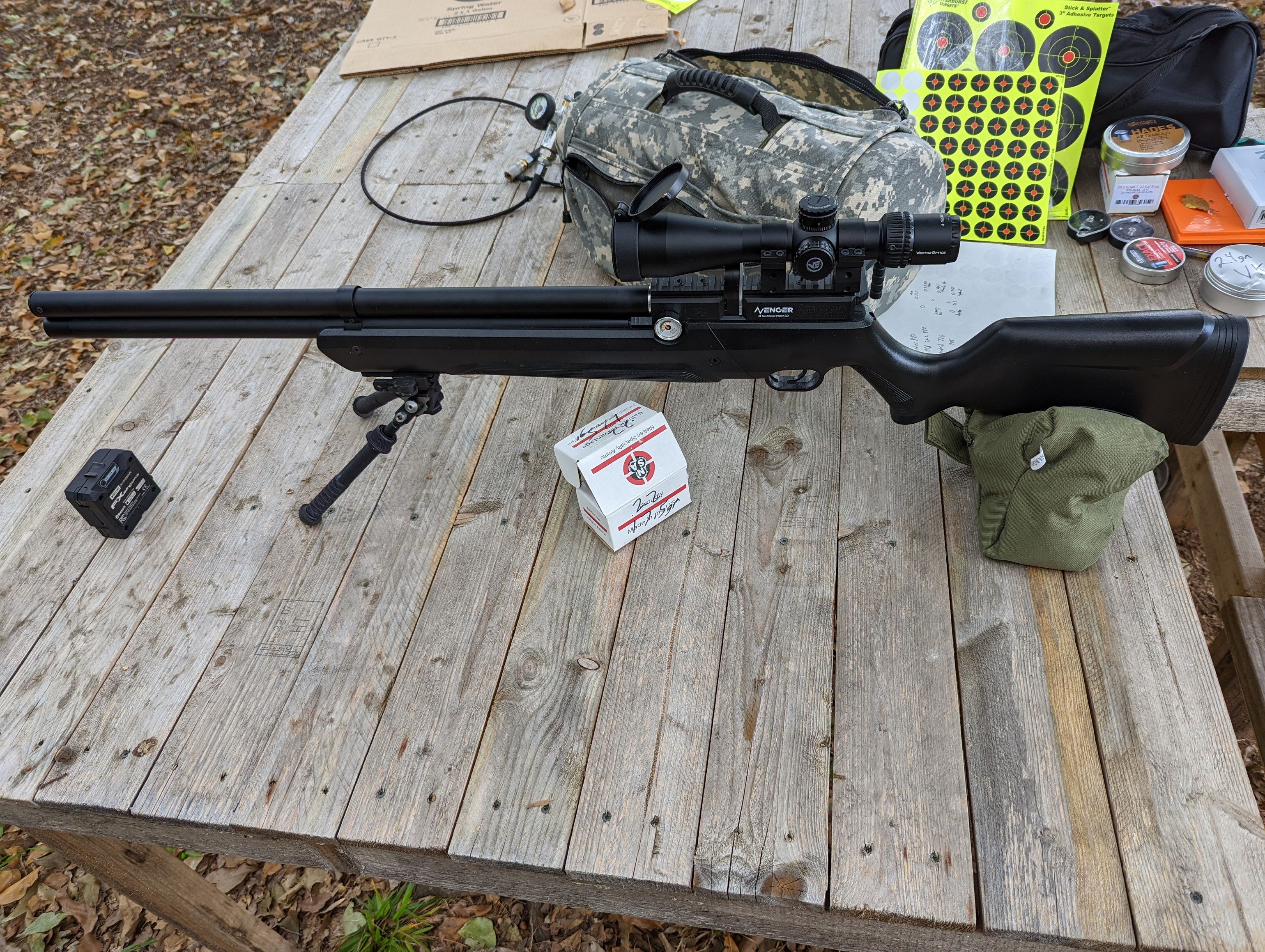

17.5gn nsa slugs @950fps in the first pic.
15.89gn Hades pellets @985fps in the second pic.
51 yards to a 1 inch target. 5 shots each. No change in tune.
First pic was my first group. The scope was centered on target after. .22 Avenger with a 24 inch Troy Hammer barrel. No choke.
