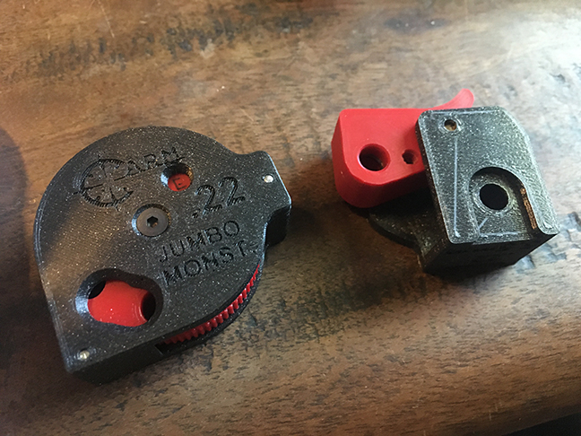

Yes, they are available at https://orioniguanahunter.com/
I just ordered one yesterday as I prefer single loading as well.
CARM has are really nice single shot loader too. I got one for mine and like it a lot better than a tray.
