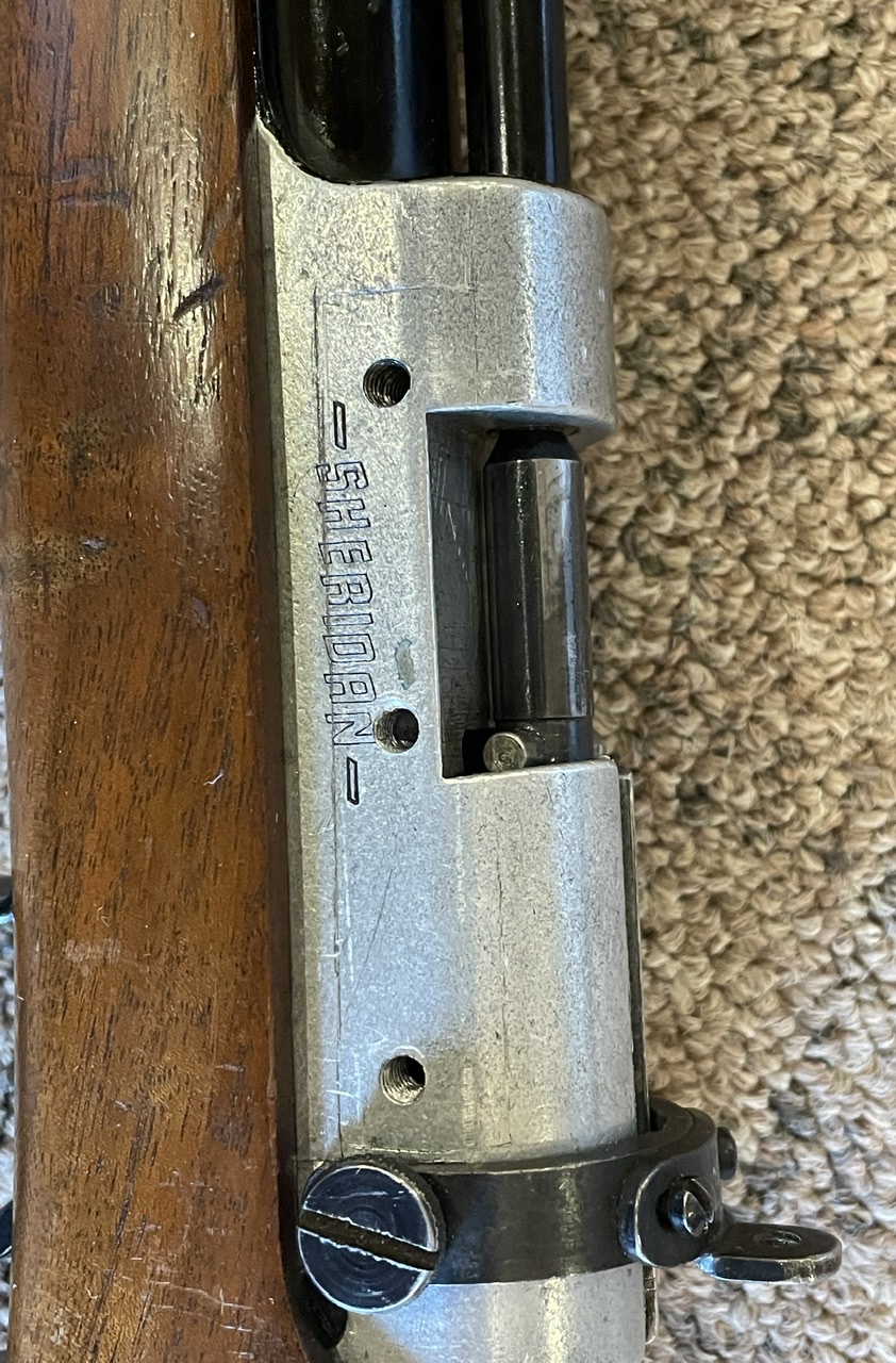

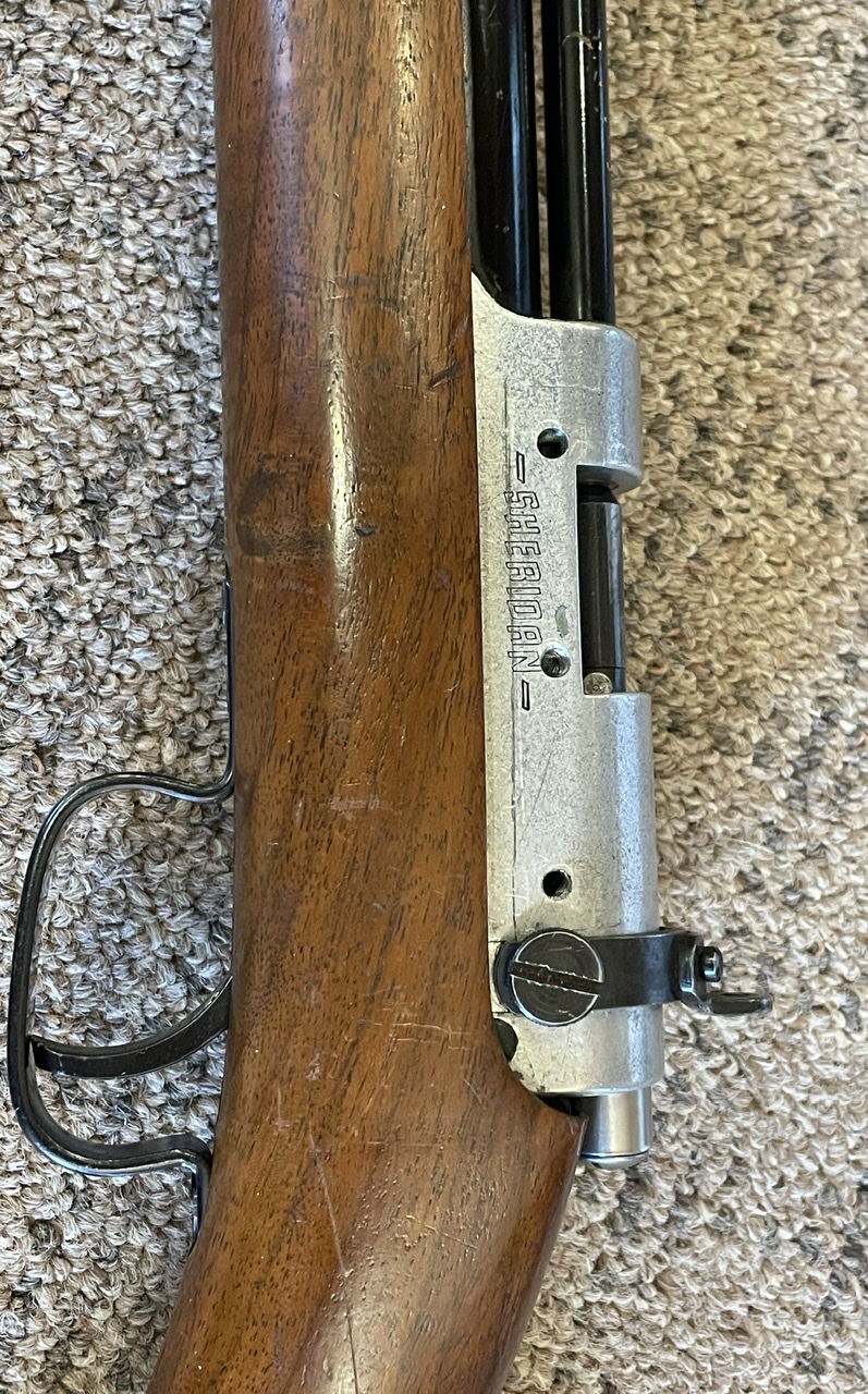

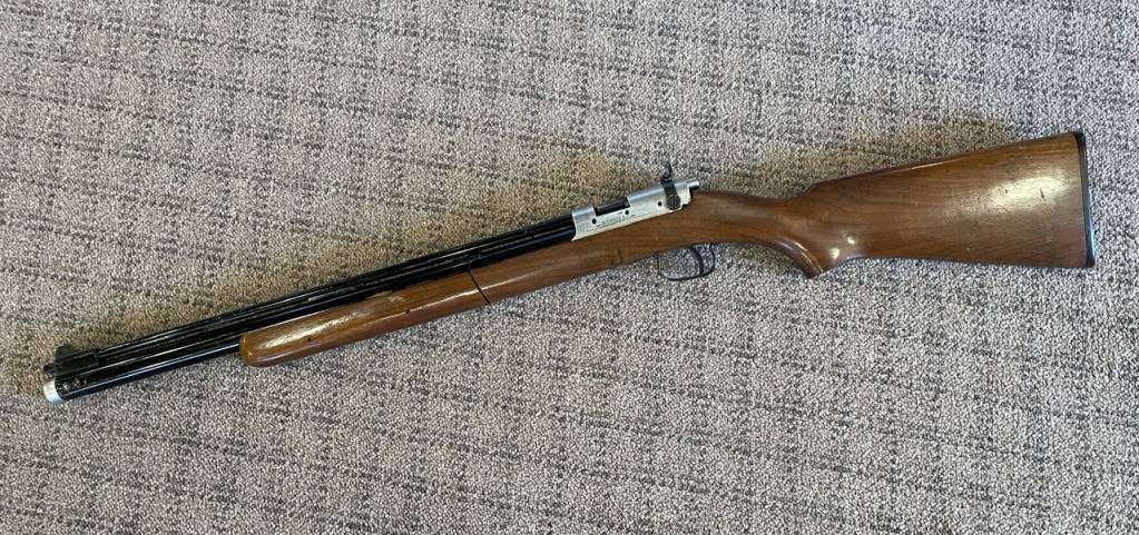

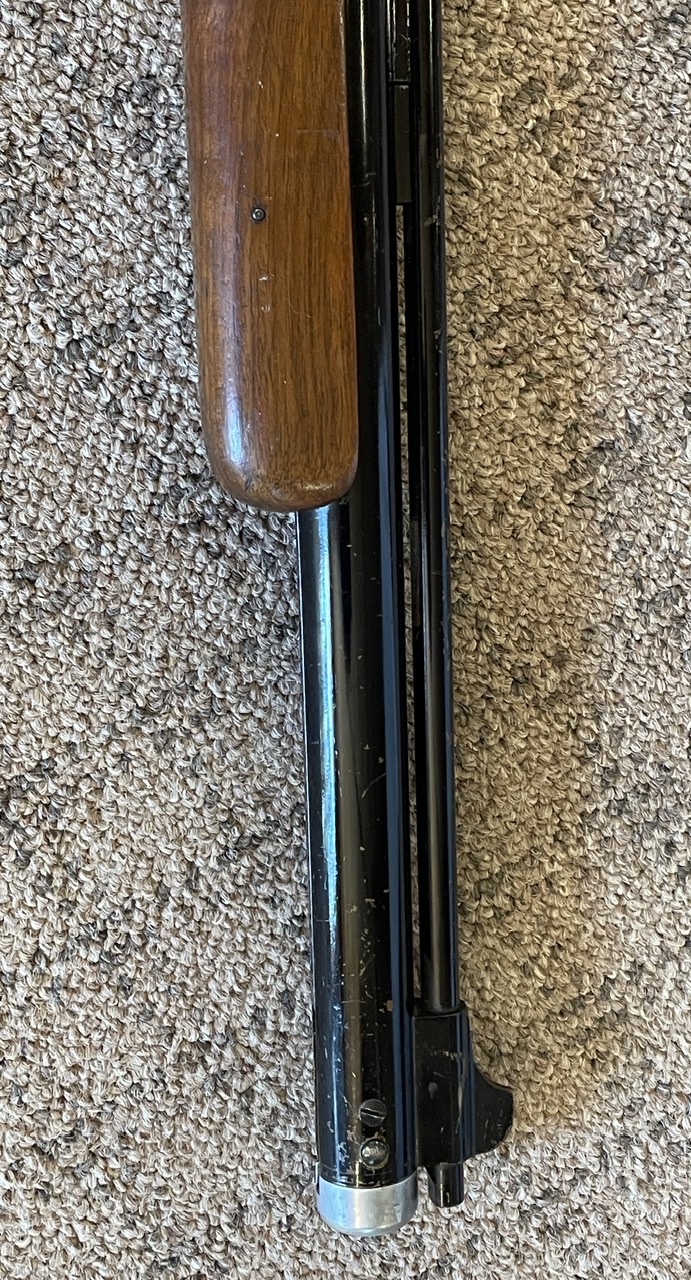

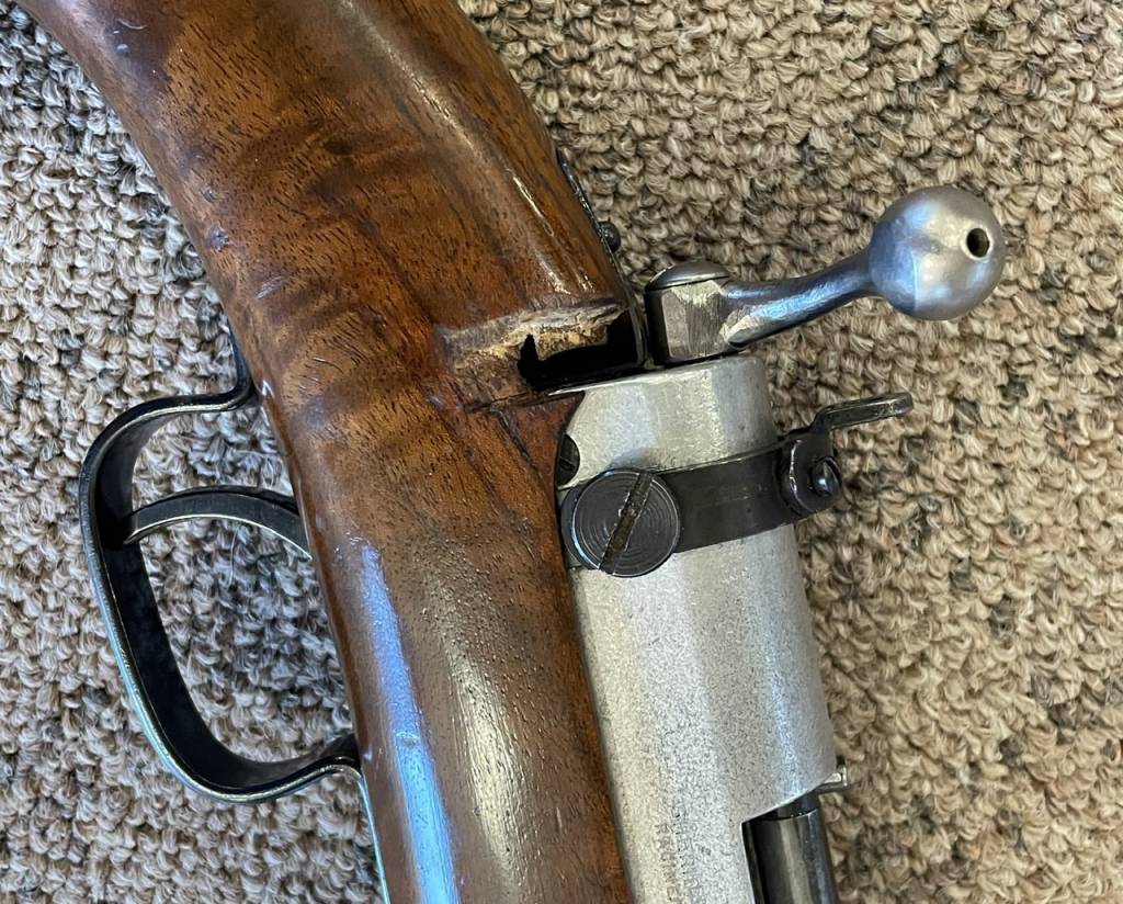

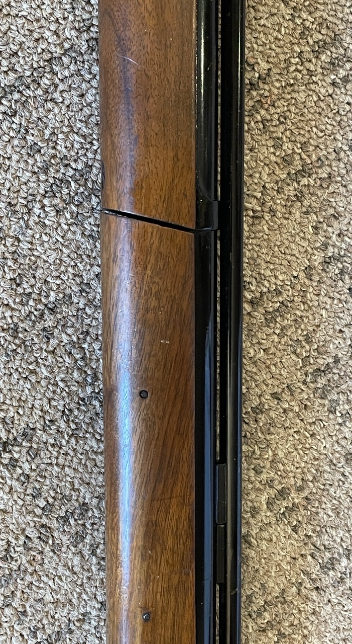

It was not love at first sight. The stock had a hole in it from the bolt crushing it for years. There were three huge holes in the action, from a scope mount that you really couldn’t see in the picture.
And, it did not pump up or hold air. Hmmm.
Butt heck, it’s a Sheridan “B” Sporter…One of about 1000 made. And possibly the most collectible American Airgun.
Here is the story:
I woke up one morning last week and noticed that air guns of Arizona had some old air guns in their used section, obviously a collection they had bought. I always look through something like that to see if there’s anything cool unusual or a Sheridan super grade. There was two, an A, and a B. I can’t remember the last time I have seen a B for sale.
The picture was horrible, it looked like there was some kind of a mount on the side of it. I tried calling airguns of Arizona numerous times, they were flooded. Time is ticking. It had been about an hour since I had first noticed it…I had to buy it sight unseen.
here it is:
mike

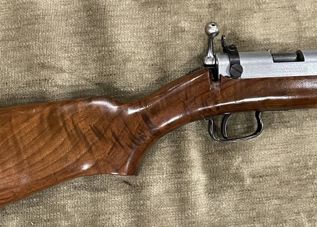

Day 1 it wouldn’t hold air. I got some oil in there soaking those seals a little bit. It really wasn’t creating pressure when I pumped.
Day two, a lot of pumping a lot of oil. It’s starting to create pressure. It will hold air for a while, Huh. Pumped up to eight pumps last night, it still had a little bit of a pop this morning.

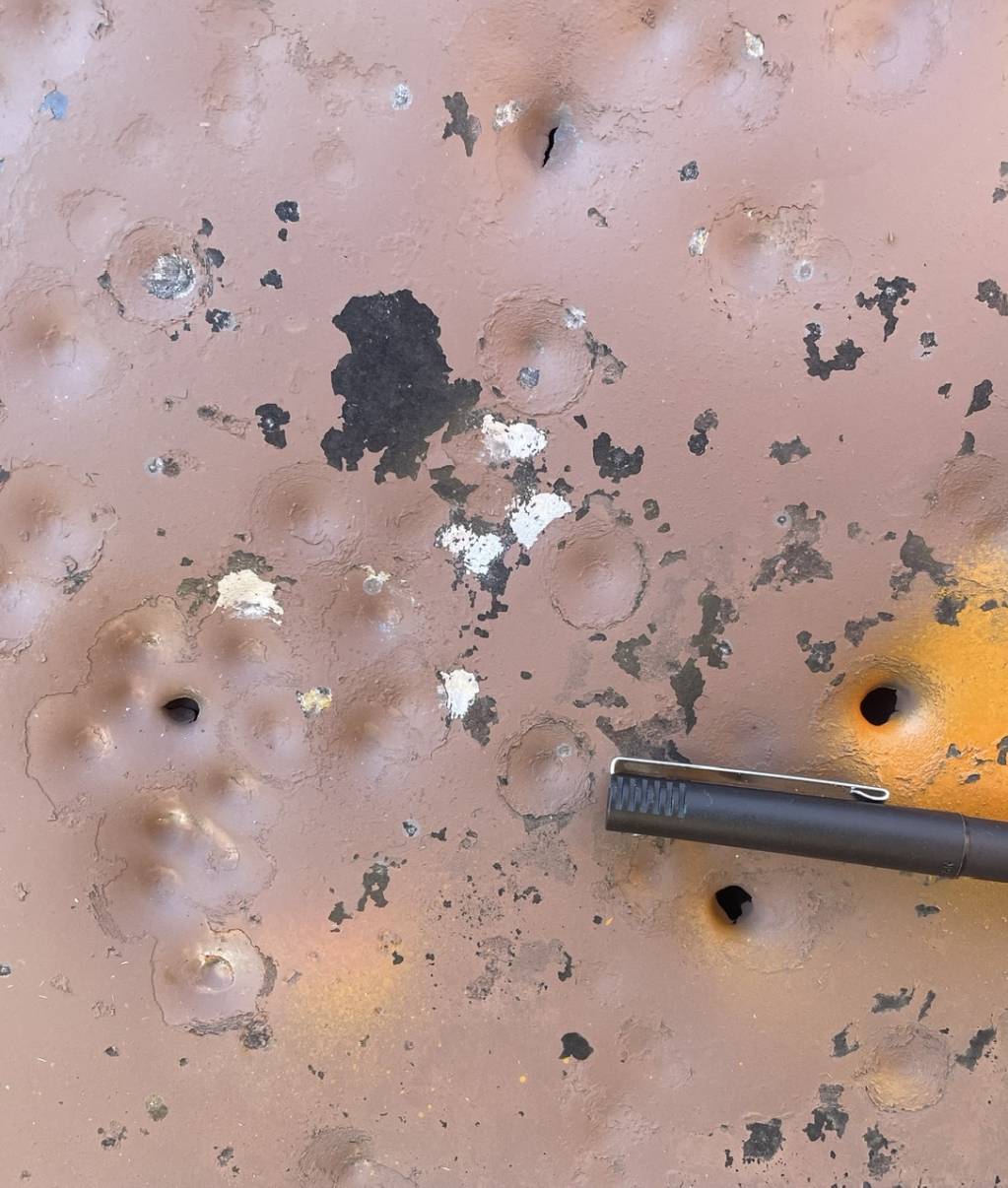

Day 3 a lot of pumping, a lot of oil getting vaporized oil through the system. D3 was today. I shot the group below at 35 yards off hand. It’s not quite as powerful it as it should be. I’m quite pleased it’s a shooter.

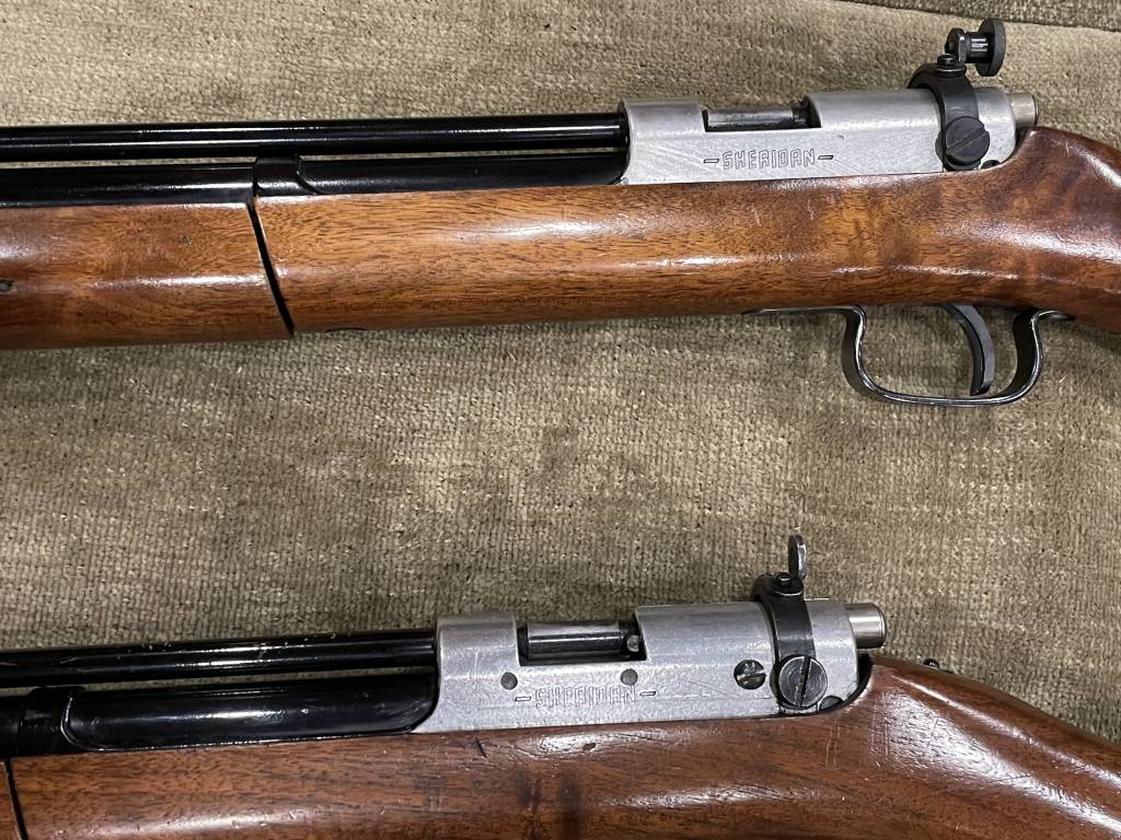

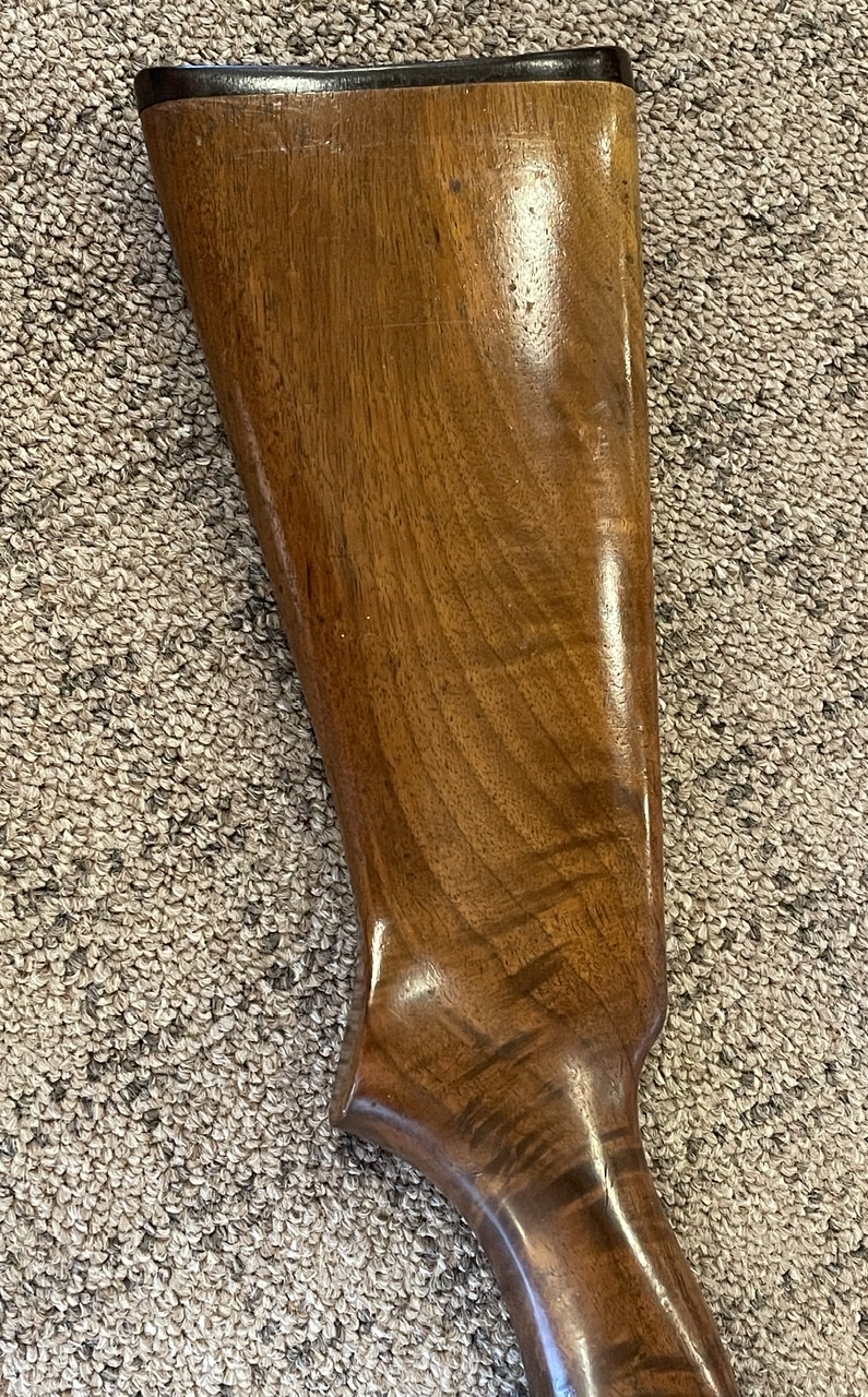

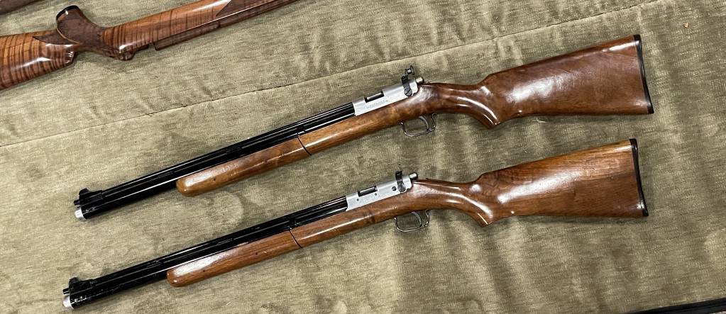

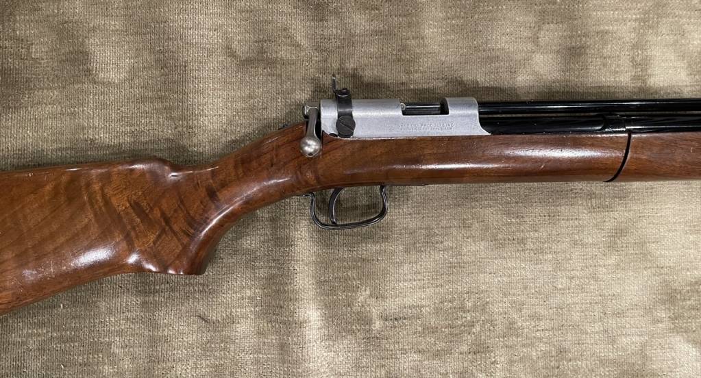

So then I decided to clean it up a little bit.

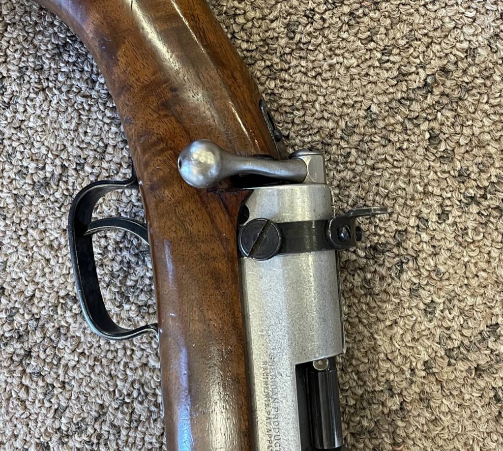

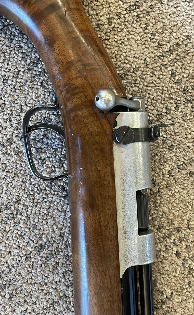

I am quite pleased with the result. It actually has pretty wood.
Yes, I now have two, which makes me a pig.

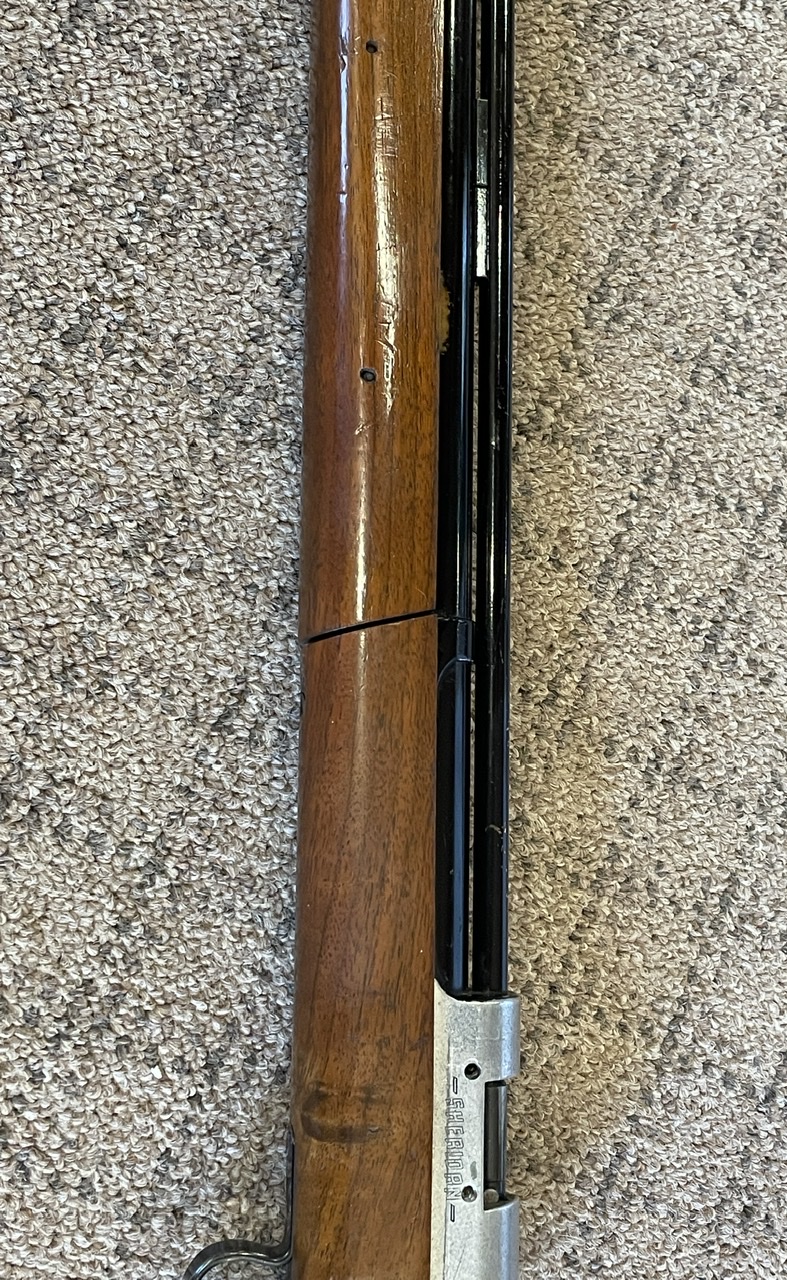

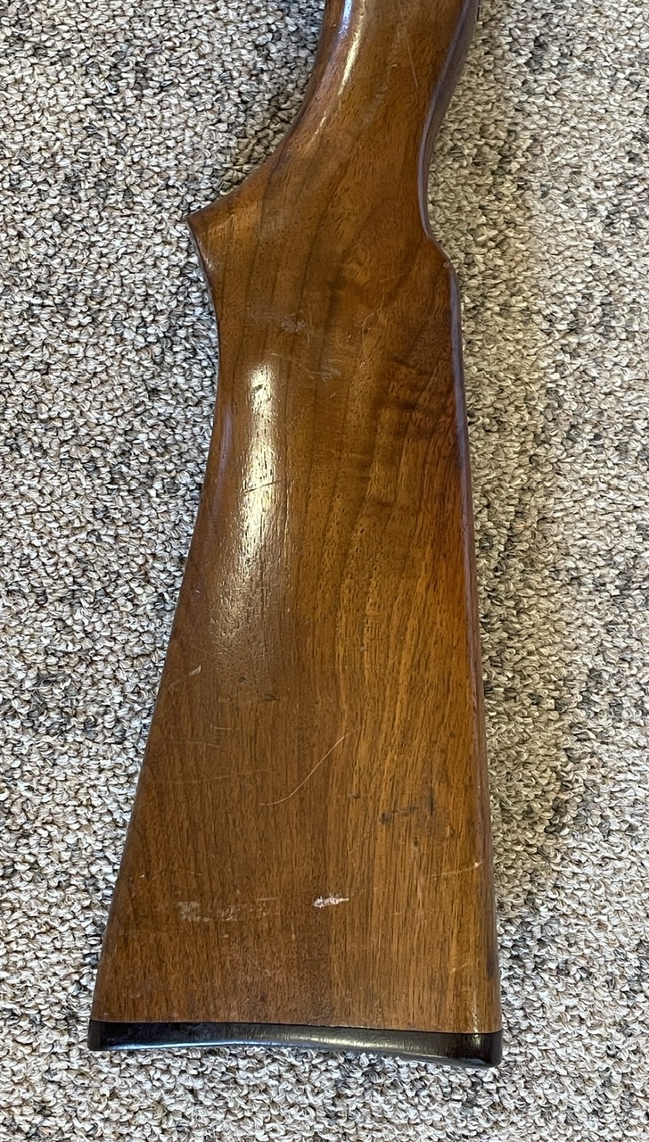

I cleaned up the cut or the hole in the stock a little bit, to make it look more natural. I have been putting hot water in the bumps on the stock all week. I filled the holes in the action with Devcon. That was quite a project. The gentleman, and I use that term lightly, who put the scope mount on, drilled the holes very deep. The threads were really loose because I’m sure it fell off numerous times. So I trimmed off the tip of each of the two screws, and cut a slot in the top so I could screw them in. I coated them with Devcon and set them in about a quarter inch leaving a space at the top where I could apply more Devcon to seal off the hole. I like the way it looks.
I am happy with the entire transaction, it just took a little patience and work. I wouldn’t sell it for $1800 tomorrow.

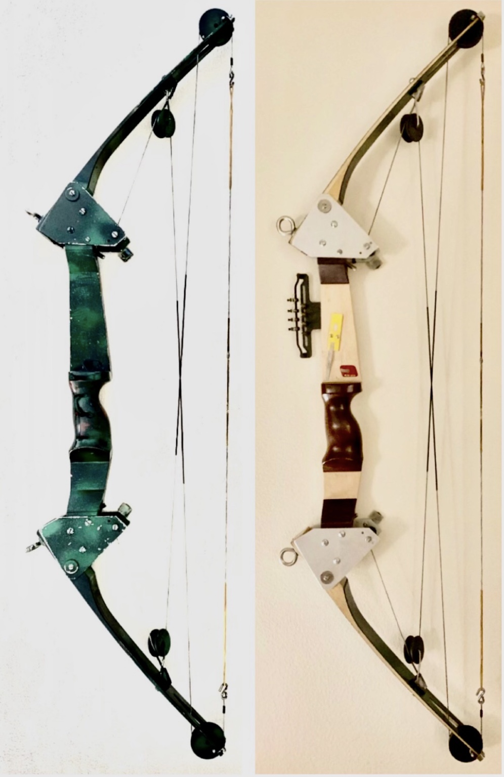

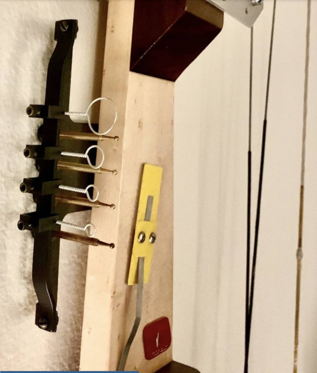

When restoring I try to turn a mess into a feature. Find a vintage mount of that time frame and nicely fit it to those holes with a cool vintage scope. Then it will look different than the other one too. Holes can always be filled but they are still just filled holes.
Case and point. This is a restored 1968 Allen Compound Bow. One of the first ever made. Besides the camo paint someone had added “screwed” a sight to the back side of the receiver. Could have filled the holes but found a vintage sight with a range finder that fit the holes. Makes a better conversation piece this way than explaining the filled holes. For what it’s worth. Very cool gun. Congratulations.

I had a chance to shoot it a bit this afternoon. It doesn’t hold a charge for a long time, not hours. However, it works great for a shooting session.
results below at 35 yards - offhand. 3-shots

I think it’s really cool how you saved that old bow. It just wouldn’t of worked to reuse those mounting holes. They were all loose and bored out, they just needed to be filled and ignored. Plus, I think you will agree, this rifle was never meant for glass - and it already has the factory peep.
