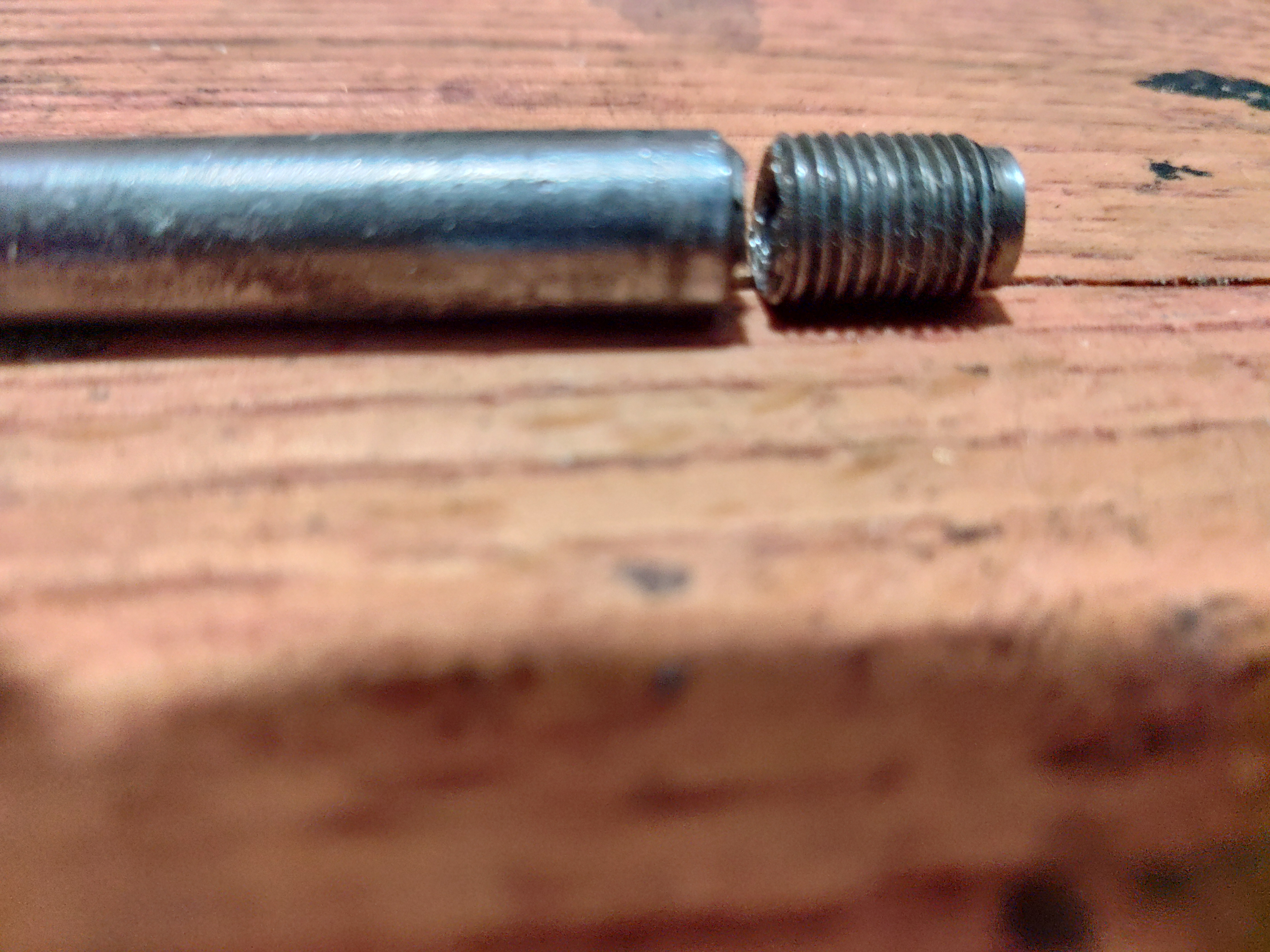

Here is the third stage piston tube where the bang came from. If you ever hear compressed air in your second stage tube while doing maintenance your threads may be compromised.Can you post pictures to document the failure? Just in case Beeman comes here in the future or if there are other failures like it? That is a major safety issue and needs to be addressed.
Glad you weren't hurt. The piece looks like it failed at a valley in the thread right where it joins the unthreaded portion of the cylinder. The lathe may have cut the threads too deep at that point creating a stress concentration point. One possibility. Were there any signs of corrosion or rust inside the pieces where they failed? Water can gather there .Here is the third stage piston tube where the bang came from. If you ever hear compressed air in your second stage tube while doing maintenance your threads may be compromised.

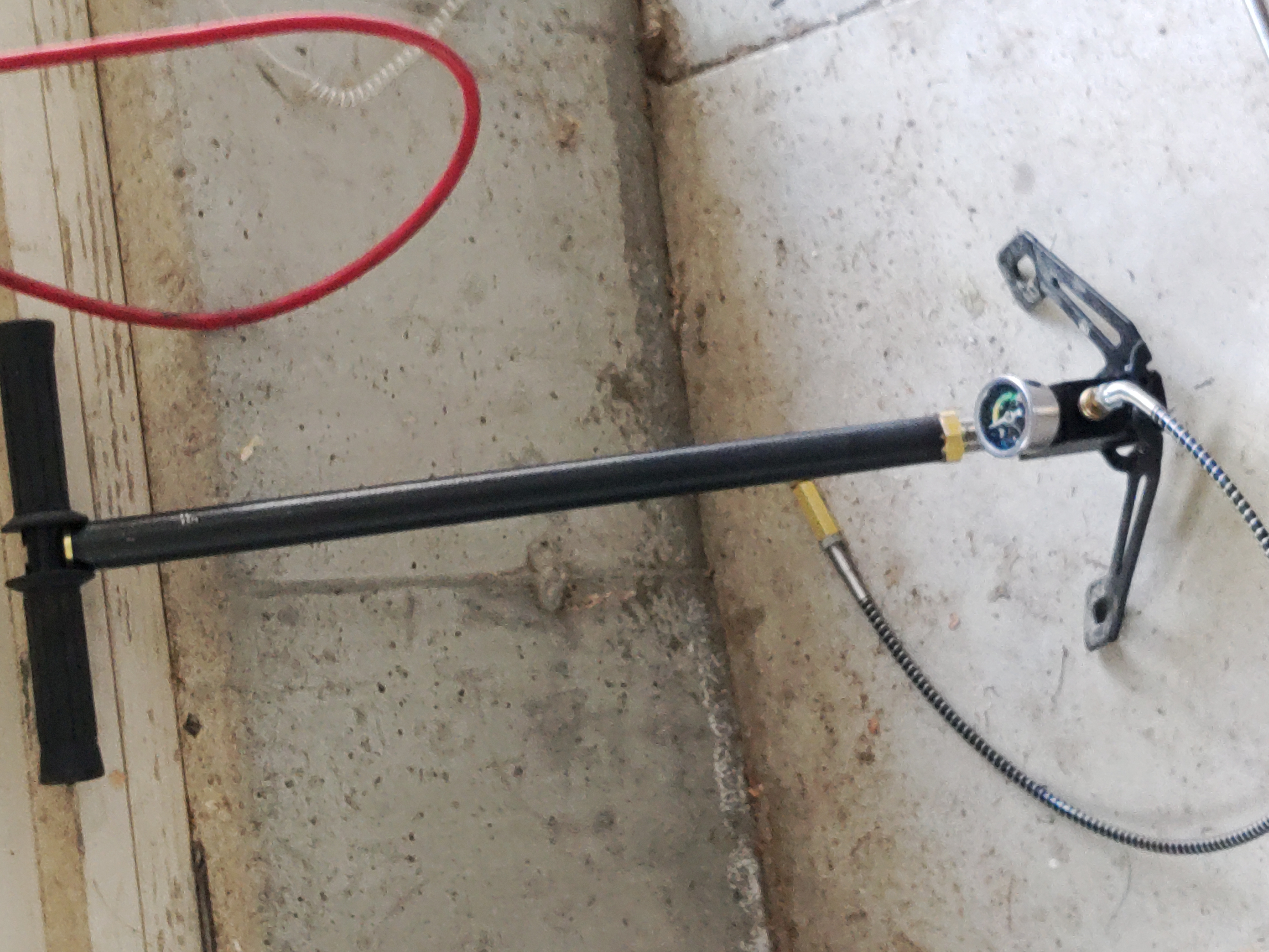

Here's the pump I built out of the blown up one and parts from a junk one. I'm very consistent with maintenance because my first experience with these pumps were not spectacular. The first pump was not finished at all and shredded o-rings daily. I got these from ntk outdoors and they replaced the first one. This time they offered a total refund. I think they were spooked I might sue... All I want is a reliable pump to be able to keep shooting.Glad you weren't hurt. The piece looks like it failed at a valley in the thread right where it joins the unthreaded portion of the cylinder. The lathe may have cut the threads too deep at that point creating a stress concentration point. One possibility. Were there any signs of corrosion or rust inside the pieces where they failed? Water can gather there .
Do you have any photos of the pump itself you could post? Might offer more clues.
OK, good rebuild job. I was curious to see any photos you may have had of the pump after it blew up. Did the hose blow off the thing? Did the HPA charge dump out of the gun?Here's the pump I built out of the blown up one and parts from a junk one. I'm very consistent with maintenance because my first experience with these pumps were not spectacular. The first pump was not finished at all and shredded o-rings daily. I got these from ntk outdoors and they replaced the first one. This time they offered a total refund. I think they were spooked I might sue... All I want is a reliable pump to be able to keep shooting.
