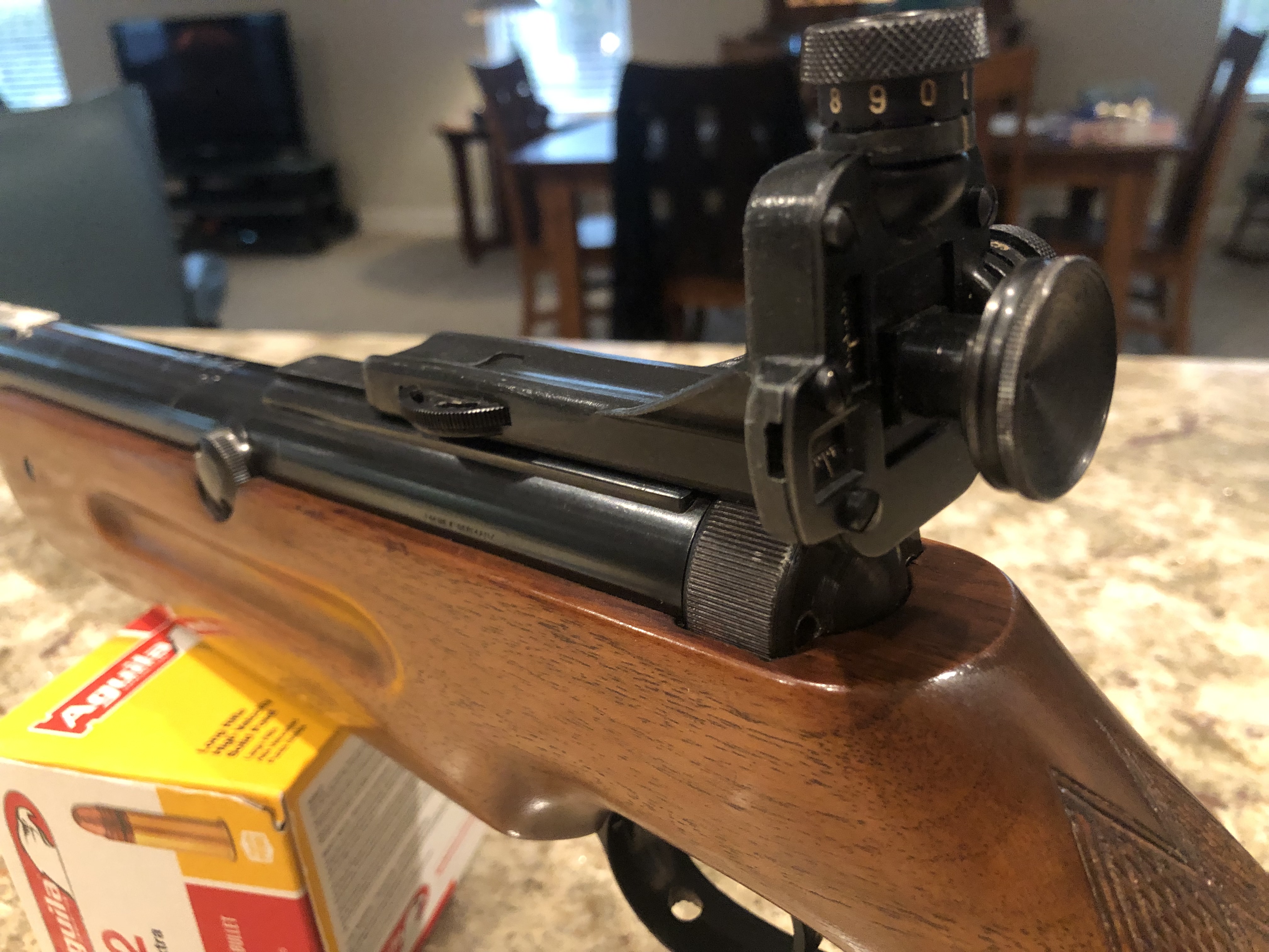

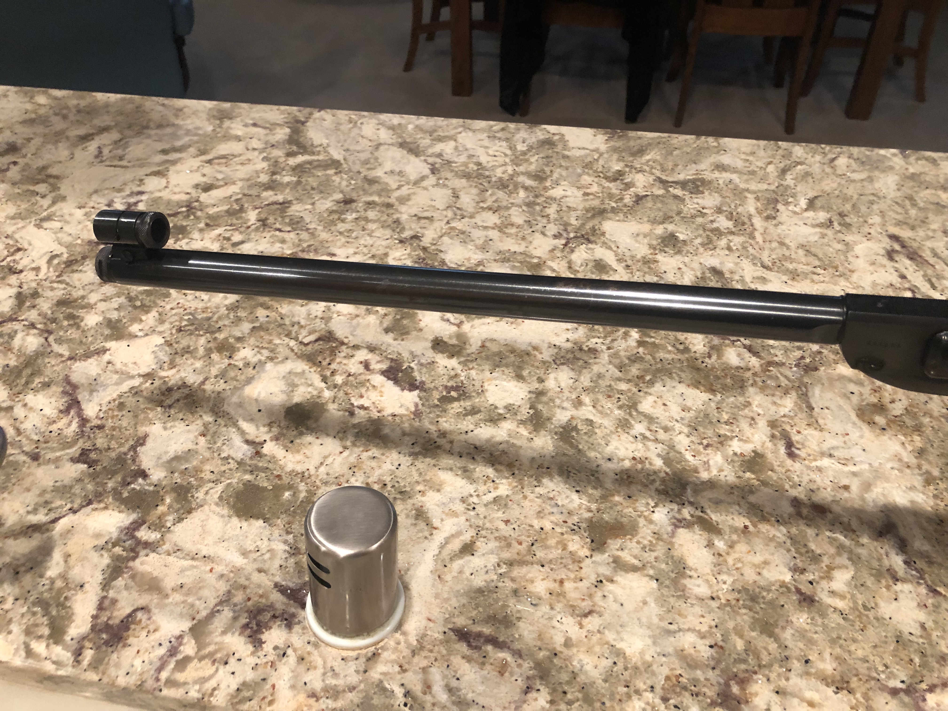

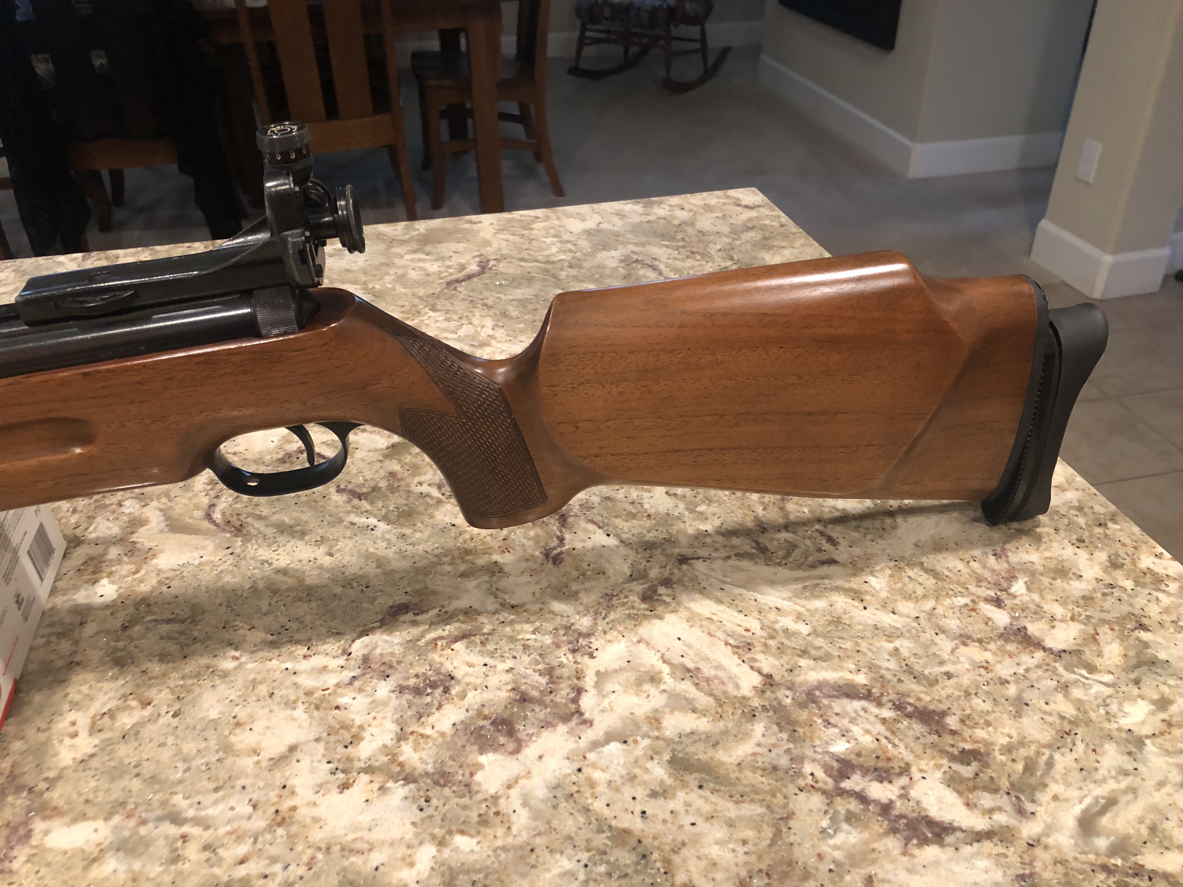

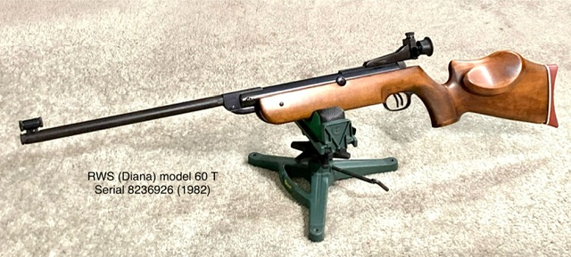

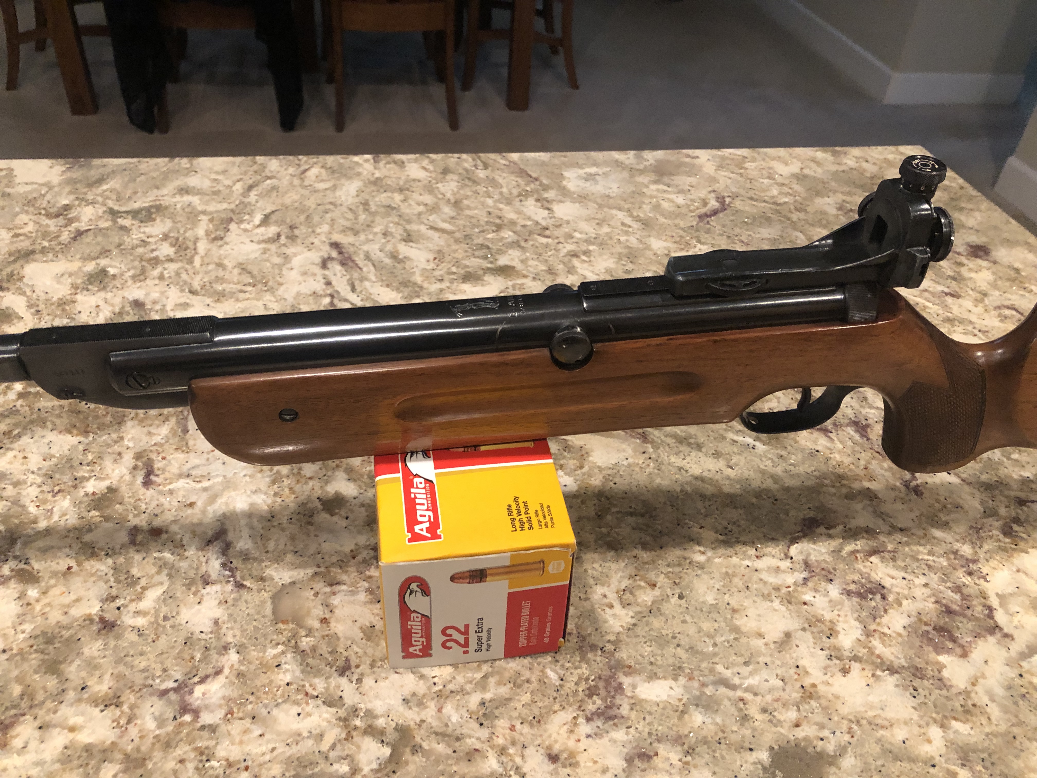

Going off on a tangent here, but if you miss your springers consider a vintage Diana "Giss system" target rifle - recoilless actions with two pistons moving in opposite directions. Models 60, 65, 66 barrel-cockers and 75 sidelever used this action. Complex guns that are hard to rebuild but really special to shoot.
When correctly set up, these guns are absolutely, 100%, totally free of recoil. They just go CHUNK and a hole appears in the target. Beautifully made and finished, spectacularly accurate, and great triggers. My personal fave is the model 60 which is the smallest and lightest, but they are all excellent.
Yep got one!
