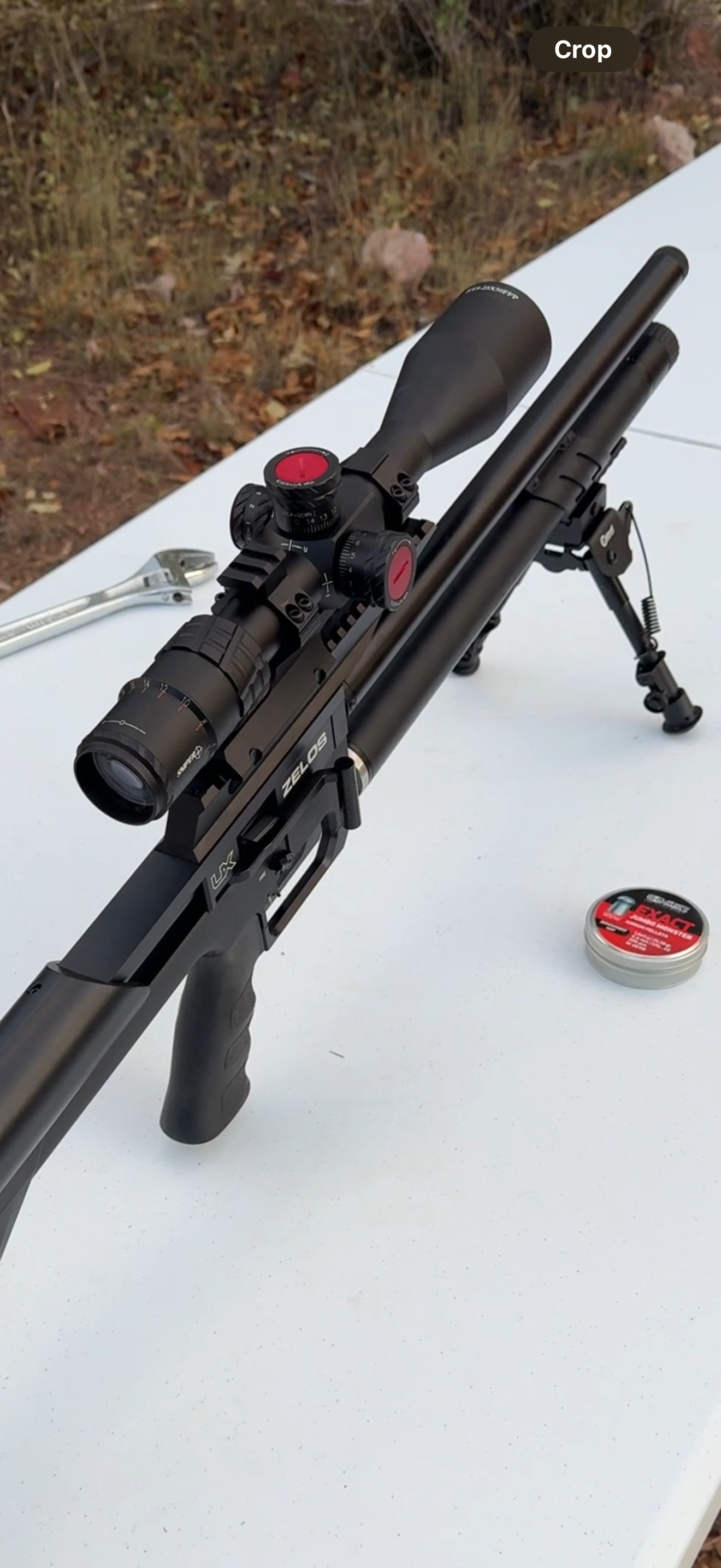

Umarex Purchased a Zelos looking for mods
I have seen the other posts but a bit confused. I would love to find the cheapest most effective mod to quit it down if that’s baffles or any type of moderator and you have a product please post it here. Also mags. I would like to upgrade to a bottle but I’m not going to bother if I can’t find a 4500 regulator/adapter. If I am missing something please let me know. I have been shooting at about 2500 at 905 with 25.39gr and get about exactly a mag worth out and it’s time too fill. It’s worth it for how accurate it is. First PCP gun and Love it! 75yrd on the target smashing the red

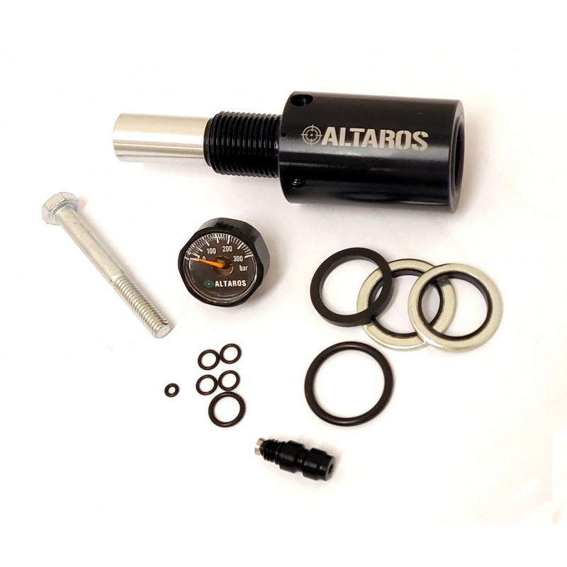

here's a potential mod, that - if it works for me (i am working on it) - might be something for you as well:
