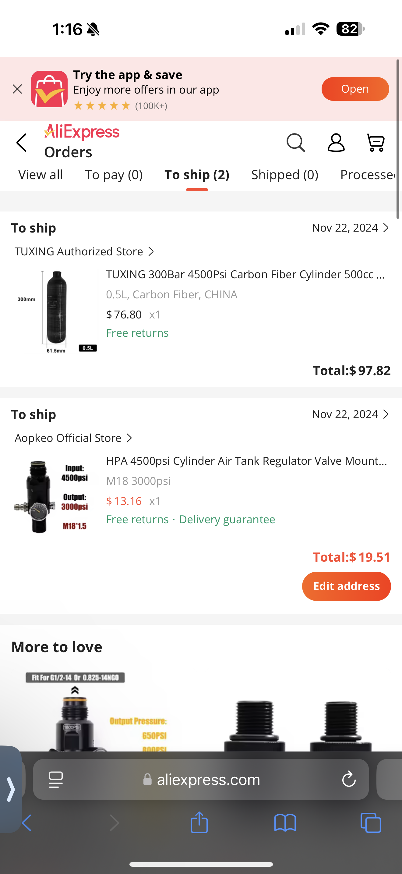

I figured it out the gun is shooting somewhere around 2600psi at the moment and so i noticed a lot of refs only go up to 2200psi and so i just purchased one that will go to 3000

For a lack of confusion this is what I purchased will see if everything comes as it should
Black Friday deals right now on tanks and reg on aliexpress price is only more expensive because i paid the 17$ shipping so that it would be here early December

Your air bottle has an M18x1.5 thread and your regulator has a M18x1.5 input thread and G1/2-14 output thread.
The bottle and regulator can just be attached to each other.
