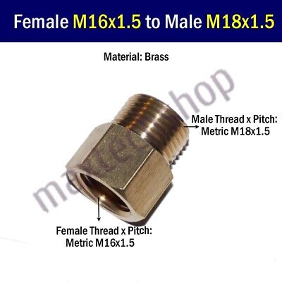

The raw stub comming out of the receiver is M16x1.5.
Are you saying that you need to remove the stub piece and then you get to an M18x1.5 female thread?
No, the raw silver piece has the m16x1.5 male threads. The adapter with the foster and gauge has an m18x1.5 male stubborn for the bottle to mount on.
So that's male m16x1.5 to adapter, m18x1.5 male to bottle.
So we need a M16x1.5 female to M18x1.5 male adapter.
Which is exactly what's on the gun already. To change that section over to a regulator, you'd need a regulator with the m16x1.5 female on the output side, and an m18x1.5 male on the input/bottle side.
I can't find one when I search online.
If we connect the air bottle to the gun and no regulator then there is no fill nipple.
Exactly. So the option as it sits, is to get the adapter or the altaros regulator. The altaros is m18x1.5 female and male, so no need for an adapter between. Then you add a bottle, and it's going to get a little long. Maybe the zelos won't look too bad because it's already 4 inches longer than the m60b, but I personally think it'll look goofy with all those parts between bottle and receiver.
The altaros already has a gauge and fill nipple also. If a short M16x1.5 to m18x1.5 adapter exists, that would be the way to go IMO.
