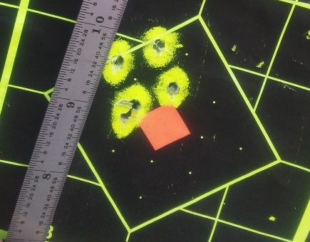

I recently acquired a new to me Royale in .22 and have made a few attempts at 100 yards. Even an almost undetectable breeze will push the pellet an inch or more from the POA.
So Far this is the closest I've gotten.

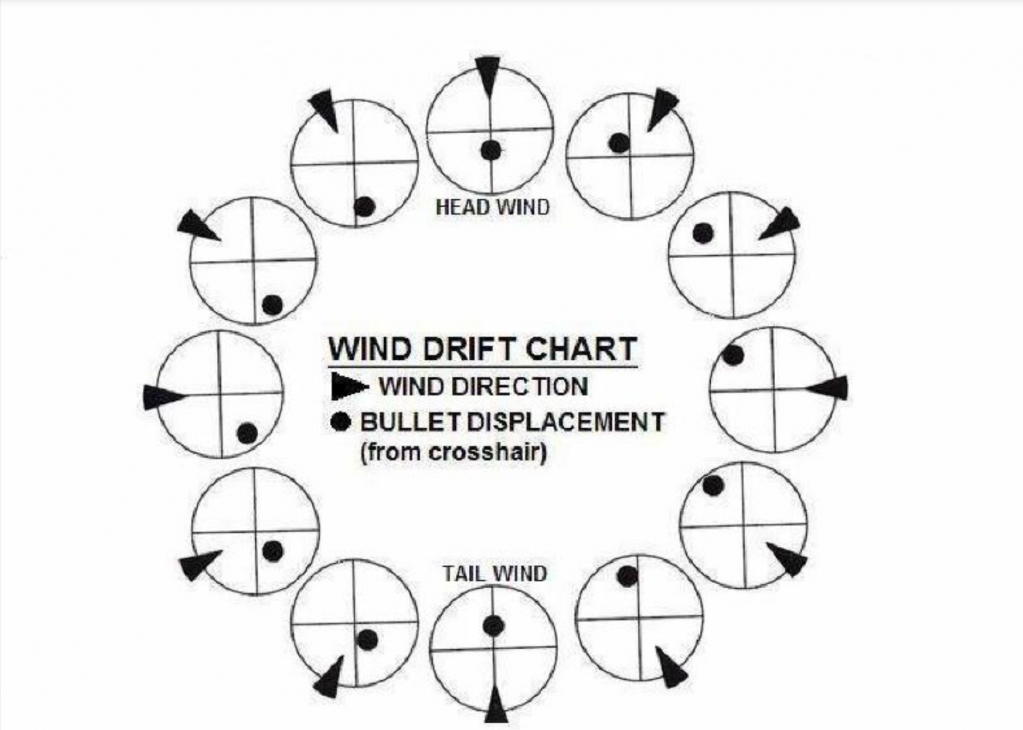

I am still trying to understand how the wind direction would alter the path of the slug/pellet. I found a Wind Drift Chart on line and using this shot that you described where I aim high on the top portion of the tin and the impact was at the bottom. Would that be an " 10 or 11 o'clock" wind? or just a "12 o'clock" head wind? Based on the chart, there wasn't any low left POI with any wind direction which I find strange. Unless I am not reading this chart correctly.
This is for bullets or slugs. Pellets are the opposite...
@Max115 I’ve seen this chart before and I honestly don’t quite understand wind all that well. To me the tell tale here would be how the previous and subsequent shots hit your target under similar conditions. Good thing you have video to review the shots. There should be a noticeable pattern in the way the projectiles are affected by the wind. At least this way of thinking is how I approach reading wind. I’m still learning myself. For me the challenge is in understanding that wind can and does switch directions. It can also blow in different directions at different points in the projectile’s path at longer distances. Keep in mind I’m an amateur here. Some of these bench rest guys can teach both of us some things. And just as I am composing this response @Centercut chimes in. He’s one to listen to for advice in this area.
I can say this. I was out at 55 yards on Saturday shooting 33.95 grain JSB King Heavy .25 diabolo pellets from a Brocock Bantam a sniper HR. I encountered a similar type of diagonal headwind. When it first started my shots started hitting low. The first thing I did was check my manometer to be sure I hadn’t fallen off the reg. When I saw that my reservoir pressure was fine, I shot and hit low again. Then I check the string on the end of my moderator saw it’s direction then used my kestrel to gather info on wind speed at the muzzle. It read 3.5-5 mph gusts. I then held over 0.5 MOA and that brought up my POI to an acceptable point. Remember that this is a diagonal headwind. I was shooting west to east and the wind was blowing southeast to northwest. My pellet wasn’t affected too bad on the horizontal axis. When winds got up around 6 mph they felt stronger on my body so I tried to hold right (south) slightly and three shots landed to the right. I’m pretty confident that wasn’t on me because I tend to pull the gun left causing a POI shift to the left. What I concluded was that I was overcompensating for the wind and I stopped holding for windage. Then my shots consistently hit closer to my POA. I was shooting from a standing position behind a tripod with a ball head that I keep loose in order to pan freely.
