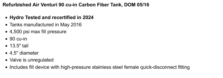

Pyramid Refurbished Air Tank.
Then what? Tinker with it? And then be told that I voided the warranty it came with? Thanks, but no thanks.

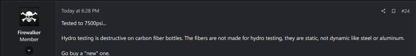

Tested to 7500psi...
Hydro testing is destructive on carbon fiber bottles. The fibers are not made for hydro testing, they are static, not dynamic like steel or aluminum.
Go buy a "new" one
This is very false, because its a carbon fiber wrapped tank with aluminum shell, and they 100% are required to be tested every 5 years.

I think that the 2007 white paper you posted is woefully out of date and even though you got the 5 year retest date right, you are wrong that it has to be hydro tested. Hydro testing is destructive to CF bottles, they have a 15 year life due to the TESTING performed. Ultrasonic testing is a safe alternative and is non-destructive on CF bottles.
It is also incorrect that you have to have your bottles tested every 5 years as a matter of law or enforcement, the DOT code does not apply to those not in commerce.
The USN challenged the DOT for extensions and the industry for a change in testing methods and in 2012, the final rule was released.

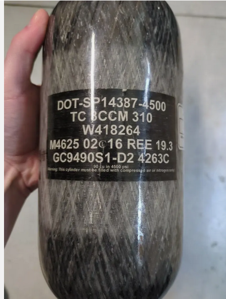

You can literally see the sticker from hydro testing on it here..
