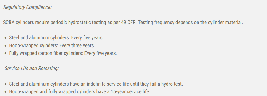

Hydro testing is being done on CF bottles, it is destructive, that's already been explained and proper documentation provided.
Why is it done still? Because it's cheap and they can.
For those that are following this trainwreck, be advised that the data in the shared link is the current reasoning behind CF bottle testing and the "new" 30 year lifespans on properly marked CF bottles.
Hydro testing limits CF bottle lifespans to 15 years due to the nature of the test. This will not affect your bottles 15 year life nor the subsequent 2 tests that will have to be performed on your bottles if you wish to stay current with testing.

Federal regulations. Title 49 CFR general requirements and recertification
