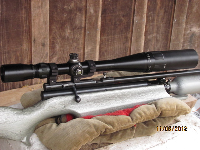

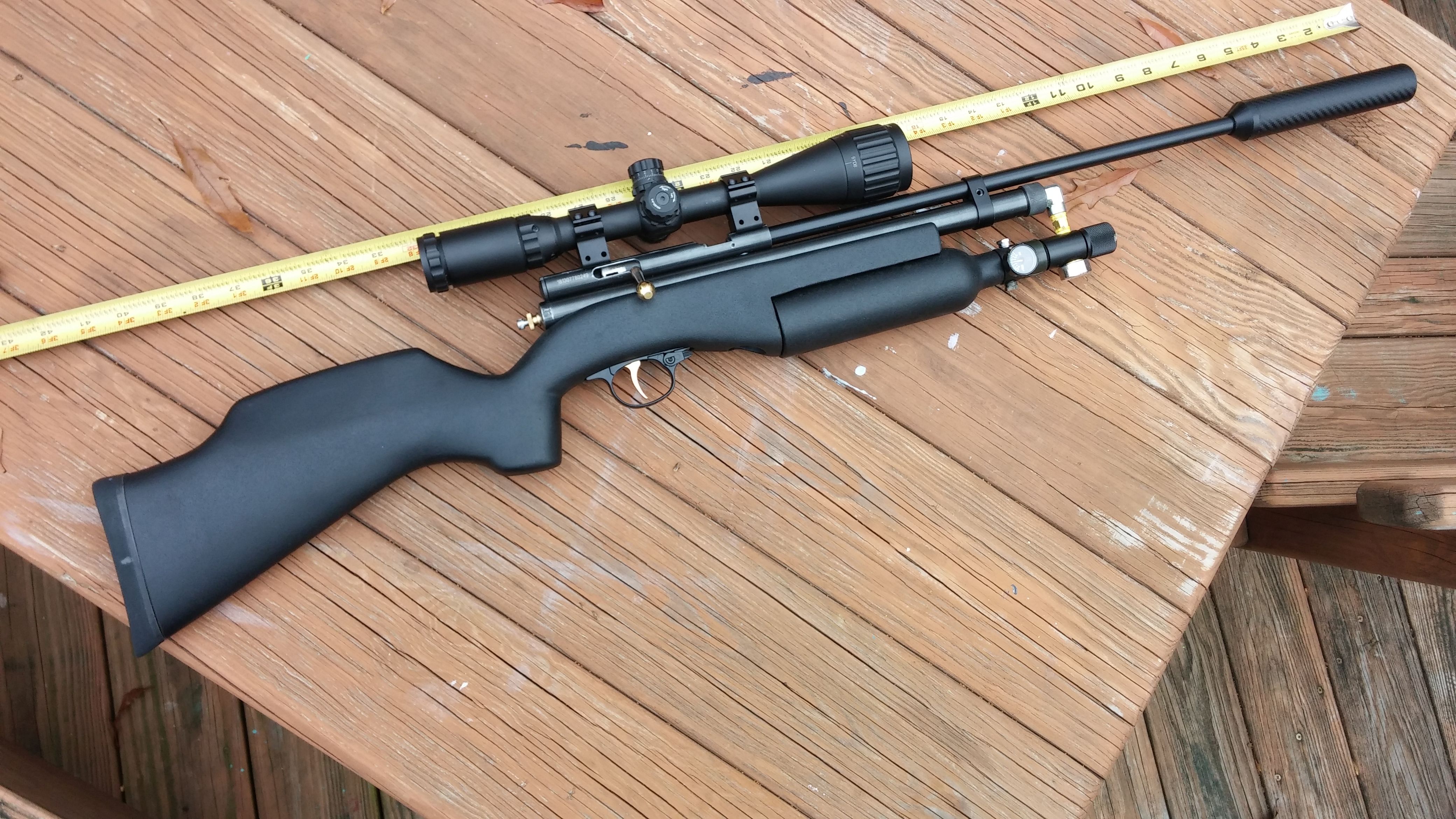

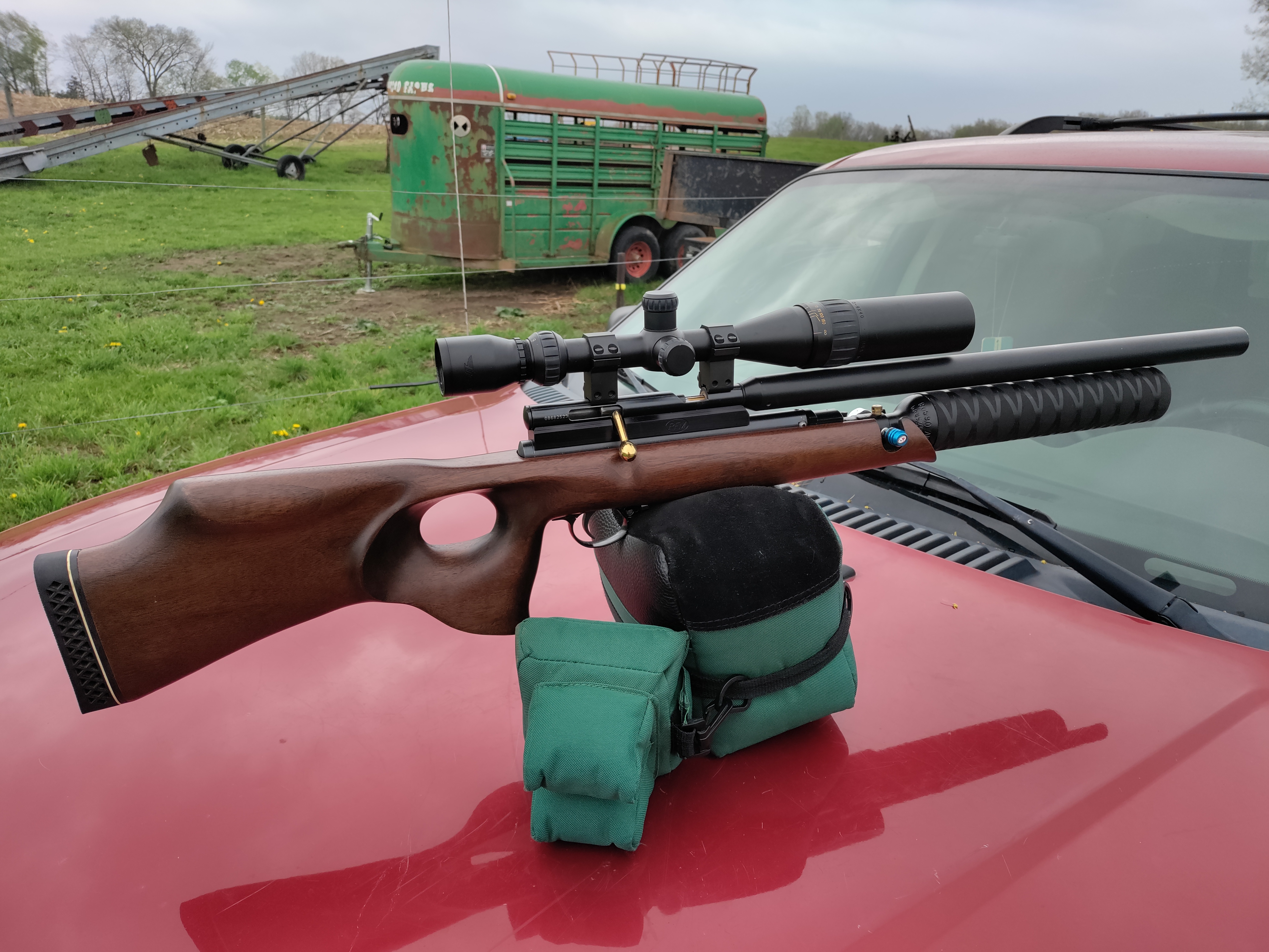

Yes. You would need the drop down adapter, cut threads off tube, drill holes for retention screws for the drop block.
QB78 converted
And a Ninja regulated bottle or such.
Common and likely searchable on this forum mod for the 22xx crosmans.
John
The trick may be getting your hands on a tank block. Archer Airguns doesn't seem to have it listed any more, and the Umarex Gauntlet tank block is both better designed (safety) and cheaper by far but has been unavailable as a spare part for probably 2 years now.
I've done quite a few so if you have any questions, ask away.

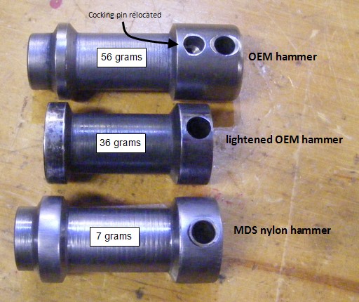

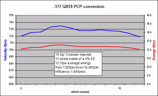

I set up a .177 on air using a lightweight hammer (MDS nylon) and upgraded poppet to help eliminate hammer bounce and get the dwell down. It gets good efficiency as a result, and manages 13 shots at 12fpe inside a 4% extreme spread. Plenty for a gray squirrel hunt or a pest control session, but not so great for casual target shooting and plinking.
The heavy OEM hammer and poppet do not fare as well.
