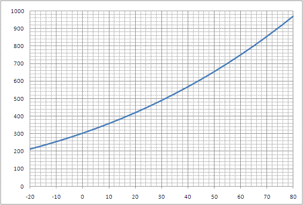

Sorry forty degrees didn't work. Try to get it as cold as you can. Here's a chart on co2 pressures at different temperatures.
I've found that when using only one cartridge, it's best to insert two full ones with both of them pointing to the rear. That way the second cartridge isn't pierced and its full volume is taken up in the plenum. One cartridge used that way gives me forty useable shots instead of about twenty with an open empty.

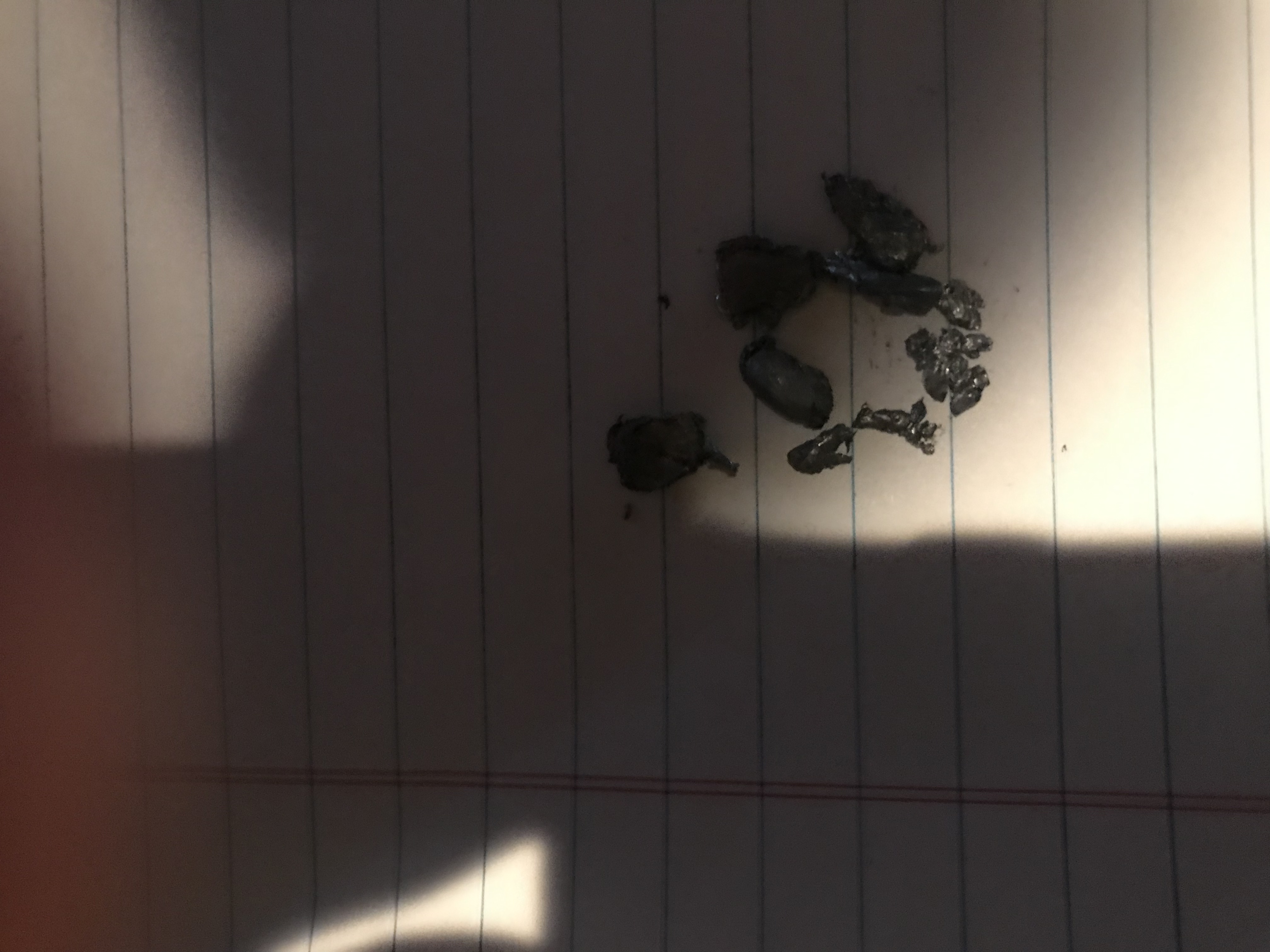

That looks to be fragments of a pellet or two. Glad you got it sorted out.

what's really strange I've been shoot several differ models based on the QB78 rifles on and off for over 20 some years and 7 now and never had a similar problem with any of those. Is it possible that the factory tested the gun and let some pellets drop in to works during testing, It was probably me that caused it ,however I don't see how it's possible. Since I only shot it a few times I don't hardly see how I could lost that much lead in the action. The only pellet That didnt' exit the barrel and I removed it with a cleaning rod. Charles

I wouldn't be at all surprised if it came that way from the factory. The last few of the series that I've dealt with (ie - straightened out) have not had a tight screw on them. Not to mention the sharp edges and tranfer-port burrs. Then there's the crushed and much restricted transfer port seal. The .22 that I have became a project when all of the above was noted. It wasn't achieving the advertised velocity, either. The originals that Tim had imported were made to a much higher standard. My goal has been to bring it up to that standard.
I'm glad to see that you've got yours working again. Have you cleaned the barrel, yet? They're usually filthy when new and have to be thoroughly cleaned.

Yes the first thing I did was to clean the barrel. And was it every so dirty. However the outside of the gun was very clean of oil or grease. Most of my similar QB were dirty all over. Charles
