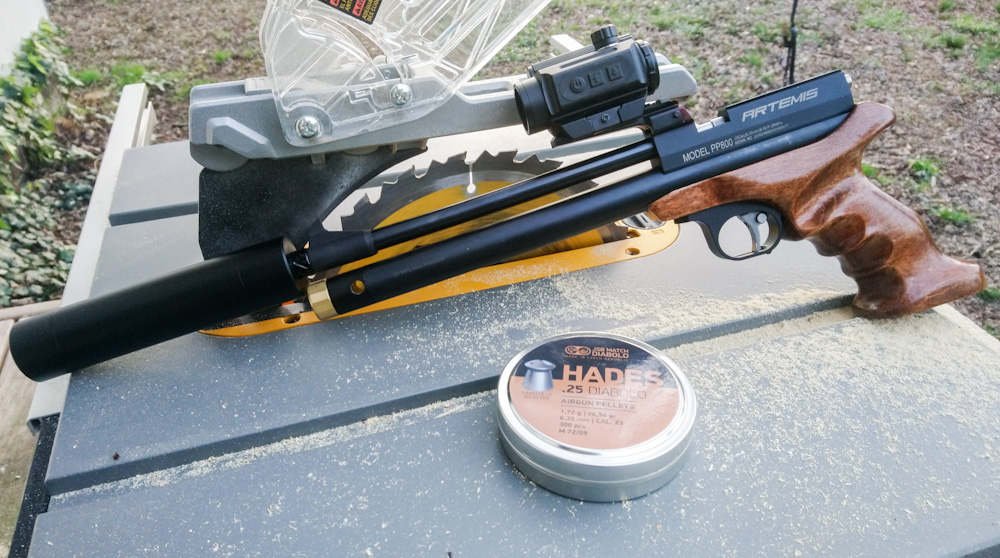

So I got hooked on the PP700 in pistol form, I even shocked myself by sniping a sparrow from 15 yards away with a pistol scope Freehand. However as much as I love that PP700 I really don’t like the grip and the nose heavy balance. So I’m looking at PP800 and 1701p and wondering if anyone that have both to compare them as to which one is better being a pistol. Other suggestions are welcome also but I must have silencer to make it ultra quiet, don’t need more than 650fps in 177 because it’s going to be 15 yards and under.

just found this picture and helped address the balance issue, 1701 is a lot shorter so it shouldn’t be as nose heavy.
as far as cost goes with the AGN discount there won’t be much of a price difference but have to wait like for years. Good thing I’m not in a hurry really. Think I’ll order a huggett atom moderator and a Donnyfl adapter for it while I wait.

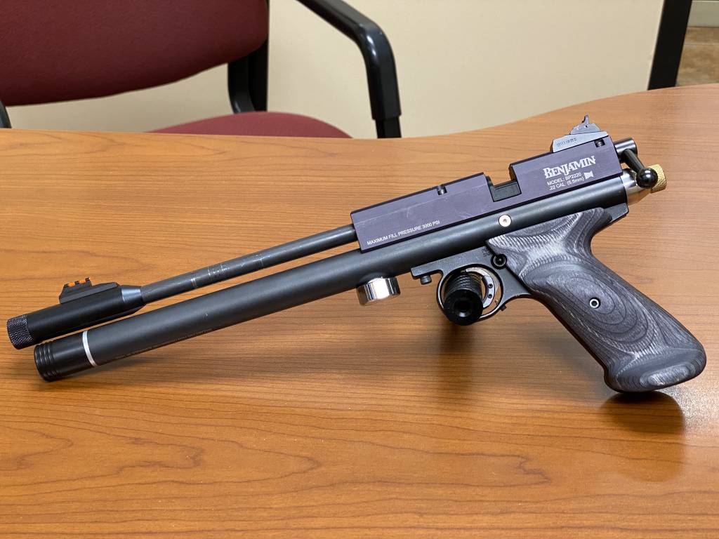

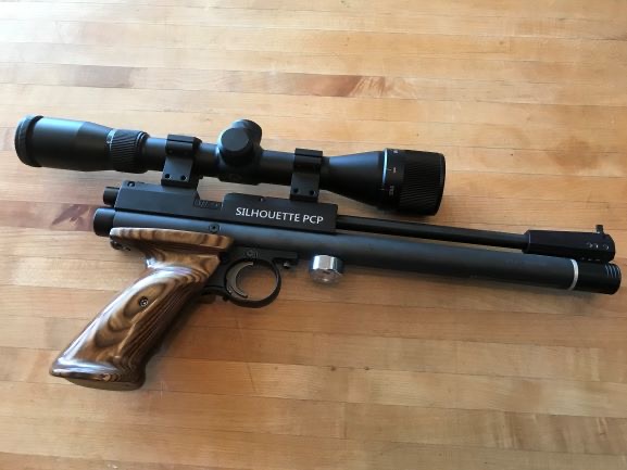

The pp800 is a great budget pistol. However the overall fit and finish is not as good as the 1701. The wood or synthetic grips are nowhere as comfortable as the 1701. And the trigger on the 1701 is far superior. Accuracy on my 177 and 25 pp800s is stellar, so no issues there. But the valving and tune on the pp800 is not as good as the 1701 either. (less consistent power delivery)
Here's one of mine with modified and now comfortable grip, lol.

That's a sweet looking rig! Love the grips

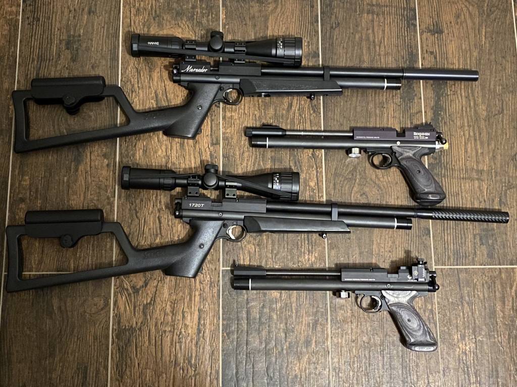

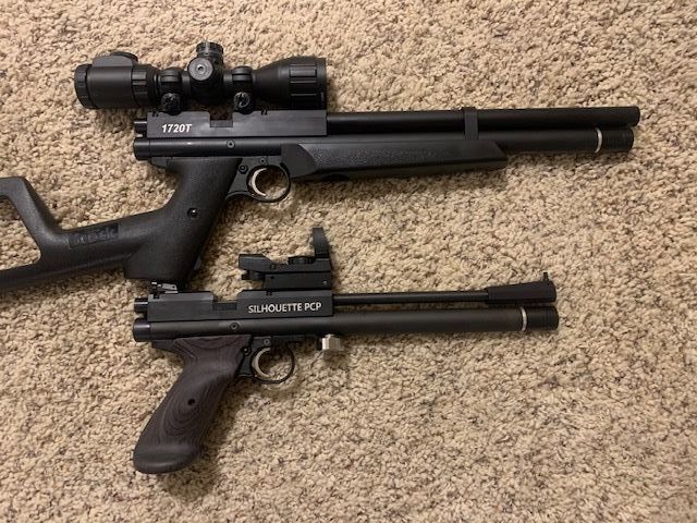

I like my 1701Ps a lot better than my 1720Ts due to better balance and lighter weight.
I have a Lothar Walter barreled PP700 and it's the most accurate one I have but still prefer the 1701Ps.

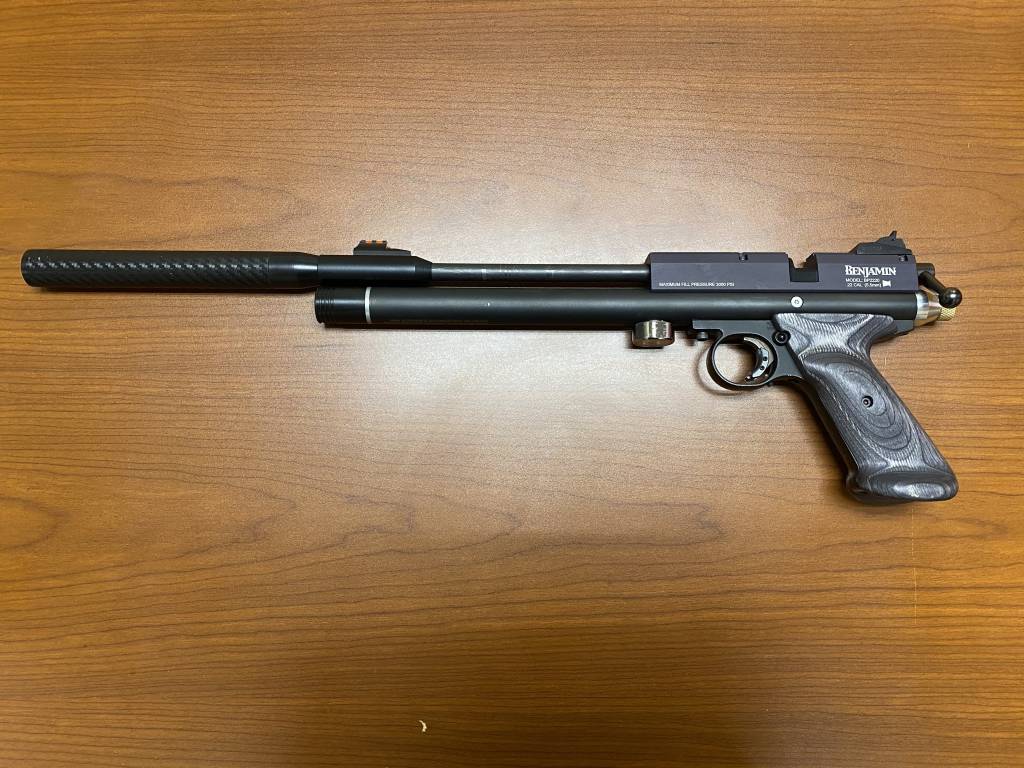

The Prod breech will fit on a 1701P tube however. Has a SST installed in the picture but typically shoot with a magazine. The Williams WGRS 54 rear sight is tall enough to see over the magazine. Replace the peep sight with a notched blade. DonnyFL Benjamin adaptor and a threaded TKO keeps it backyard quiet and neighborhood friendly. Does 15-16 fpe for 16 shots. TKO is small enough in diameter to to block the iron sights which is my preferred way to shoot pistols.
the Prod and 1720T are pistols in name only IMO and I only shot them as carbines. I built the what I call the BP2202P to complement my Prod. I love the Crosman/Benjamin platform for its interchangeability.
