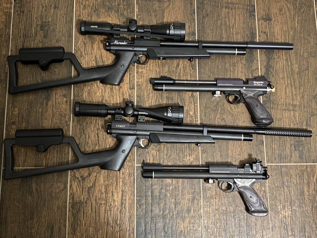

The Fortitude breech does not match the 1701P or 1720T air tubes due to different bolt locations.
The Prod breech will fit on a 1701P tube however. Has a SST installed in the picture but typically shoot with a magazine. The Williams WGRS 54 rear sight is tall enough to see over the magazine. Replace the peep sight with a notched blade. DonnyFL Benjamin adaptor and a threaded TKO keeps it backyard quiet and neighborhood friendly. Does 15-16 fpe for 16 shots. TKO is small enough in diameter to to block the iron sights which is my preferred way to shoot pistols.
the Prod and 1720T are pistols in name only IMO and I only shot them as carbines. I built the what I call the BP2202P to complement my Prod. I love the Crosman/Benjamin platform for its interchangeability.
There's roughly 2 inch difference between the P Rod vs 1701P barrel length (12" vs 10.1"). How can yours (P Rod barreled upper) be the same (without the barrel sticking out by the difference in their barrel length) with the 1701P air tube fill dust cap?
I know the 1701P barrel is shorter than the air tube filler cap but not by almost 2 inches barrel difference.

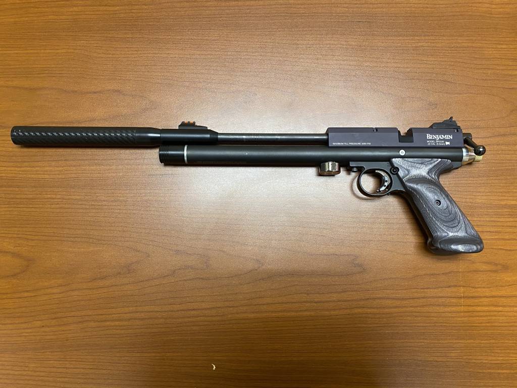

I bought a used Prod to start with and bought a 1701P tube from Crosman. I should have had Mountain Air Custom Airguns cut my Prod barrel and redo the breech. Roy said he would do the barrel mods for $80 plus shipping costs to ship it back to me, but I cheaped out and I cut the Prod barrel myself and recrowned it DYI with a brass screw. So as a result I looped off the choke. It still shoots just fine with JSB pellets but if I were to did it again I would have had the barrel redone from the breech end to retain the choke. Originally I tried to emulate Fuzzygrub's pistol and retain the shroud so it looked like this but I was having issues with it. I cut the Prod shroud and re-tapped it myself and I cut the front of the AS down to keep the shroud centered with the barrel. The shroud does ntohing but provide a place to mount the ramp sight. I was using a Prod DonnyFl adaptor. It shot just fine with out the TKO that way but it is very loud with out it. However with the TKO it shot to the left about 1.5" at just 10 feet!😲 Got real frustrated with it and could never figure it out what was causing this. So I decided I'd cut my losses and removed the shroud altogether and tried the Benjamin adaptor and it works great with or without the TKO now. It looked cooler with the shroud IMO but something was wrong with the shroud setup. oh well.

MHA sir, so does the 1701P tube need to have 1701P internals too, particularly the valve?
IIRIC, the PROD/1720T valve is different from that of the 1701P and not interchangeable, but I might be in error though.

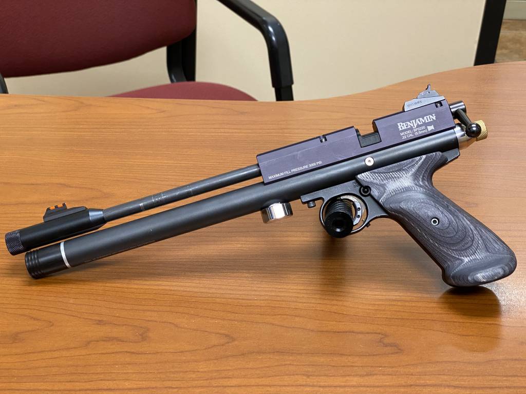

I would roll that CF shroud on a smooth surface to see if its perfect and even if it is or not I would index it 180 degrees see if you still hitting left and if so then index the inner end air stripper 180 degrees too and see what happens. Might be baffle clippage too. Could possibly be the barrel band too try removing it.

Oh, so they do have the same internals!
I was quite surprised when I checked this morning and found out that they have the very same valve--same part number(s).

Sorry got swamped at work. Yes all the Prod internals are the same and drop right in the 1701P tube no problem. It’s a fun pistol. It does get loud though. Keep us up to date on your build.

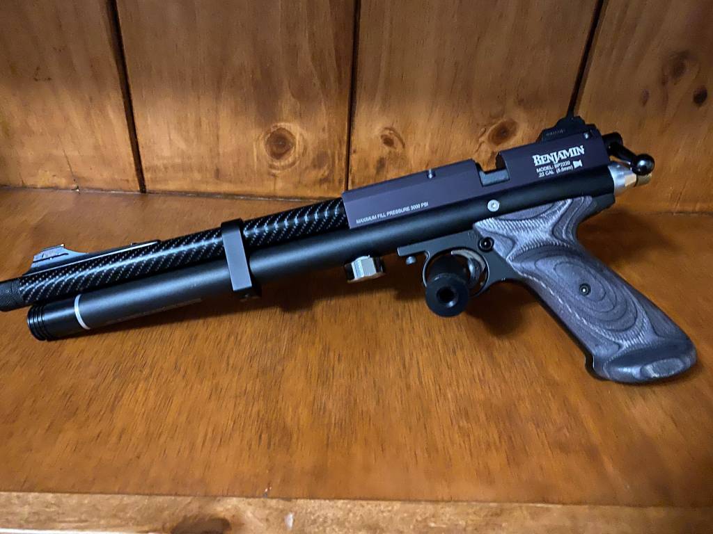

Yeah I tried several of those ideas. The shroud is actually the original aluminum Prod shroud that I cut to length and I re-tapped it on the muzzle end with a vinyl wrap giving it the CF look. With or without barrel band made no discernible difference. I did roll the shroud and barrel on a flat surface. They are both straight. indexing the shroud wasn’t an option because I already had the front sight mounted before discovering the problem.
I do think it’s a combination of the modified air stripper, and possibly the threads I tapped in the shroud and the DonnyFL Prod adaptor actually. I think I might have gone just a little too deep with my threads in the shroud and the oring on the AS were right at the end of the threads. Could be that my threads aren’t quite square with the shroud so the adaptor wasn’t square. I don’t know. I don’t have a lathe and never used one before. I used a tap to thread the shroud so it’s likely I didn’t get this 100% right. Whatever it is it just didn’t work.
I just got too frustrated with it to order new parts to retry it again. Really didn’t want to invest all that much more into it either and possibly screw up on the retry either. Eliminating the shroud and using the DonnyFL Benjamin adaptor was just way simpler, probably cheaper in the end and was far less time consuming and frustrating when it was all said and done. I like my pistol. It’s not as accurate as my 1701P but it wasn’t meant to be. 🙂

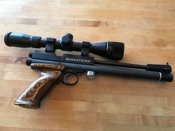

question: I have a cheap 2-7x handgun scope from amazon and it works good enough at 15 yards. Any good budget handgun or long eye relief scope I should try?

put on my cheap scope and zeroed her in and zero issue with single hole at 15 yards which about as effective as the little scope is on a house sparrow. Chrono it and with 7.9 grain CPHP pellets I got 450fps which is actually a little faster than expected. If I can squeeze out 100fps more then I might now do any other upgrades to it. So far really liking the balance and the weight even with a scope. Even with out moderator it’s almost backyard friendly so with a little Atom it probably will be mouse fart quiet.
